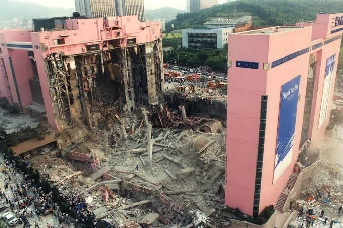

Did you hear about the Korean department store owner who removed the columns because they were blocking retail floor space?

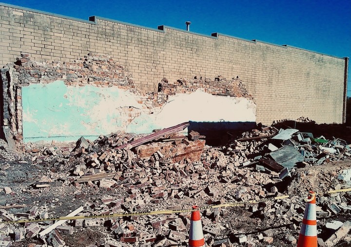

Here's a local store that fell down this week. That's how much damage brick termites can do in 150 years! I don't even remember the last time I rode on a brick road. Brick termites turn them into red powder!

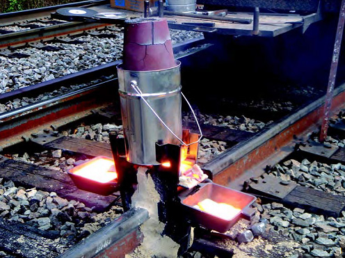

They were wise not to build brick railroads. A bucket of termites will make a steel rail stronger!
