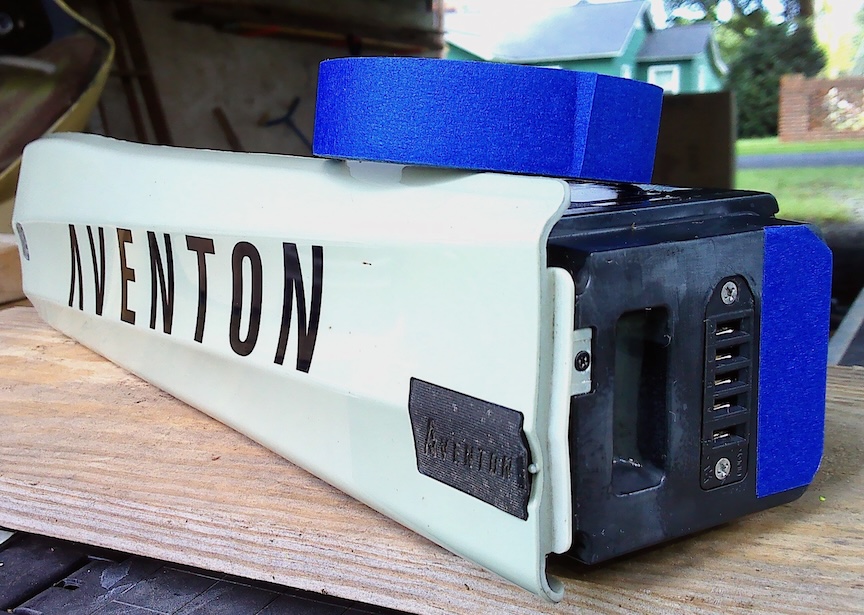

If I put the battery in without the plastic plate, I could ride with no noise. With a slip of paper, I found that the butt end of the plate hit the frame. The springs in the top bracket must have pressed the battery hard enough that lubrication didn’t prevent creaking.
A piece of duck tape 0.23mm thick on the butt of the battery acted as a shim against the connector bracket, moving the battery and plate forward enough to stop the creaking. Concerned for my reputation, I replaced the tawdry duck tape with two layers of professional masking tape, which together are also 0.23mm thick. I still can’t slide a slip of paper 0.18mm thick between the back end of the plastic plate and the frame, but I can ride in silence. If there’s further trouble, I can add a layer of professional masking tape.
