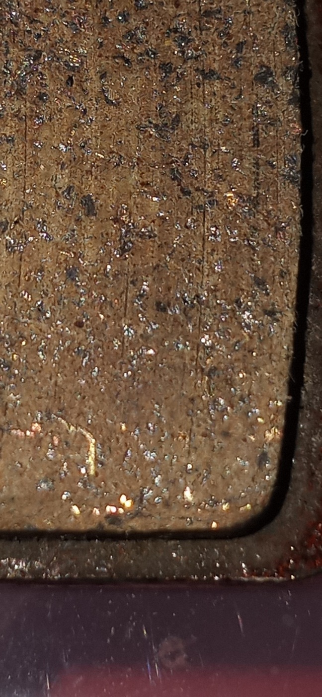

IIRC, you and I have the same Tektro brakes?

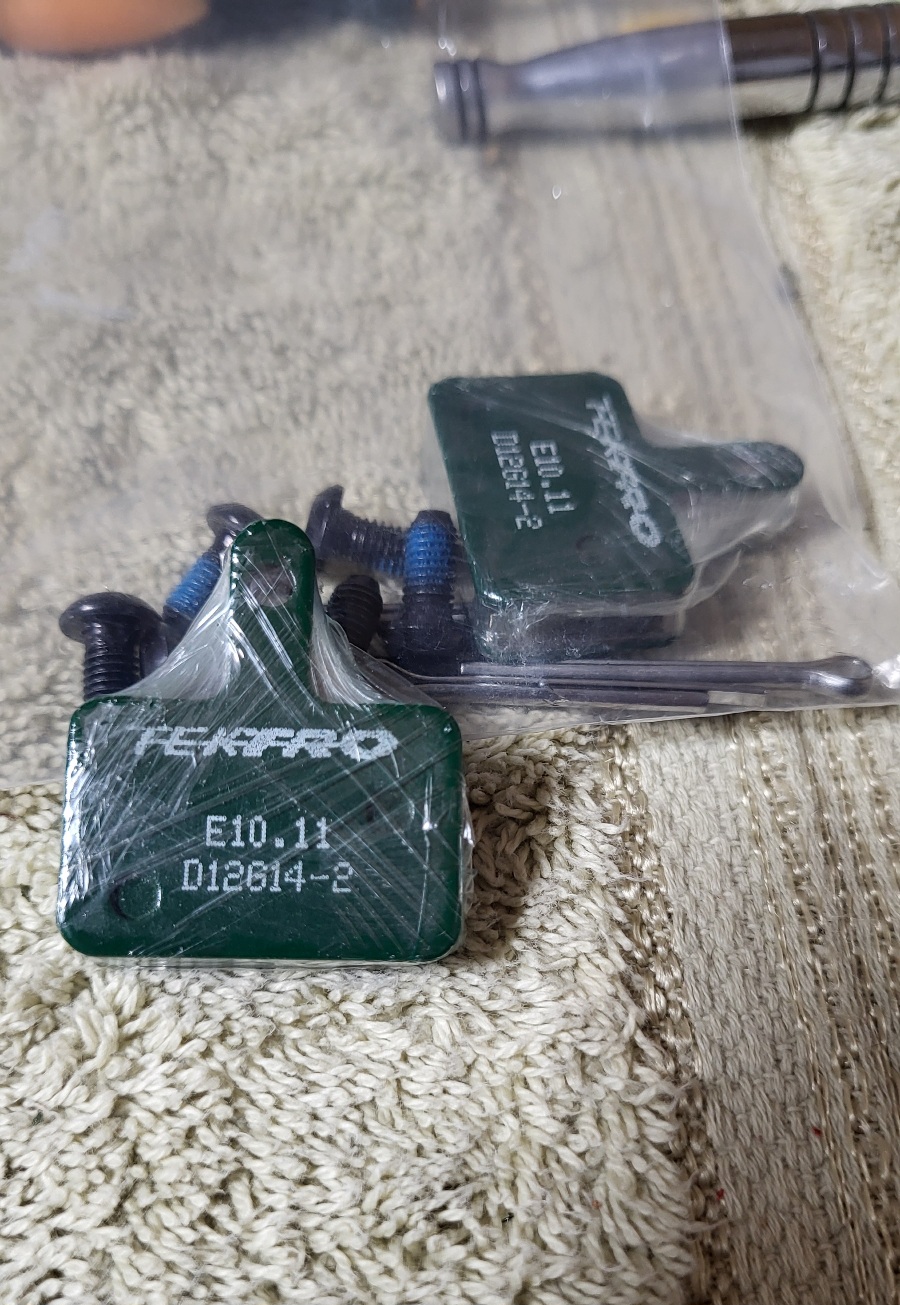

I've only ever used the OE Tektro brake pads,..

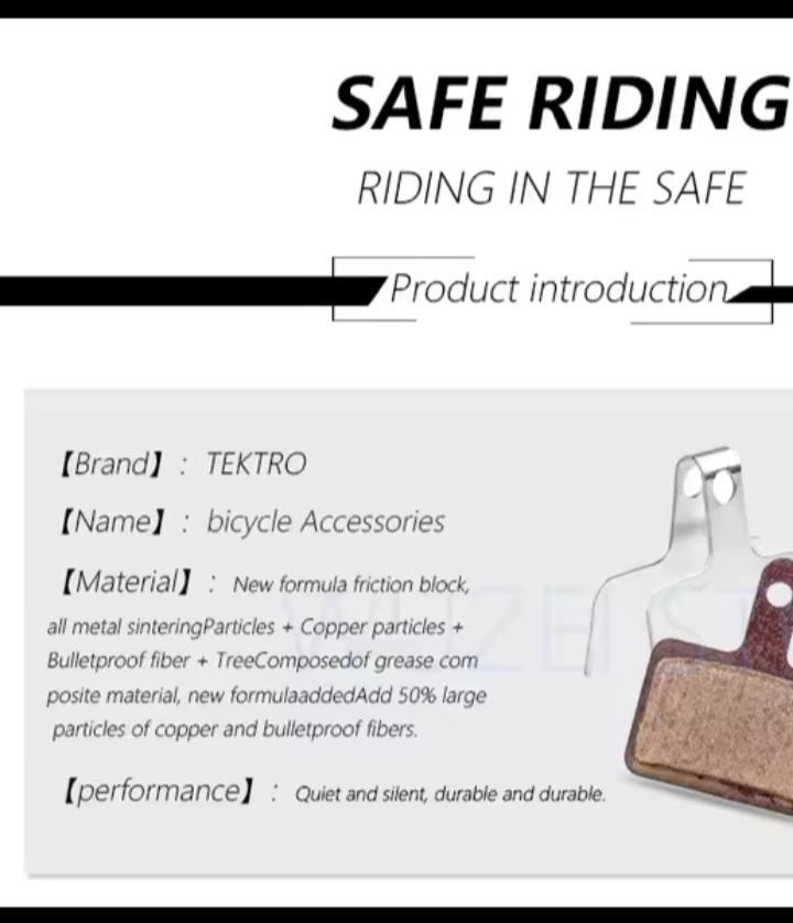

This is what I found out about the OE brake pads,..
Sounds like they're semi-metallic resin pads??
You can see all the chunks of copper and bullet proof fiber in the pad,..
Now I remember. I bought semi-metallic because I the Tektro pads on my Abound seemed different from those on my 2 Rad bikes, even though they were all marked E10.11, like yours. For one thing, the E10.11 pads on the Rads could soften in prolonged high humidity. They lost braking power, wore very fast, and left bumps on disks.
This page says resin pads lose their grip in rain. I had no trouble in rain, only in periods of wet nights. It hasn't been a problem with the E10.11 pads on the Abound or the replacement resin pads on the Radmission.
It says resin pads produce less heat. I doubt that. A certain amount of braking will produce a certain amount of heat. It says sintered pads need to warm up to have a good coefficient of friction. That may explain why when I've tested semi-metallic pads, they worked poorly for the first couple of tries. That points to resin for me, due to visual obstructions in town. I'll ride slowly with fingers on levers because I may not have milliseconds to spare.

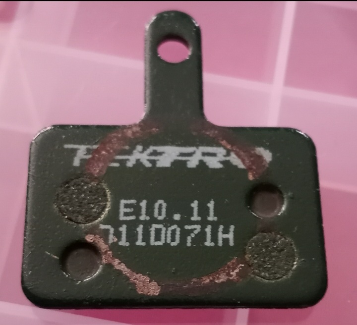

Uh-oh, I misinformed you. The pads on the front of my Abound, that didn't have much bite and sounded scratchy, were the OE Tektro E10.11s, different from the E10.11s on my Rad bikes. The pads on the back, that were quiet and had done most of the work for a year, were the Corki ones with black plates, described as "resin, semi-metallic, sintered metal." I figured they must be worn, so I replaced them with the pair I hadn't used. On a closer look, they weren't very worn, so I put them on the front. When I took them off, I hadn't marked which was outboard, so I didn't know if they were backwards from before.
I pulled the left lever and my boat whistle was back only louder. What's more, there was no detectable drag, so I could keep it up all day. Dogs started howling. When they heard me coming, 18-wheelers would be pulling u-turns and rolling coal. (I like to scare them away in case they have air in their brakes.)
The new pads in back behaved like the old ones. Before long, the second-hand front ones quieted down and took hold.
So far I haven't seen pads advertised as "sintered bronze," but I find the pads that Corki calls semi-metallic better than the old or new Tektro E10.11.

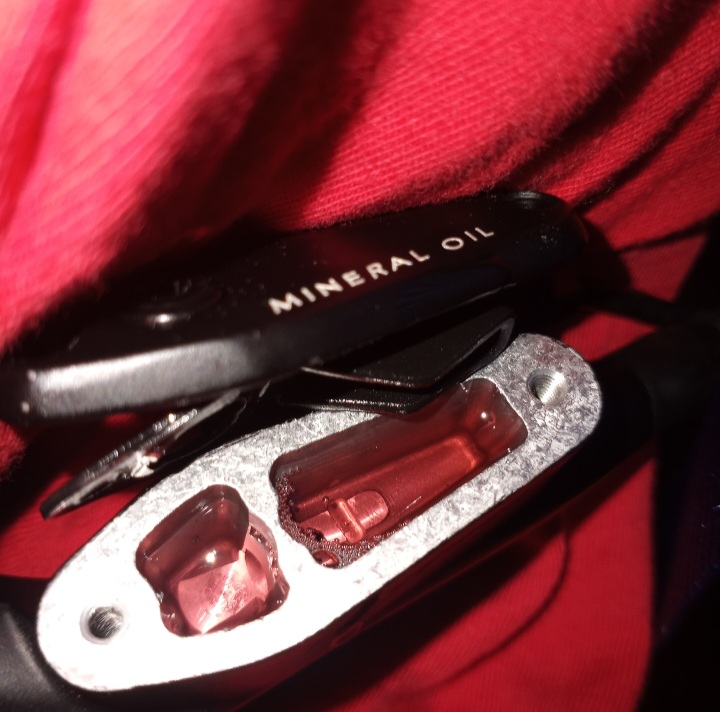

I forget why I bled my brakes the first time? I think it was because my rear brake lever got soft and was hitting the handlebars?
I've only done a top bleed at the lever, and haven't flushed the fluid at the caliper.
I also opened up the reservoirs on my brakes, cuz I needed to know what was going on inside there. 😁

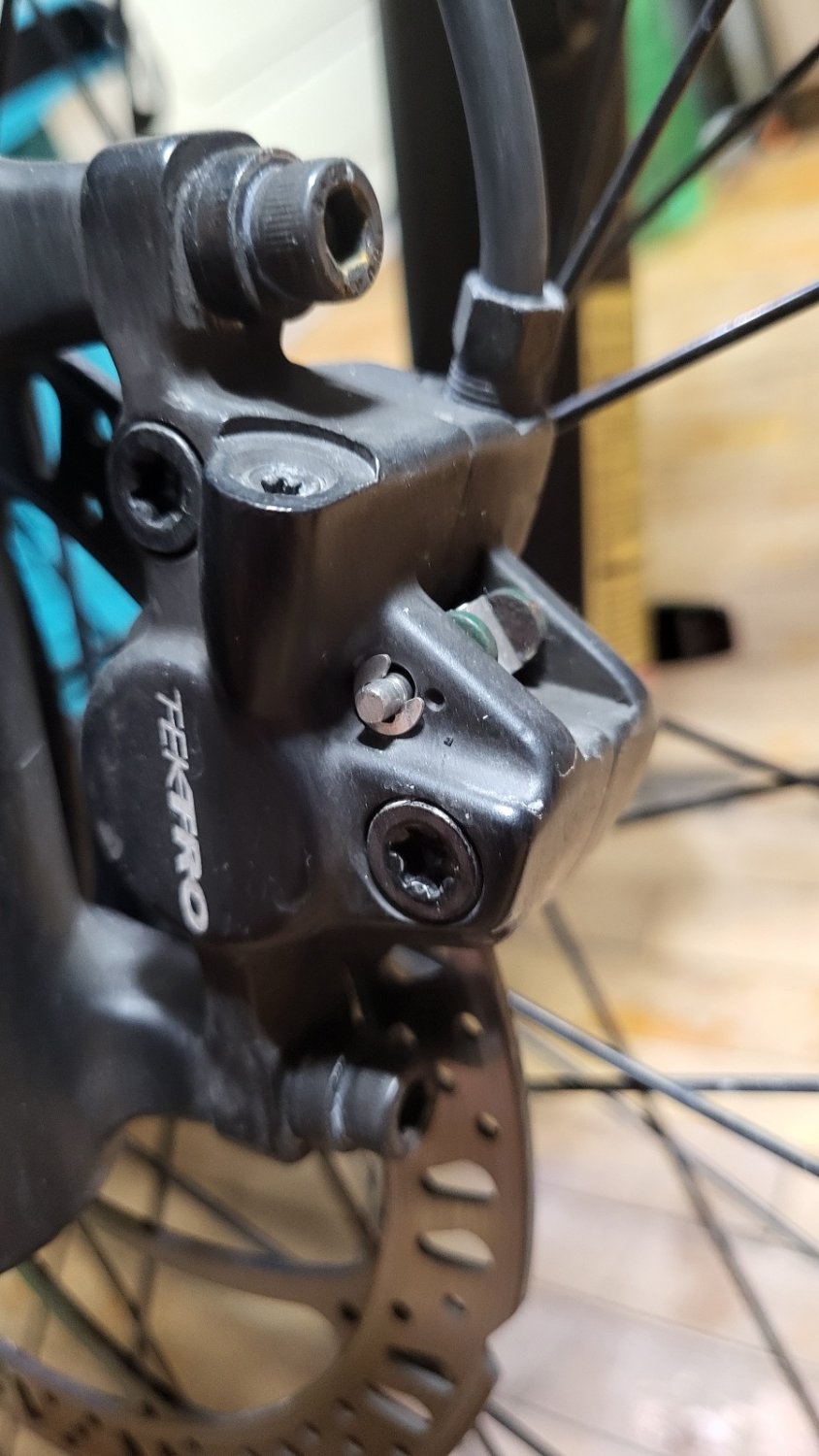

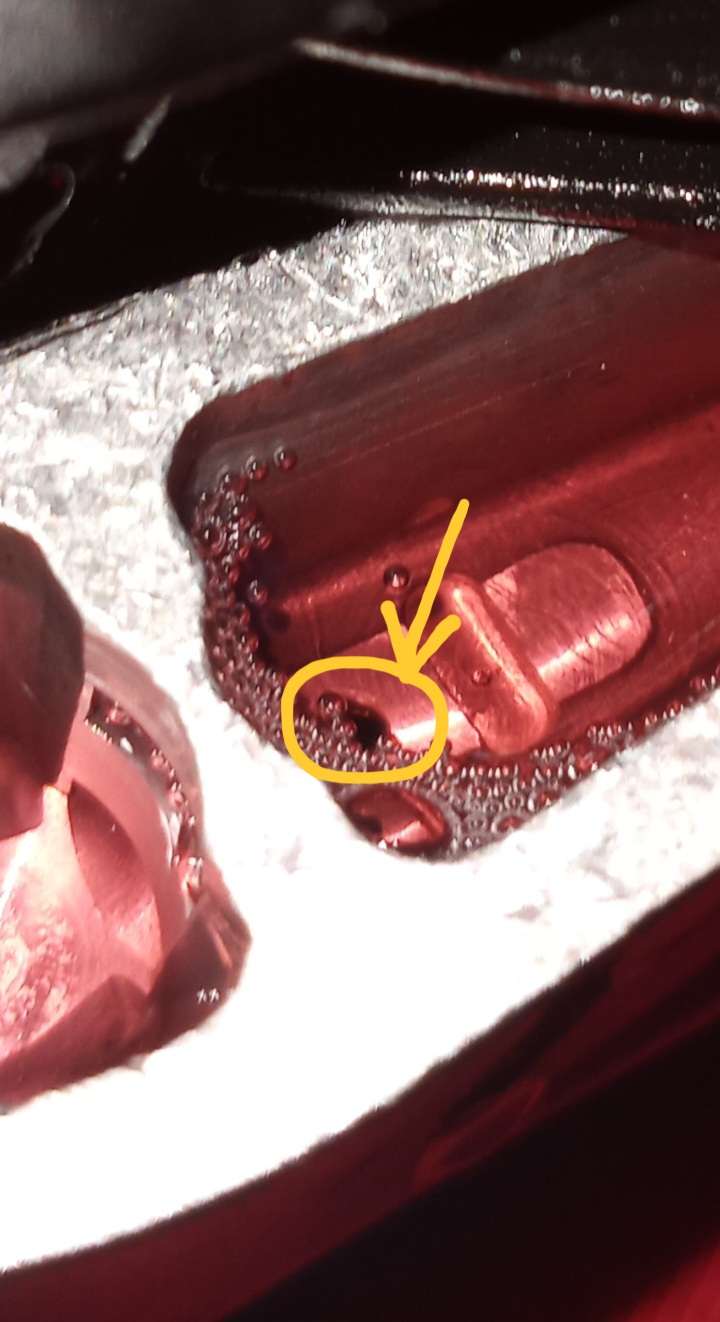

I had to bleed my front a second time, two days after the first time. Because the line was short and mostly vertical, a top bleed worked. The first time, it was a lot of little bubbles. The second, It was a bubble about 75mm long in the clear vinyl tube.
I'd noticed that one piston extended much farther than the other. I guess one didn't slide past its seal as freely as the other. Park Tool and other internet sources said one should extend and clean each piston when one changed pads. So I did. I didn't extend either far enough for oil to leak, but it seems as if air got in.
