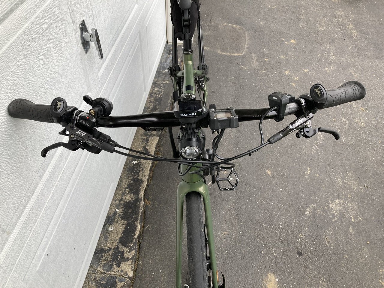

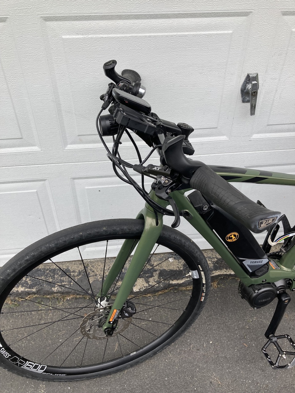

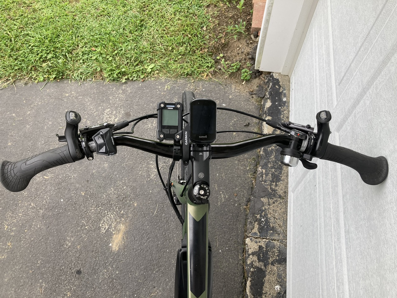

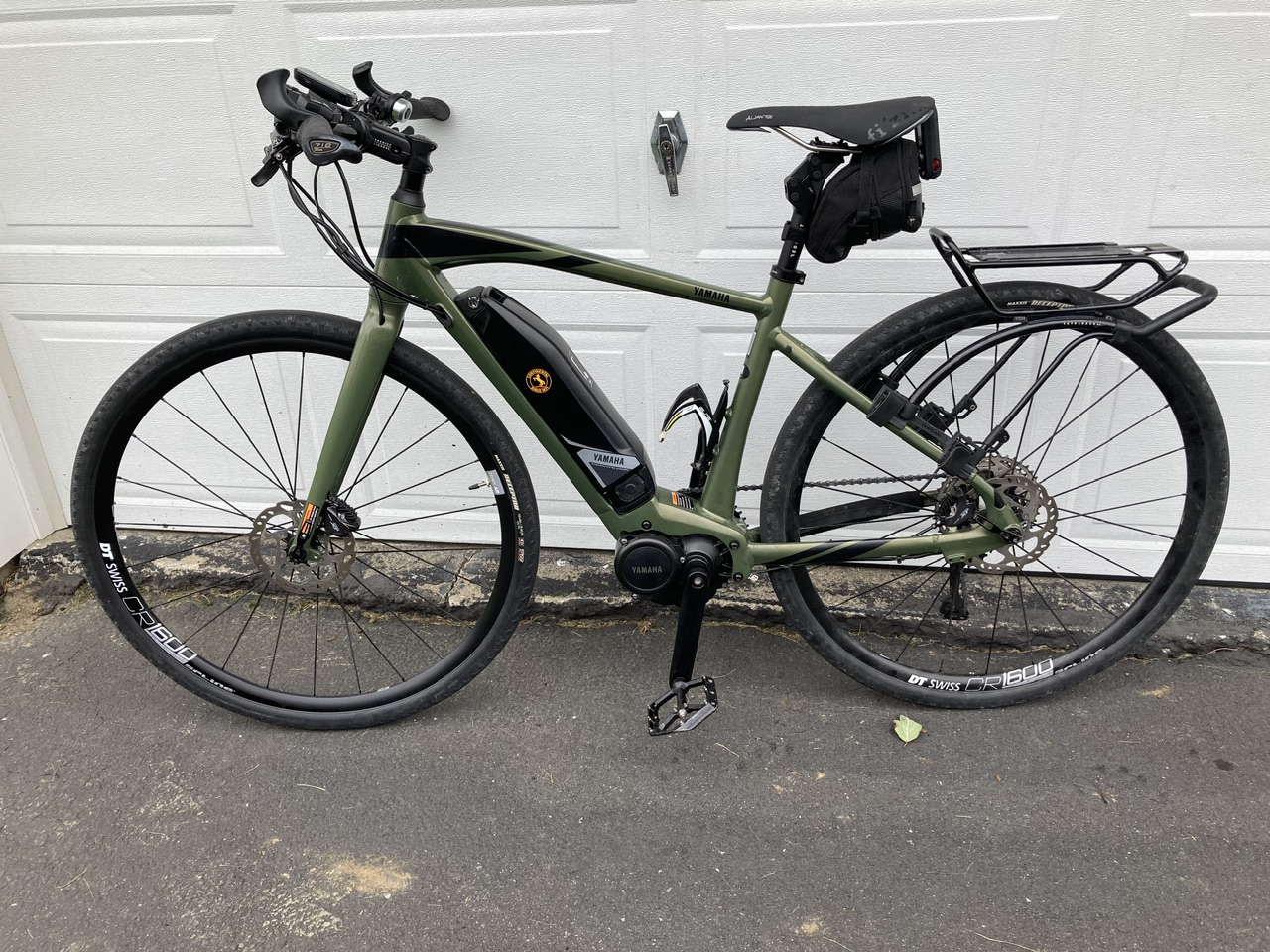

I finally bit the bullet and converted my Cross Core to hydraulic. I went with a Shimano XT setup. I feel that the upgrade was worthwhile. The install was straight forward, the bleed was easy and the performance is great. I didn’t need to go with the XT level, but there was a good deal from Universal Cycles on the older XT M8000 levers, (the 2015 variant that allows you to keep the optical gear selector).
