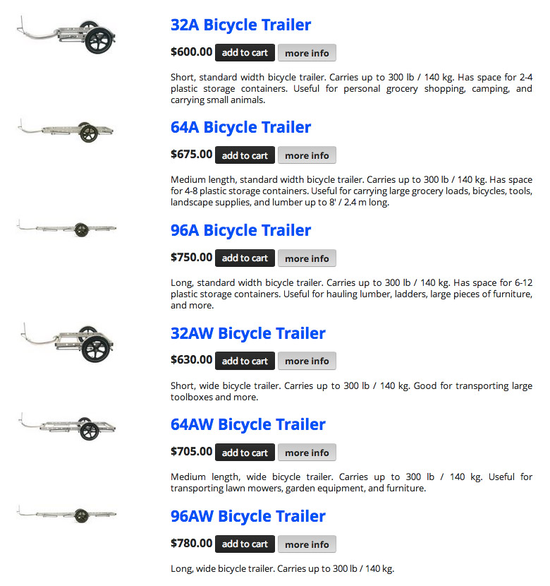

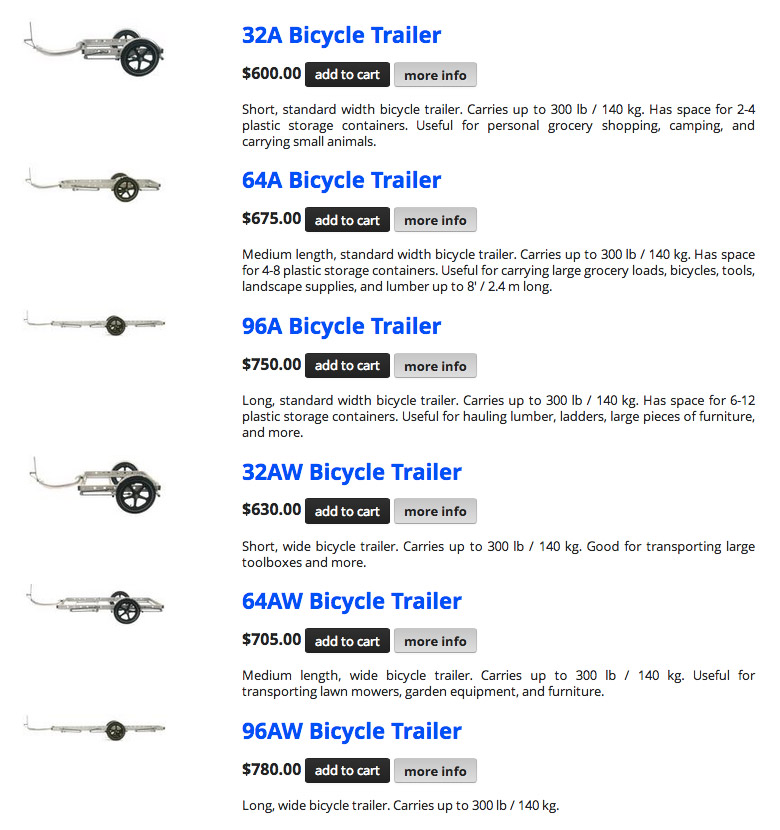

Second batteries for ebikes are not cheap. If someone has a serious need for unplugged travel, a system can be designed, swapping two batteries. I think the idea behind these trailers is that there is more capacity, and part of that might have to be used to have more power, better options. Having a decent 12V storage battery might be very useful, along with an inverter. The first system gives you a nice source of AC power for any need. And you just plug the basic ebike charger into the 120 outlet, and the sun refuels the source battery when it can.
I can see where someone who would be utilizing a trailer all the time could just design a bike and integrate the bike power to a battery system that integrated solar. That's not where the buyers of ebikes are going, right now. But solar has just gotten so cheap that the kinds of power that any ebike uses represents a rather tiny investment in solar panels. What you can't do is easily keep the panels in the sun. You basically need a real trailer to carry the panels, because of the size, but if you can carry them, the sun will provide the power, at least while parked. For $400 buy two 100W panels (the heavy kind), a basic charge controller, a 500 W inverter, and a 30 AH AGM battery. You have to figure out how to carry it. The lighter panels add $250.
