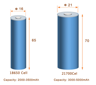

We will be using Samsung 50E cells.. so should be max capacity.Note the use of 21700 cells instead of 1850s. This is nice! The 18650 is 18 mm diameter x 65 mm length. 21700 is 21 mm x 70 mm. Doesn't sound like a big difference, but in volume the 21700 is almost 50% larger (47%, to be exact). The 18650 typically has about 2.0 to 3.5 Ah in each cell, depending upon quality. The 21700 starts at 3.0 Ah and can go to 5.0 Ah.
Comparative sizes:

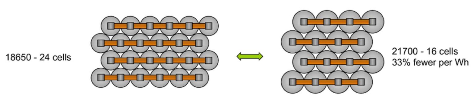

This requires a new frame design, with one big honking downtube, but the result should be spectacular. There are other advantages in that there are fewer cells per unit of power, so simpler battery management and fewer connections to fail.

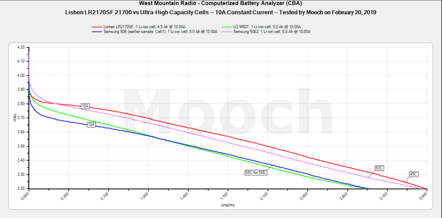

Check out the relative watt hours you can get from them at certain current draws and how much voltage sag you get with the 50E's under load. Mooch does great battery benchmarks complete with discharge voltage graphs at various discharge rates, as well as cell temperature taken - very easy to find his benchmark results online! You'll probably want a lower discharge rate on the BMS & 1500W max limit on the controller for the 50E's, or look into Molicel P42A or Lishen LR-2170-SF. The Molicels are 40T killers for high output and the Lishens will deliver more energy than the 50E's at 10A, with lower self heating.We will be using Samsung 50E cells.. so should be max capacity.
14s4p with 21700 is around 21ah.Check out the relative watt hours you can get from them at certain current draws and how much voltage sag you get with the 50E's under load. Mooch does great battery benchmarks complete with discharge voltage graphs at various discharge rates, as well as cell temperature taken - very easy to find his benchmark results online! You'll probably want a lower discharge rate on the BMS & 1500W max limit on the controller for the 50E's, or look into Molicel P42A or Lishen LR-2170-SF. The Molicels are 40T killers for high output and the Lishens will deliver more energy than the 50E's at 10A, with lower self heating.
Sounds like you're doing 14s7p in the packs if 21Ah is the capacity for 80-20% charge in which case probably not as big of an ask for the 50E's and my previous point may be moot
