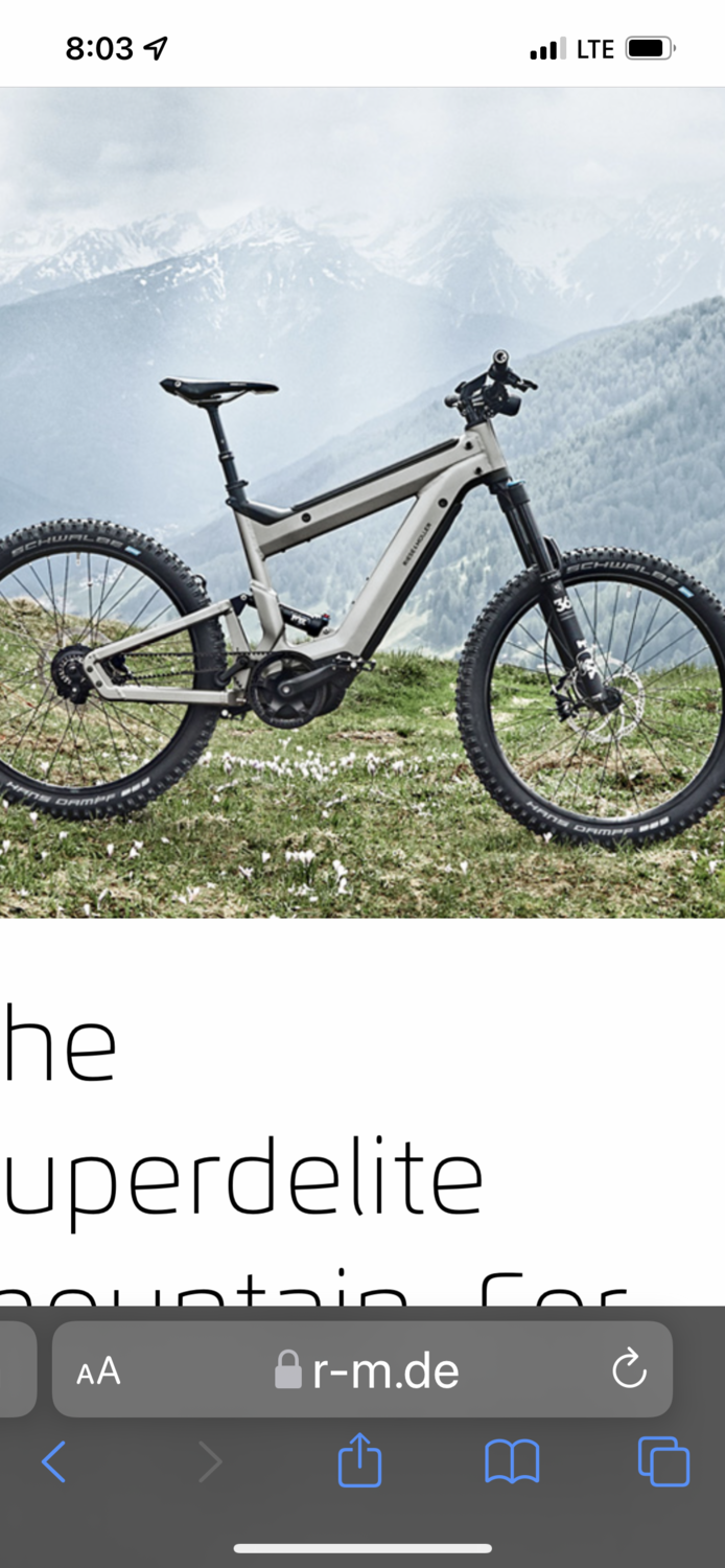

when I look at r&m bikes, they seem to be specced out nicely. They have a full suspension that matches up with Hydra the closest.
Yes 11k but that is 2 integrated batteries. Fox shocks, name brand motor and sweet looking display, electric shifting rohloff. Full suspension with gates belt. Super nova light, luggage rack, hell they even give you a shock pump.
Granted that was not their 7k version, but spec out a bike like that on ww and I would assume you would be close to 10 and still not able to match all the features. That is not a 4K in raw cost.
So if we want to run them down for their markup do you mind sharing yours? When I spec out a similar bike on watts wagon, I am very close to that price. So to act like you get better components for the same price is simply not true.
I also love the cable management done in this bike compared to the ww version. I do not understand why all ebikes are not setting it up to look like this.
Yes 11k but that is 2 integrated batteries. Fox shocks, name brand motor and sweet looking display, electric shifting rohloff. Full suspension with gates belt. Granted that was not their 7k version, but spec out a bike like that on ww and I would assume you would be close to 10 and still not able to match all the features.
So if we want to run them down for their makeup do you mind sharing yours?
