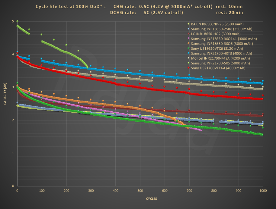

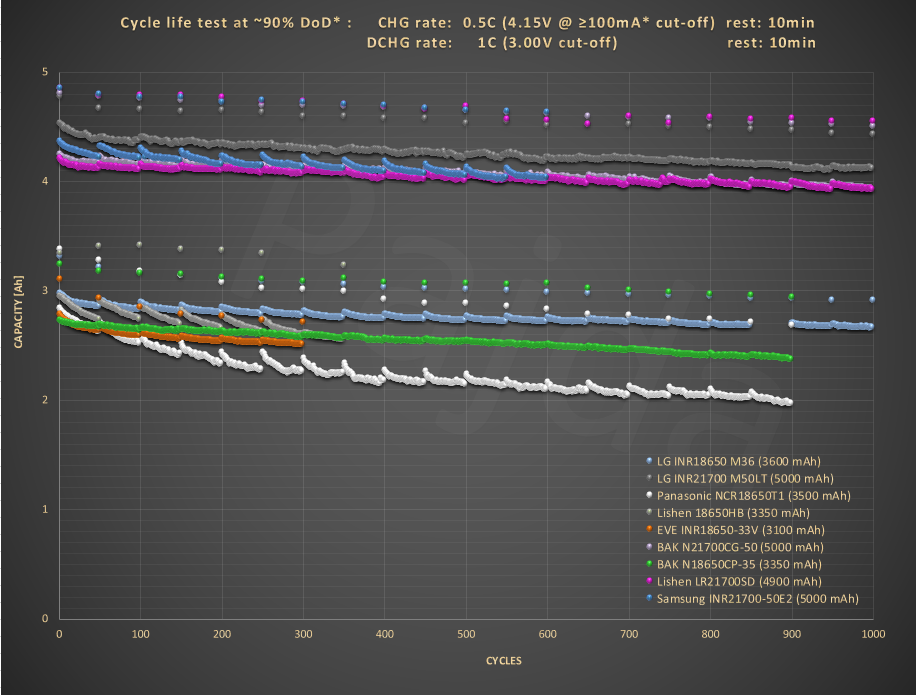

Explain this data with cells tested by fully charging and fully discharging approaching 1,000 cycles

Lithium battery cell technology and products have improved since 2016. Manufacturing with wire bonding. More data?
