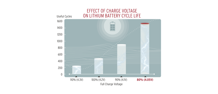

No, The estimated life of a pack is it's cycle number.
Charging to half charge counts as a half charge.
Interesting enough, if you regularly only charge to 80% full, you extend the life of your battery to way more cycles than the 20% difference. I think you actually double your cycles if I remember correctly. Edit, it's actually 3 times more cycles at 80 %.
MORE FROM GRIN:
Benefits of Partial Charge​
One of the key benefits of the Cycle Satiator is its ability to let you easily control the charge level of your battery. It is now well known that most lithium chemistries (with the exception of LiFePO4) can see drastic improvements in calendar and cycle life when they are not held at the nominal full charge voltage of 4.2 V/cell but are charged to a lower voltage instead. That’s how electric car manufacturers are able to 5-8 year battery warranties on cells that usually only test to ~500 cycles.
Very cool ! Thanks !
