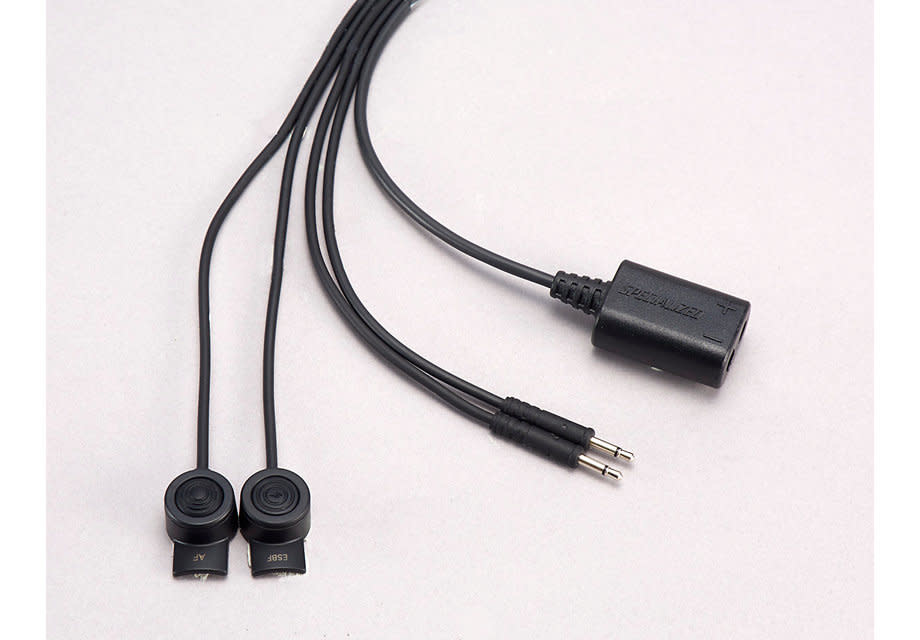

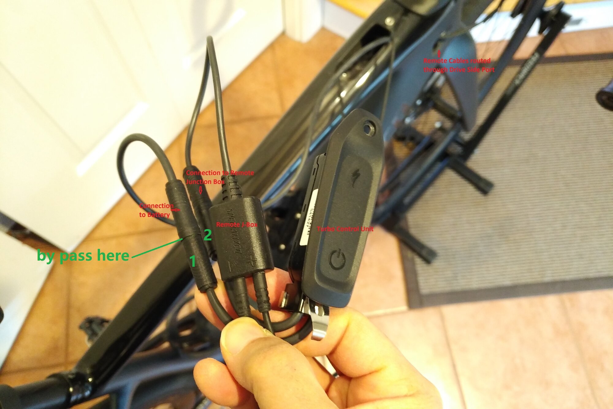

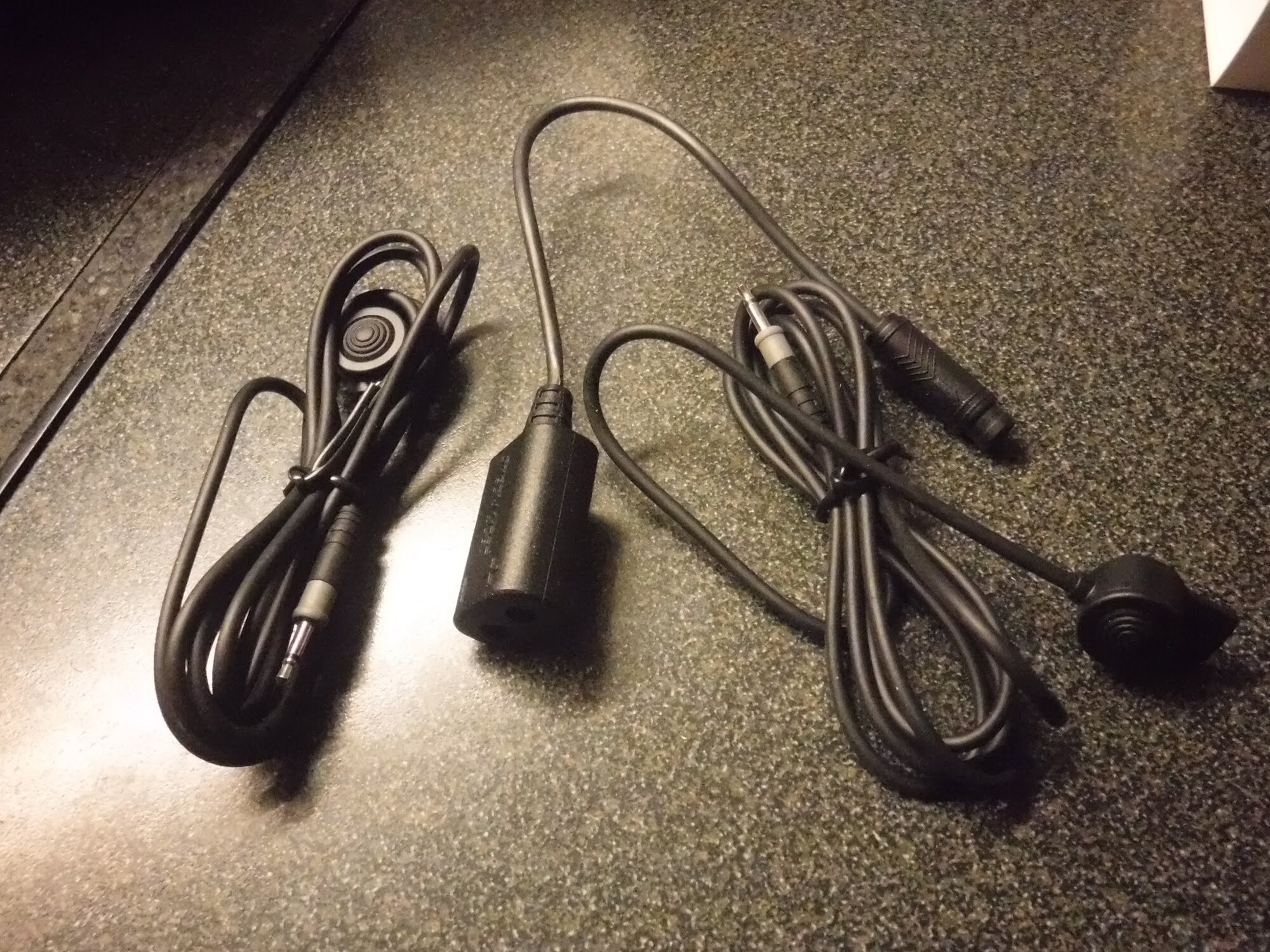

I've got the Creo REMOTE buttons installed on my Creo. They are on the underside of the bars, under the tape near the stem. You cannot see them in that position. Others have added them at the edge of the brake hoods. Yes, looking down is not very safe at speed or in traffic or on bumpy roads. Here's some pictures to possibly figure out sizing and space.
