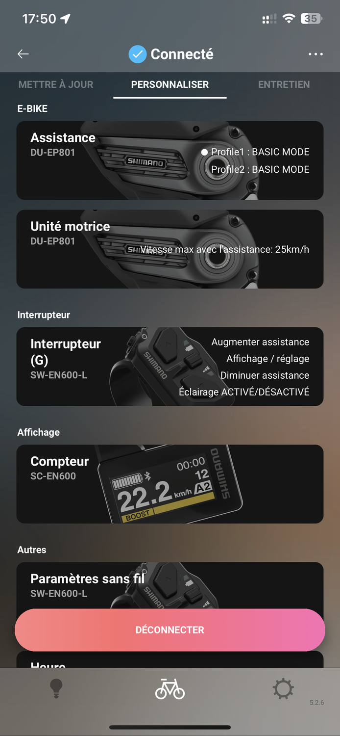

Hi have an Orbea Rise M20 bike with these components :
- Motor Shimano EP801
- SW-EN600L unit
- SC-EN600 screen

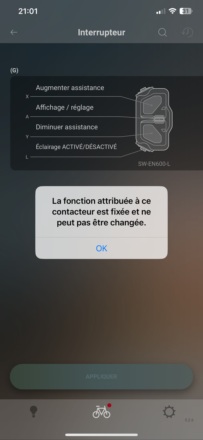

Indeed I would like reconfigure the light switch button into "d-fly" in order to navigate on my Garmin edge unit (I do it on my road bike with di2 ultegra).
When I tried to reconfigure "display scroll button" no problem but if I tried to reconfigure light switch button I have an error message. The screenshot is in french language but it said that the function is locked on light activation/desactivation and cannot be changed, however I don't have lights on my bike and shimano manual said it is possible to reconfigure it...
Do you now how to unlock it ?
