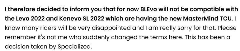

No. That doesn't work. Once the new app connects to the bike it flashes a new programme to the BMS to lock out all comms via bluetooth with any other app. It is over for BLEVo. This is the official announcement from BLEVo
See link https://www.emtbforums.com/threads/blevo-game-over-with-mastermind-tcu.227
James, it is not necessarily so (I know the statement of Paolo Dozio).
When I found the Specialized App underbaked, I also found making it the Companion App denied any access to BLEvo. What I did was uninstalling the Specialized App, "forgetting" the Bluetooth connection, and pairing my Vado with the phone again. Now, BLEvo works with my older Vado. Moreover, reinstalling the Specialized App but taking care not to make it a Companion App again allows me using either BLEvo or SA (one app at a time). FYI, my Vado electronics are equivalent to 2020 Vado 6.0, which is a non-standard Specialized e-bike (45 km/h or 28 mph).
Necessary to mention: Paolo Dozio's message explains that BLEvo would not work with the new Mastermind e-bikes because Mastermind has its Bluetooth channel encrypted.
