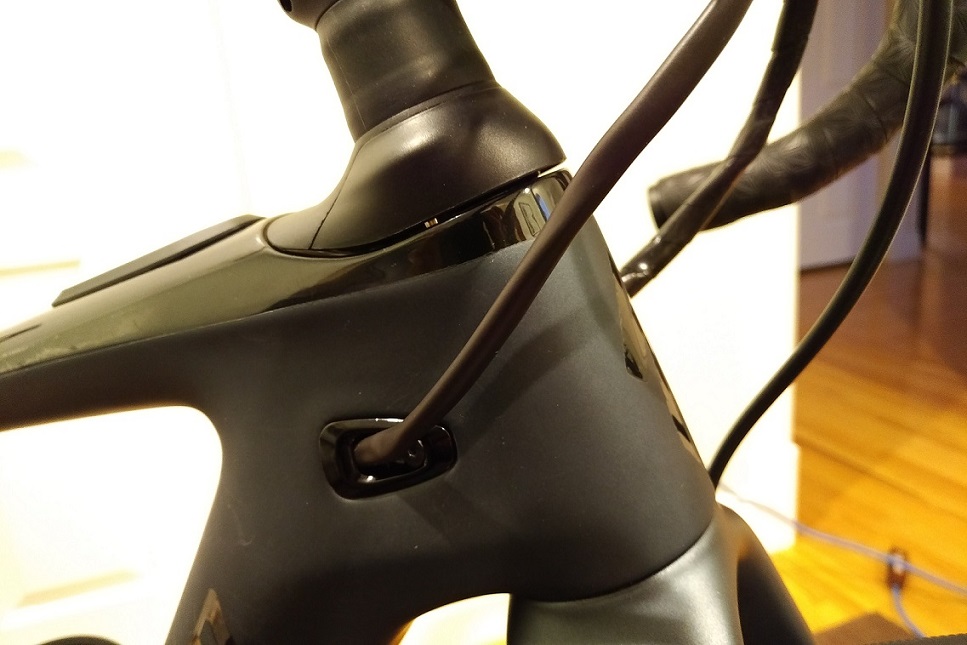

Somewhere along the line Specialized apparently realized that they were driving people insane trying to thread the wires for the remotes through the port on the downtube. My 2022 aluminum Creo has, lo and behold, a second port right at the front of the top tube, directly in front of the controller unit. The documentation for the Road Remotes doesn’t even know about this, the illustrations, photos and directions showing no such port.

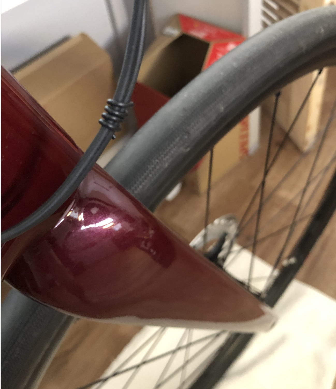

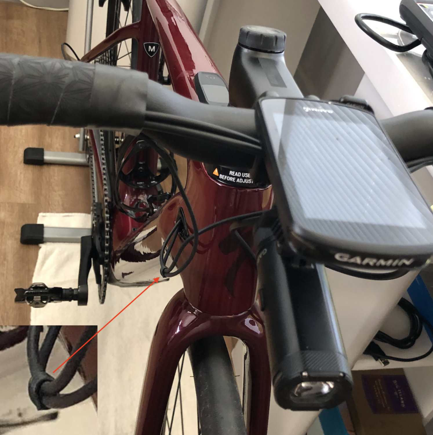

I came here searching for a solution for the remote wires. My Creo came with the remotes installed but the wires going from the handle bar and frame were just flying freely. I wanted the wires collected together. I didn't want to use electrical tape because of the residue and it will eventually unravel. I first tried a slit vacuum tube but it looked awkward. I found a simple free solution for me. I cut a piece of thin wire and wrapped in around both wires.
I came here searching for a solution for the remote wires. My Creo came with the remotes installed but the wires going from the handle bar and frame were just flying freely. I wanted the wires collected together. I didn't want to use electrical tape because of the residue and it will eventually unravel. I first tried a slit vacuum tube but it looked awkward. I found a simple free solution for me. I cut a piece of thin wire and wrapped in around both wires.View attachment 157039

Thank you everyone on ideas to secure the remote wiring. All great ideas. For the present I will stay with my original suggestion. I prefer the concept of less is more or simple is better. I was even considering using silicon to glue the wires together but I don't think I could have pulled it off neatly and I don't know if it could be undone.

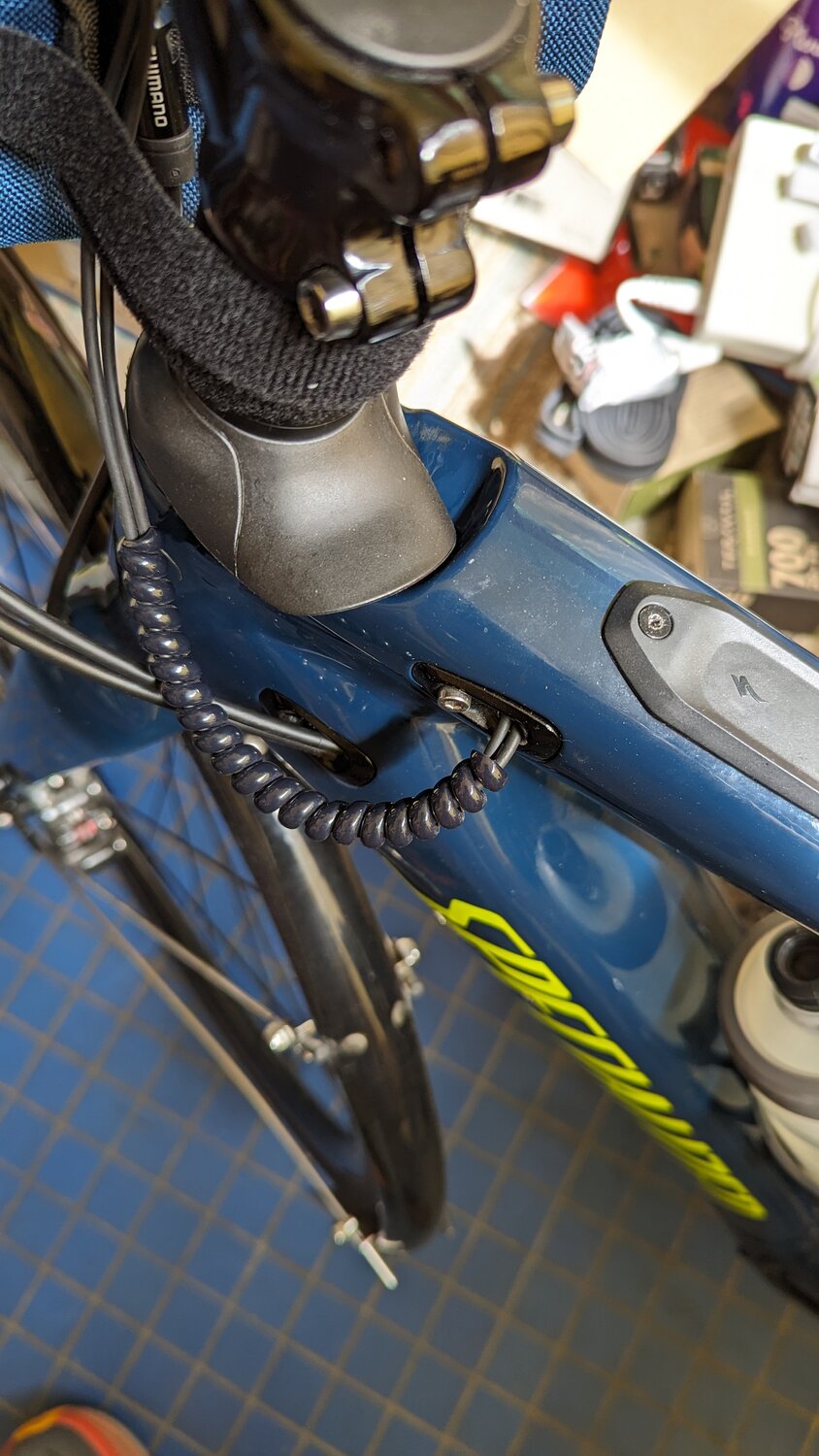

Specialized actually has a black plastic clip that holds two wires together. I have them on my Vado, it came with them.
