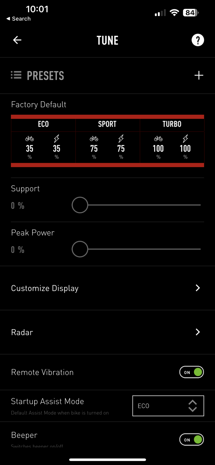

Could you please check what the default Assist/Max Motor Power % are for each mode on your Vado?
This is what it shows. It should be noted, my only other preset has 20% in eco instead of 35%. So if it was on that, it is even better.
I haven’t adjusted anything on this bike yet in terms of power/tuning.
Thank you! I have found the 35/35% ECO setting appropriate for my long road voyages. I've modified the SPORT setting to 55/55% as sufficient for very fast forest rides with my cycling club, and the pedals still feel they need to be pushed hard to be on par with my buddies (more assistance and I either ride dangerously fast or am ghost-pedalling). 100/100% TURBO is for hard mountain climbs and for emergency.

Honestly, the default sport at 75% is a bit much a lot of the time. On my old bike I sometimes used: 20/20-50/50-100/100. But now, I think eco would be low enough that I would spend too much time in sport for "normal" riding. And sport at that setting would definitely have put me in turbo at the crazy grades today (12-14% at times). I might go back to micro-tune. There were definitely times today where I *would* have used something between 35/35 and 75/75.
I might start experimenting with varying support and peak power separately. I rarely want the motor to be "doing the work". But, if I am really pushing in the effort, I don't mind the assist rising. So, I am thinking something like 30/75 for eco. Maybe 60/75 for sport and leave turbo bonkers at 100/100. Gonna experiment.
Try 20/100 or even 15/100. It is rewarding your leg effort magically. Because if you pedal lightly, you would be riding slowly. Yet put some effort and you will get the thing flying! Personally, I use 30/100 for my Vado SL on my daily rides (it is 15/50 for the big Vado). Whenever I want to climb an overpass, I just downshift and spin the pedals. It works! 30/100 on my Vado SL gives a similar experience as 50/50 but the motor is far more flexible and rewarding the effort.

Just curious, what do these X/Y numbers mean, and how do they relate to the Eco and Turbo assist settings?
Specialized e-bikes allow setting any percent of assist (regardless of the Assist Mode name, which is just a preset) using the Mission Control app, or MicroTune (which is a button on the remote allowing manipulating the Assist in small steps during the ride).
The first number is the Assist %, and the other is Max Motor Power %:
  • My full-power Vado has the Boost (or Leg Power Amplification) Factor of 3.2. If I set the Assist to, say, 35%, each Watt of my leg power shall be amplified with the mechanical motor power of 3.2 * 0.35 = 1.12 W. So whenever I input 100 W mechanical into the cranks, the motor shall assist me with 112 W (mechanical, not electrical!)
  • The other parameter is applying a cap on the Peak Motor Power. The motor of my Vado 6.0 has the Peak Power of 520 W (mechanical). If I apply 35% Max Motor Power, the motor will never deliver more than 0.35 * 520 = 182 W. If a strong rider is pedalling so strongly the assistance should deliver more than 182 W, no more than 182 W would be provided.
For instance, the rider inputs 200 W at 35/35% assistance. The Assist the rider is asking for is 224 W but the Max Motor Power keeps the assistance capped at 182 W. The Max Motor Power % setting is essential for ensuring long distance battery range. However, a strong rider can make the Assist very low but not be limiting the Max Motor Power. This way, the motor will deliver flexible assistance, only depending on the rider's leg input. (The Assist/Max Motor Power is a feature unique to Specialized e-bikes).
In case of the dynamic's Vado 5.0, the Boost Factor is 4x and the Peak Motor Power is 565 W mechanical.
In case of all Specialized SL e-bikes, the Boost Factor is 1.8x and the Peak Motor Power is 240 W mechanical.
