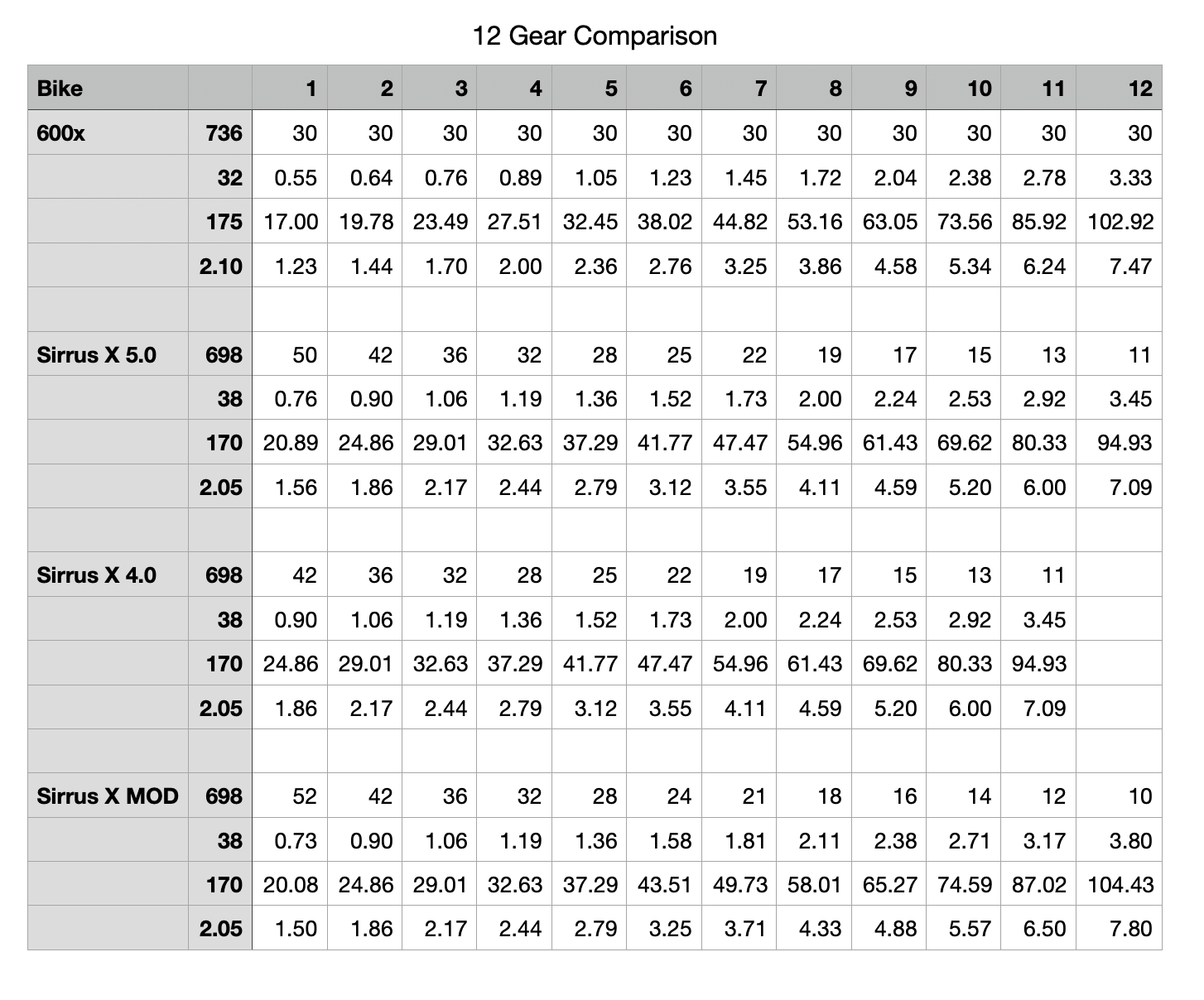

Attached is a comparison of the 600x, sirrus x 4, x 5 and a mod version with a 10-52 cassette compatible with the gx axs electronic shifter upgrade kit. Right now, it looks like a sirrus x 4.0 with drivetrain upgrades makes the most sense (won't cost too much more than the x 5 stock). And the only thing that would change that is if the carbon frame itself is worth anything to me. And I have no way to know that currently (and may still need to deal with weight limits). I would also eventually want a power meter crank arm (hate the garmin pedals).
Knowing what I know today, I would do a sirrus x 4 with the intent to upgrade it.

that 50t gets you pretty close! i can’t think of any reason the sirrus x 4 couldn’t take the 10-50 with the right RD.

If I got the x 5, I wouldn’t upgrade the cassette. But I would on the x 4 (unless I suddenly found the gearing to be sufficient for the bikes intended use).
