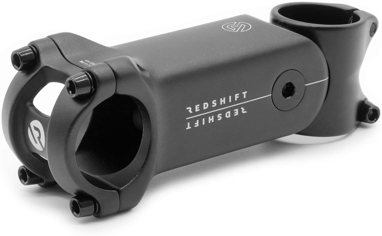

I'm not familiar with the Moscow but my wrist discomfort was all but eliminated with these five items:
1 - Stem riser did indeed make a difference (Unfortunately, I can't help with the fit on your Moscow)
2 - Replaced handlebars with a set that is swept back 45 degrees.
3 - replaced the OEM grips with the ergonomic type.
4 - Bought a good pair of padded riding gloves.
5 - I got the most relief however from a Redshift suspension stem:
If the slack in your display cable will permit, Redshift also makes a model with a 30 degree rise which will also raise the bars around 2 inches.
Keep in mind every rider & bike is different. What works for some may not for all. The above is simply what worked for me.

I purchased a Satori stem riser from a local high end bike shop today. $35. plus $10. installation (about 15 minutes). Could easily have installed myself but for $10.00 thought it best to let bike pros do it.
Installed at half way re height. About 2 inches with another 2 inch rise possible. Will likely increase to max height as that is the only way to determine comfort level.
My mistake...not that centre display cable but brake cables re max height increase. Got lucky as enough slack to max height is possible.
Thanks again!

I am a little wary of adjustable risers, having had one fail spectacularly with painful results... I swapped my stock riser out for a shorter (35mm) one, and actually removed my thinnest spacer, and found just having my handlebars a couple of inches closer took a lot of pressure off my hands, not having to lean forward as much. It also made steering easier, with the handlebars as forward as they were, I felt like I was steering a doubledecker bus lol.
