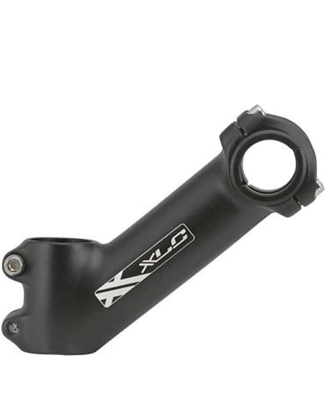

I needed some rise, but not as much as a steerer tube extension and as I do ride some rough trails I didn't want an adjustable stem. I went with a long (120 mm), and steep 40° stem.
It gave me enough rise and is rock solid. Just another option to consider.

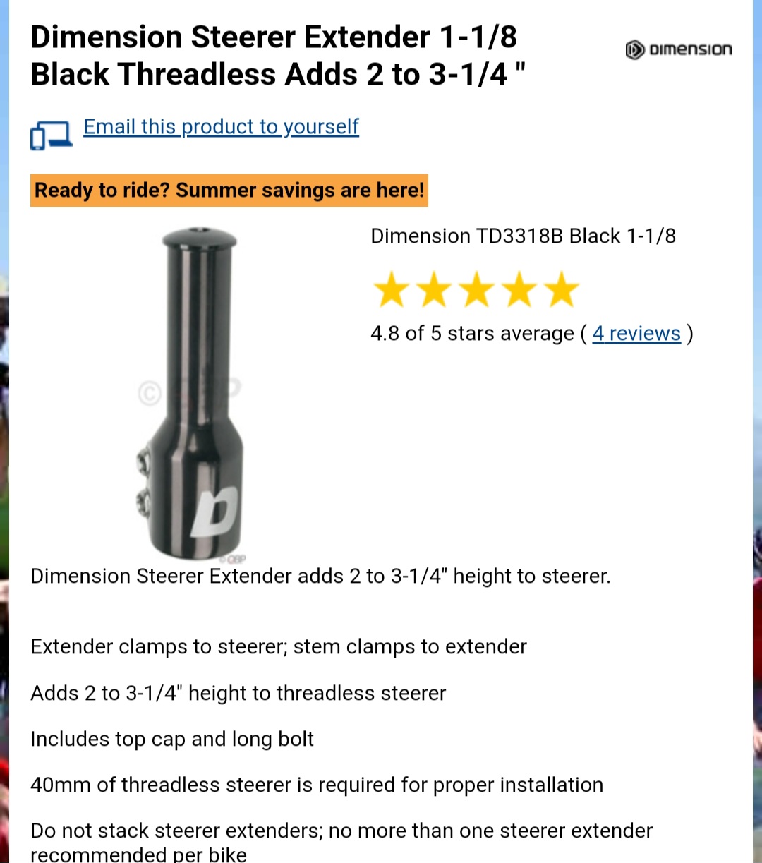

The stem is the part that connects the handlebar to the steerer tube. A steerer tube extension, extends the your existing steerer tube.
