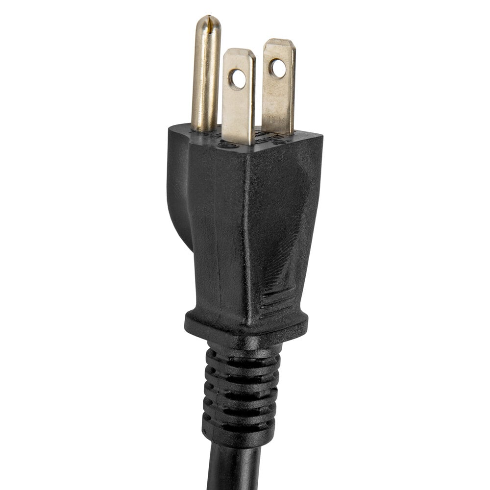

Did your 1800 watt dryer have a plug like this? I'm sure it's against the National Electrical Code for a manufacturer to use a plug like this on a device that draws more than 15 amps. Even if on 20-amp circuits, household receptacles are rated at 15 amps.

No, all the dryers I’ve seen in recent memory (last 15 years??) have two pronged plugs emanating from a crappy, rectangular box that has some sort of circuit breaker button on it… Kind of like GFI sockets do. But, no 3 prong plugs.
Mine's a 2-prong, too! I should pay better attention. It's an NEMA 1-15 plug. When grounded plugs came out, the NEMA standard was the 5-15, as pictured. The 15 means a 15 amp limit.
Harvey Hubble invented the plug with two parallel blades in 1910. Before there was a manufacturer's code, a manufacturer might use that plug on equipment that drew enough current to blow the fuse or damage the receptacle. The NEMA standards date back to the 1940s. If a device draws more than 15 amps, the manufacturer must use a plug that won't fit a standard residential outlet.
