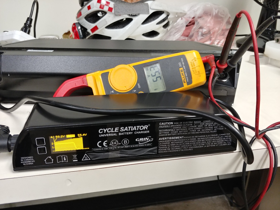

Believe the multimeter.
So the reading on the bike is 54.5v while the charger says 55.4 & the meter shows 55.3.
So the bike must be almost 1V off? All of my bikes are off but I guess they're close enough it doesn't matter.
Should be alright. The voltage on the display is measured across the controller+display electronics, which could add to the loss, after all they are not supercondutors :)
If the Satiator voltage matches the multimeter voltage, that means the cells are at that voltage. No worries. When you try to measure that voltage using the bike display then we are adding controller+display resistance and this load could be cause of such small voltage drop.
Nothing to be worried about since your Satiator and multimeter readings are very close.
There are always small errors as we add more components to measure something.
