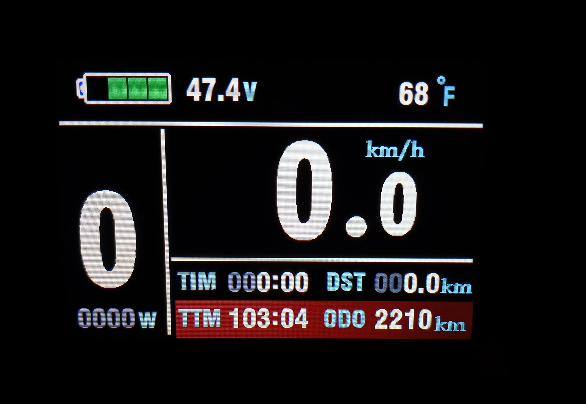

I can set up my display to use the bar graph as a percentage.
I choose not to.
I charge my battery to 54 volts and my controller will cut out at 42 volts under heavy load.
54V is 100% battery, 42V is 0% battery. It's simple.
I'll be installing this soon and that's all I need to see.

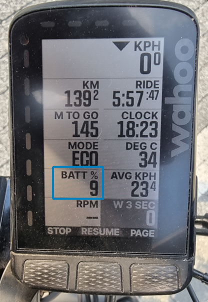

How long will your 9% remaining battery last and how far will it take you?
It all depends on how much power you draw.

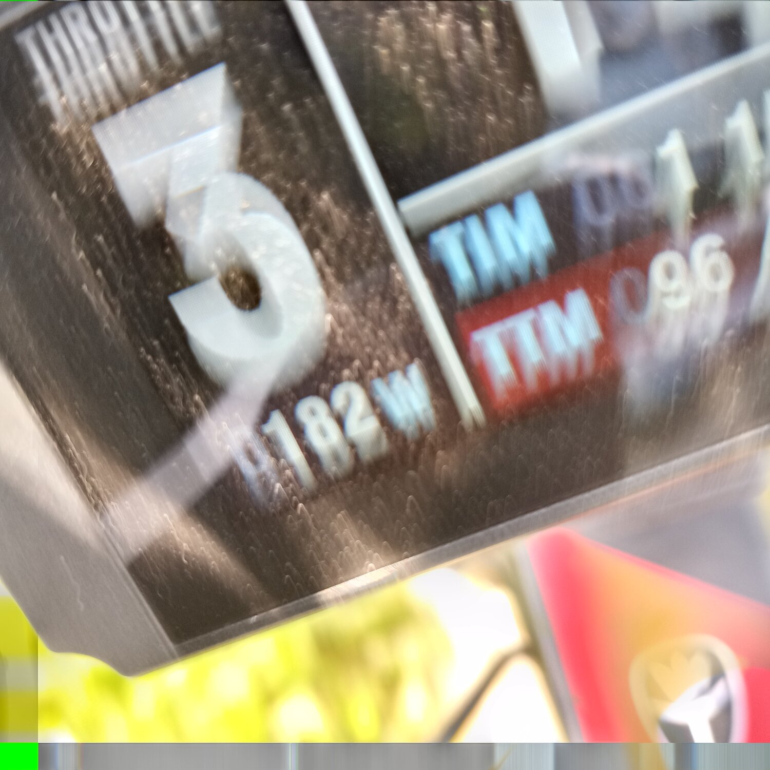

I was out for a ride yesterday going down this path,..
I had my cruise control set to about 18 kph, and I was using 182 Watts.
(It was pretty hard to snap a picture going down the rough trail.)

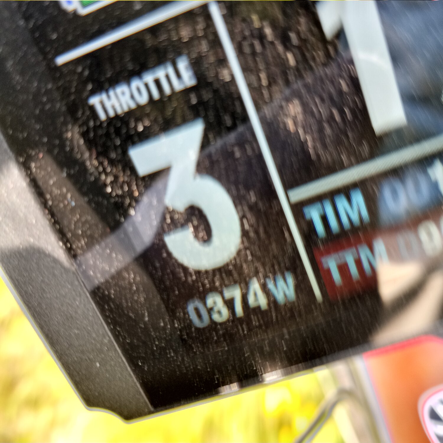

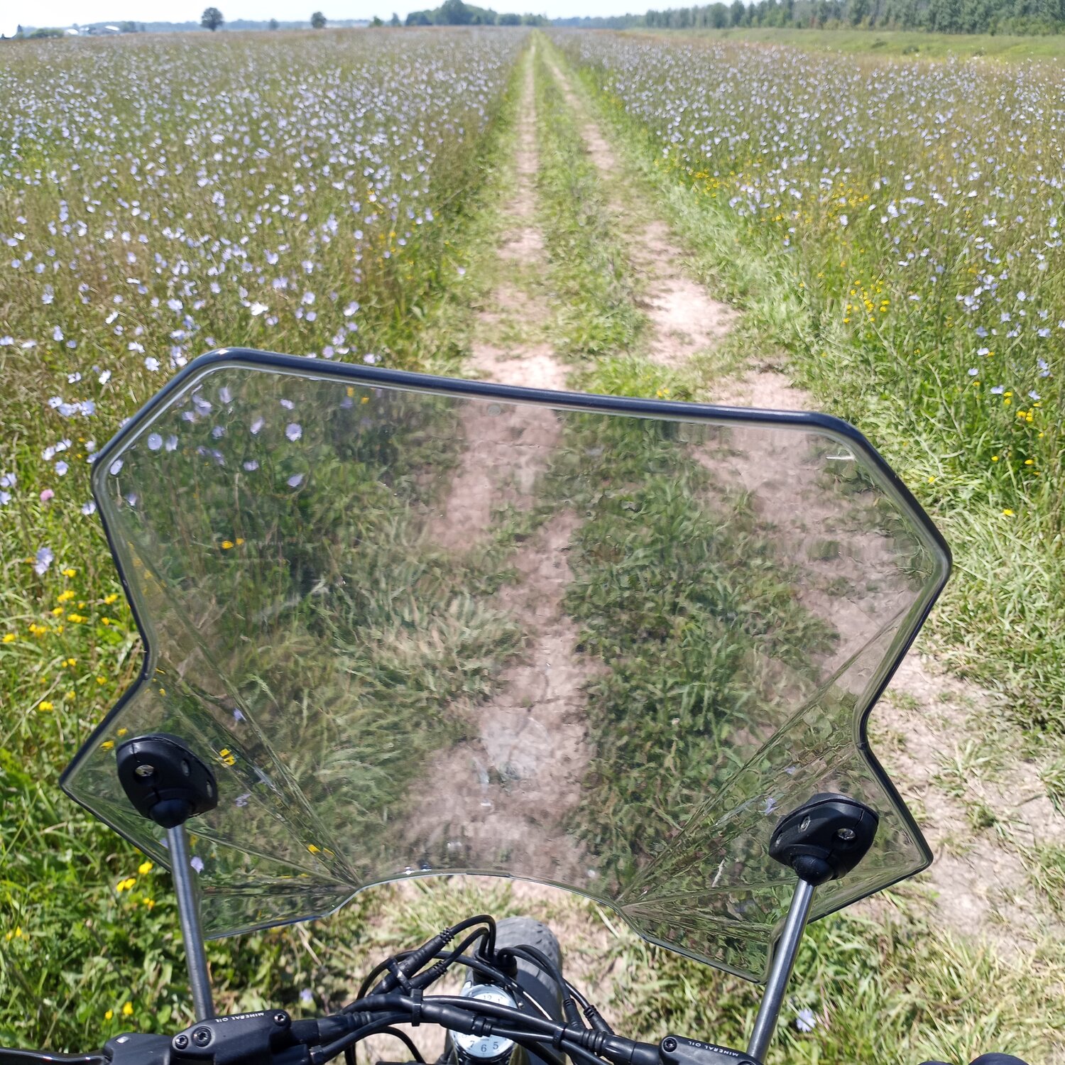

Then I went into the field traveling parallel to the path,..
I didn't touch the cruise control. All the conditions were exactly the same except for riding through the grass instead of the hard packed trail, but I was now using 374 Watts.
I was using more than twice as much power to roll over the grass than the hard packed trail.
Everything felt exactly the same, and it actually felt like riding through the grass was more efficient because it was a smoother ride.
That's why I like to watch my Watt meter in real time, it tells me how fast I'm draining the battery.
I could go twice as far on the path, and maybe 3 times as far on paved roads than if I did a trip through a field.

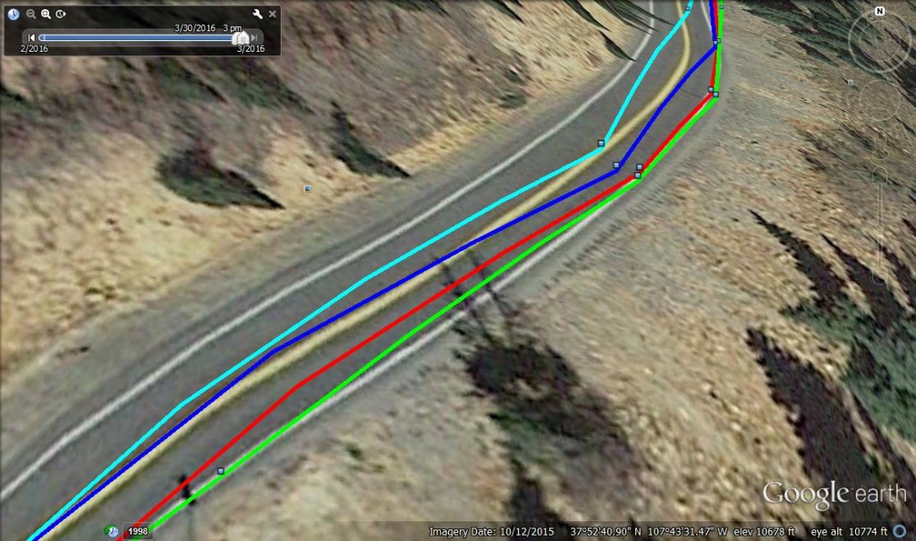

There are errors associated with both GPS and wheel circumference odometers. GPS measures the distance between acquisition points which are never in a straight line. The "snap to" or smoothing feature in many GPS receivers does help as @dodgeman stated above. At best, they are a series of straight lines which do not exactly follow the natural curves of a road or trail. This picture gives a visual representation of the effect:
The yellow center line of the road is the true distance measurement. The blue, red & green lines are GPS tracks made on four different trips along the road. The small squares are the acquisition points and the GPS distance is measured between them. It's easy to see why they don't match.
Wheel odometers rely on accurate circumference measurements based on the rolling radius of the wheel. This is very difficult to measure due to changes in surface conditions, tire pressure and rider position on the bike. You also have to take into consideration the minute distances added each time you turn the handlebars. No rider rides in a truly straight line.
Due to the difficulty in setting an accurate wheel circumference, I tend to agree with @dodgeman that, under most conditions, the GPS measurements are likely more accurate.

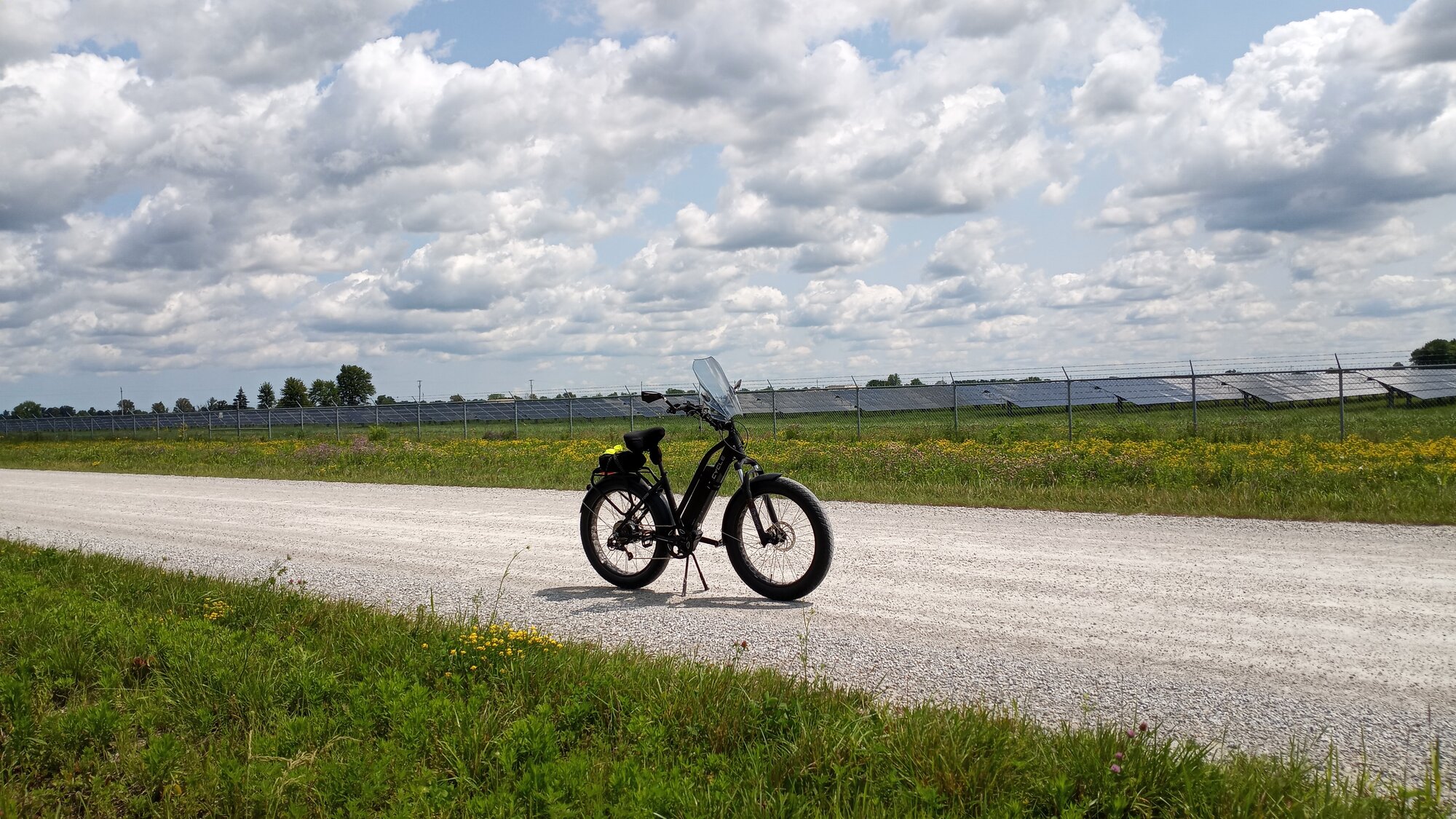

I have put over 2200 km on my ebike since April.
I have pedaled for less than 15 km of that.

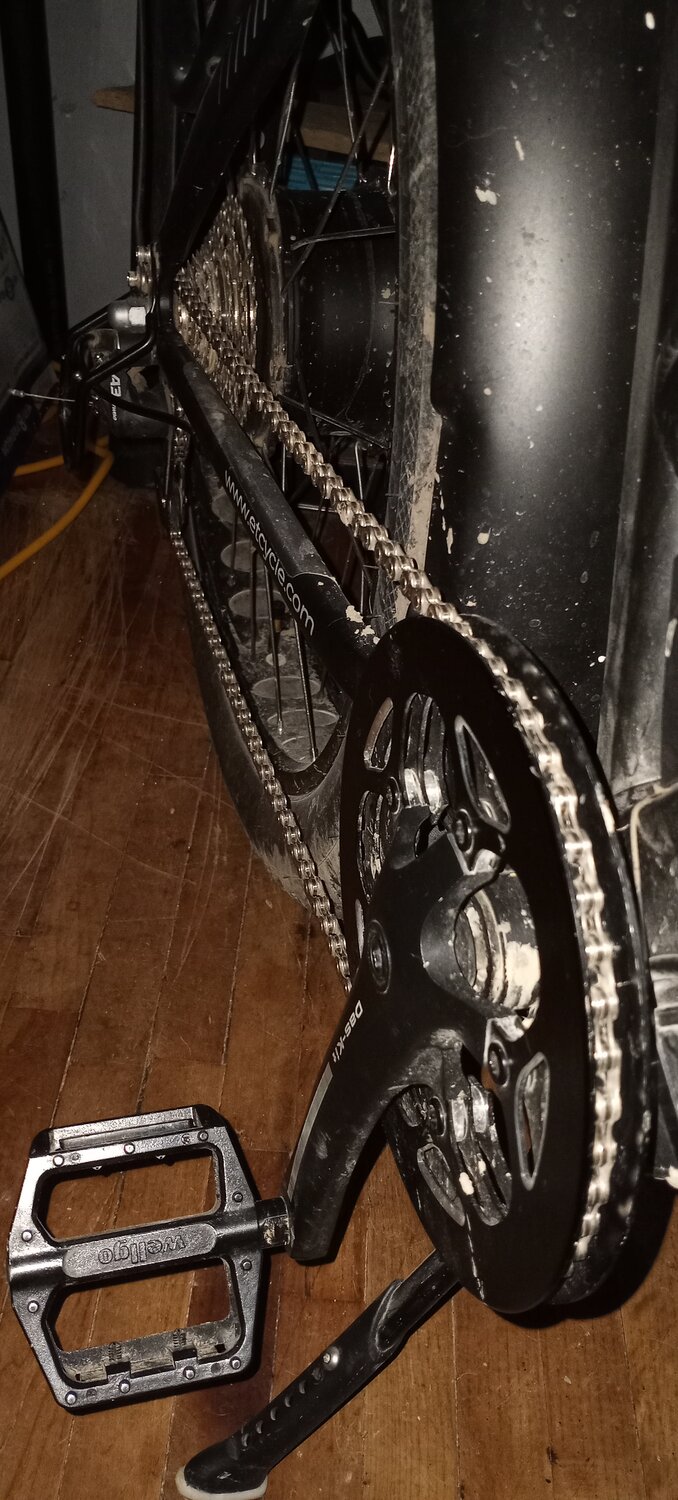

I have a fully functional pedal and crank system.
It's in brand new, pristine condition because I don't pedal. 😂
It will take me Fer Fukin ever to pedal along at 2 mph, but I will make it home.

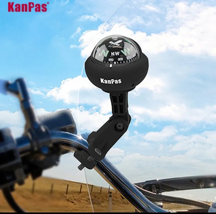

well… actually. i’m sure you know this (?) but your compass doesn’t actually need gravity, but it does need the earth’s magnetic field. or at least a magnetic field 😂
I can see the field through the forest without the need for batteries. 😂
