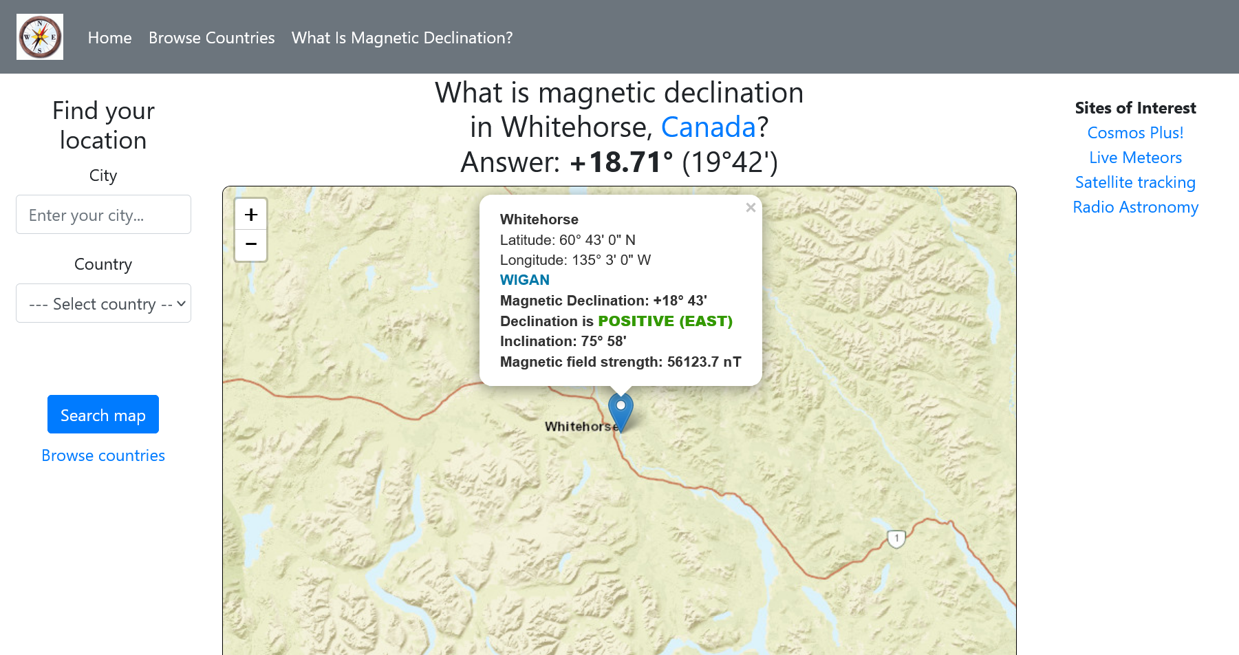

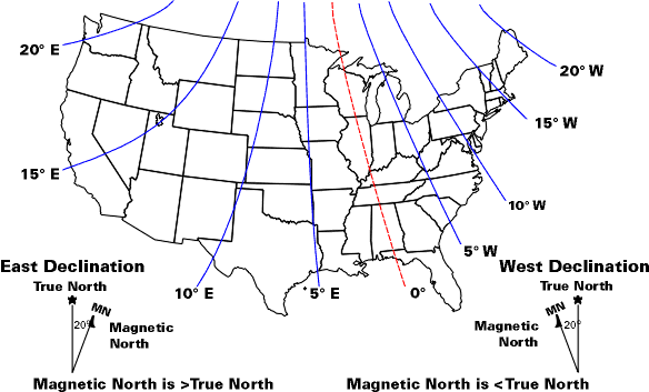

I like to install a compass in the kid's area of cargo bikes. I am working on one now. I also sometimes put a little propeller airplane and always a bell there. When I was in Whitehorse, Yukon I felt ill because of the almost straight down magnetism. I think that I am more sensitive than most. My first night in NZ they aske me to point North. I pointed South. Here in Nor Cal declination is between 15 and 20 degrees. Many property lines and roads and off by that much. So, North on a road is really NNE.
I am a retired land surveyor and have studied how they laid out the sections of ground, the one mile square parcels of ground, in Illinois. They used a compass for a lot of it and tried to take the declination into account. They used a compass in Illinois along with a chain 33 feet long. By todays standard the accuracy was pretty weak , often with an error of 1 foot for every 100 feet they measured, sometimes worse. Generally there was pretty consistent except where there were areas of a local magnetic attraction, like in the northwest part of Illinois near Galena. They had no way of knowing everything was out of whack as they measured.

I've taught some orienteering classes and have seen people use the wrong end of the compass needle. It is also very possible to get the polarity on declination wrong.
