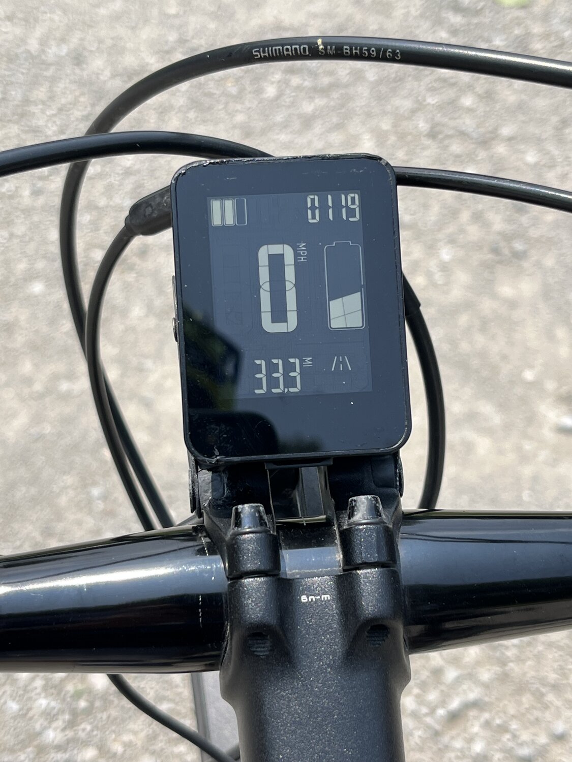

It seems every Ebike I have owned in is 5%+ optimistic vs the app I use. I’ll take the 33.3. 😅

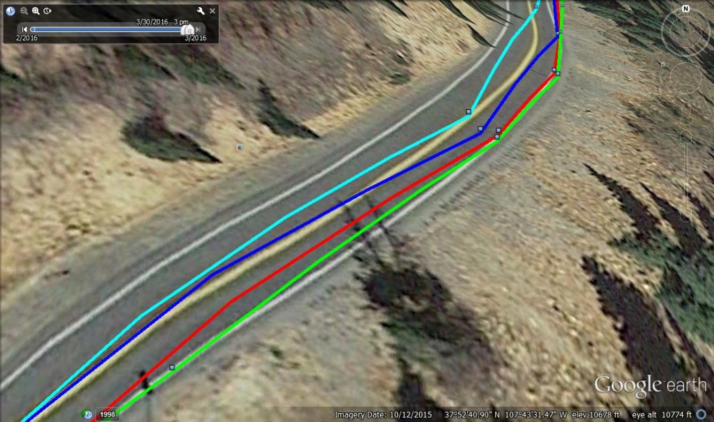

There are errors associated with both GPS and wheel circumference odometers. GPS measures the distance between acquisition points which are never in a straight line. The "snap to" or smoothing feature in many GPS receivers does help as @dodgeman stated above. At best, they are a series of straight lines which do not exactly follow the natural curves of a road or trail. This picture gives a visual representation of the effect:
The yellow center line of the road is the true distance measurement. The blue, red & green lines are GPS tracks made on four different trips along the road. The small squares are the acquisition points and the GPS distance is measured between them. It's easy to see why they don't match.
Wheel odometers rely on accurate circumference measurements based on the rolling radius of the wheel. This is very difficult to measure due to changes in surface conditions, tire pressure and rider position on the bike. You also have to take into consideration the minute distances added each time you turn the handlebars. No rider rides in a truly straight line.
Due to the difficulty in setting an accurate wheel circumference, I tend to agree with @dodgeman that, under most conditions, the GPS measurements are likely more accurate.

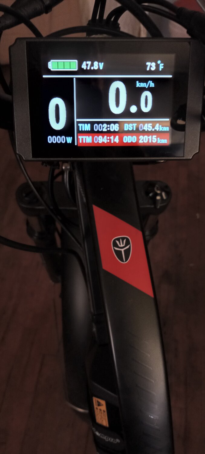

I downloaded a GPS Speedometer app to my android phone and used it to calibrate my speedometer/odometer.
My hub motor is a mystery and I don't know the gear ratio or how many magnets it has, so I can't enter those parameters to set the calibration.
I rode down a perfectly flat straight road (easy to find around here) at full speed (32 kph) and adjusted my settings until the speeds matched.
I set my speedometer to read 33 kph when I was going 32 kph to keep me on the happy side of the law, then I deleted the app.
As soon as I go over 32 kph I'm risking $5000 in fines.
I broke the law today.
I was going 34.7 kph with a tailwind.
I'm a Hard Core Bad Ass. 😂
I rode 45.4 km today.
It may have actually been 45 or 46 km.
Close enough for me, as long as I don't run out of battery.
