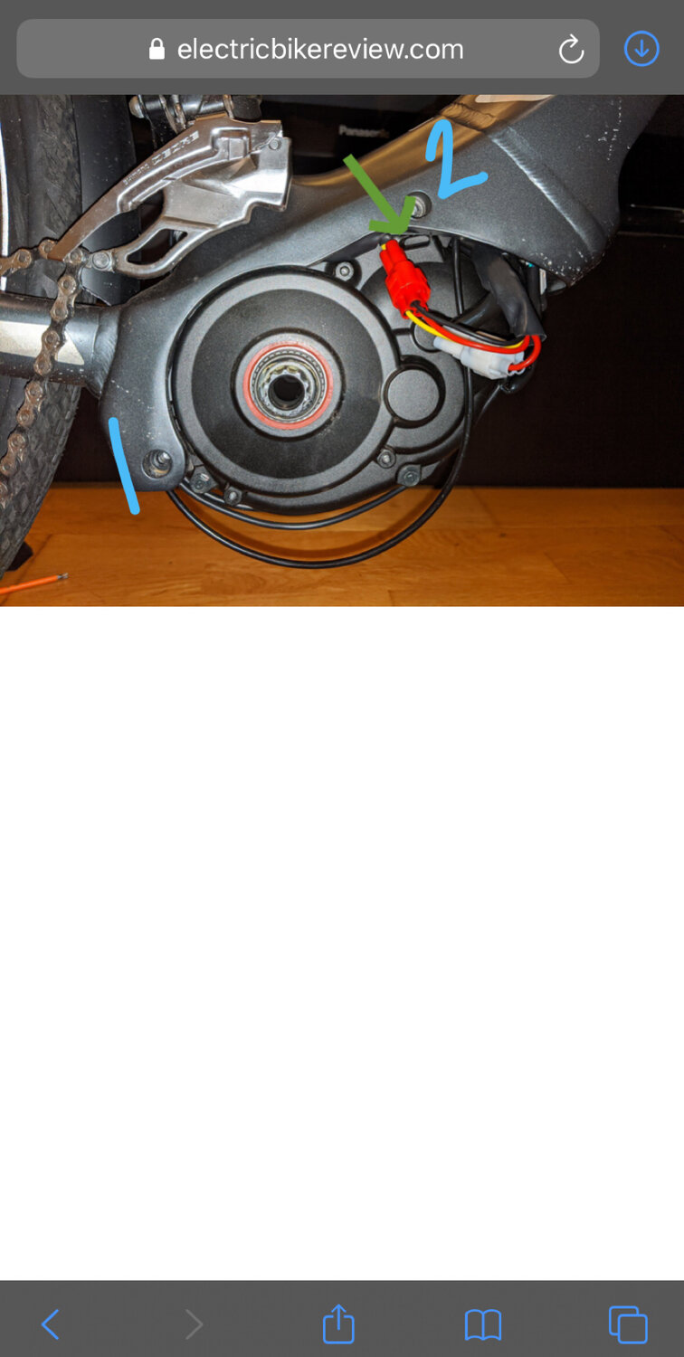

There are 2 bolts each side , 2 short bolts on the crank side and 2 long on the other side , what ones do I undo ? And then where do I apply pressure
You need to completely remove the crank (8mm hex bolt + crank puller tool + spider), remove the bottom and right side cover, and then unscrew the motor. Only then are you able to pivot the motor to expose the wiring.
So do I take bolt number 1 and 2 out completely on both sides? And is there a third one? If not can you explain please mate it’s my pride and joy don’t wanna force it and realise it’s got another bolt in
No, actually bolt number 1 you just loosen but don't remove (it's removed on the pic because I was myself experimenting, being unsure how to pivot the motor)
Bolt number 2 you need to completely remove from both sides (left and right), yes
There isn't a third one as far as I remember. That's what confused me because on the videos I saw there were 3 bolts, but it was older versions of the bike.
And you don't need to touch the charging port
