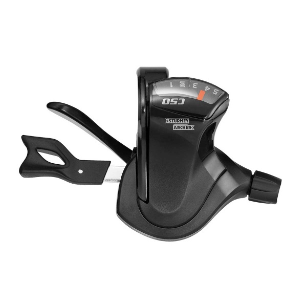

I thought about switching out to this: DLC50
