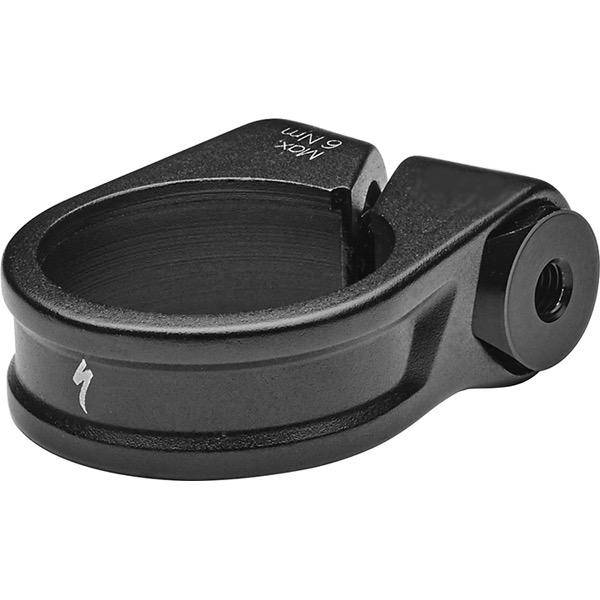

Hello, I would like to put a carrier on my Turbo Creo Expert. I see that there is a special clamp for the seatpost with two nuts to screw the carrier, but I cannot find the appropriate measure. The normal clamp has a diameter of 30.8 mm and on Specialized's page I only find 29.8, 31.6, 31.8, 32.6 and 34.9 mm.
Does anyone know a solution?
Why don't you ask your dealer? Or just use a caliper and measure the seat tube yourself?
Thanks.
Best advice given was to ask your dealer. I've used the support page to double check the dealer.
The support page with replacement parts, lists a S184700001 STC MY18 DIVERGE SEAT CLAMP WITH RACK MOUNT 30.6.
The amaincycling page lists it as compatible with a Creo
This site in EU lists it as well:
