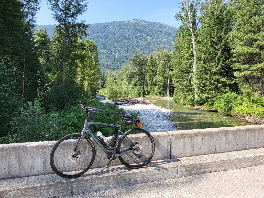

Am I to assume that no brake lines were disconnected? What size is your bike frame? Did you get the larger case to be safer? Any pictures of YOUR bike in the case?Just home from two weeks in PNW islands that included Victoria, Sydney, San Juan, Salt Spring, Whidbey, Lopez, Port Angeles, Port Townsend and Squim. Rode with no main battery but with one or two range extenders in my bottle cages. Assembly was different to some degree than a coupled S&S travel bike due to Future Shock concerns when removing fork and dealing with hydro brakes, but a little practice before made it no more challenging than my S&S. I did remove the Future Shock and replaced it with a rigid dummy available on ebay.
Rigid Future Shock Replacement Roubaix, Sirrus, Diverge (Version 1.0,1.5,2.0) | eBay
A top cap with an M6 bolt is needed for the top (included) and if a lower stem position is used, the part can be cut to length and a normal star nut and top cap can be used. Part weight with the top cap and bolt is 110g, 239g less than a Future Shock 2.0.www.ebay.com

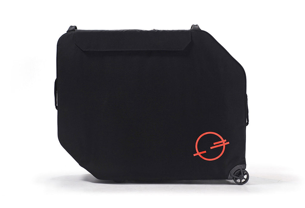

You can get a lot o crap in a 150 liter Post Case and the design seems to work well.
A little wobbly when full and dealing with a crammed SeaTac Airport zoo but the case has a bunch of handles for pulling/carrying and well-done protection within the case and extra tube protection pads included.![]()
Transfer Case
The Transfer Case is a compact travel case for your full-sized road or gravel bike. There are two sizes available, fitting bikes up to 62cm, and it's fully protective for travel. Its small size can avoid airline fees and help you maneuver easily at your destination. Bring your bike to every...postcarry.co
TSA did not bat an eye at the two extenders in my carry on day pack and on Alaska Air the Post Transfer went at the normal bag price of $35.
Rode with the motor on a lot and averaged about 30-35 miles and 2000 feet before an extender pooped out. Takes 2 minutes to change from one battery to another. A wonderful way to do a tour at my age...or any.
My Creo is an XL Expert model. I did get the larger 150 liter case not to be safer but I measured and it would not have fit in the smaller case. I did not have to disconnect the brake lines but I did do that on the way home with these gadgets from Taiwan. If you decide to buy the quick couplers from Taiwan make sure you order extra coupler clips as they could be really easy to lose.Am I to assume that no brake lines were disconnected? What size is your bike frame? Did you get the larger case to be safer? Any pictures of YOUR bike in the case?
It sounds as if our State was most welcoming for this grand adventure. Some very nice hilly terrain as well as level cruising in the mix. And the ferries were reliable for a change!!! If I might seek some clarification - what was the reason to remove the future shock? Just to simplify pulling out the fork?Just home from two weeks in PNW islands that included Victoria, Sydney, San Juan, Salt Spring, Whidbey, Lopez, Port Angeles, Port Townsend and Squim. Rode with no main battery but with one or two range extenders in my bottle cages. Assembly was different to some degree than a coupled S&S travel bike due to Future Shock concerns when removing fork and dealing with hydro brakes, but a little practice before made it no more challenging than my S&S. I did remove the Future Shock and replaced it with a rigid dummy available on ebay.

Yes. I thought the knob on top with its tiny set screw would just be something to lose. And the funny stem I am now using would not install with the Future Shock in the bike but works well with the dummy unit from ebay. And the dummy unit simplifies the process to some degree. Gotta say the clamp that holds the fork and shock in the bike is really fiddly too and you must get the centering screw lined up with the hole in the carbon fork steerer or you risk damaging the steerer.It sounds as if our State was most welcoming for this grand adventure. Some very nice hilly terrain as well as level cruising in the mix. And the ferries were reliable for a change!!! If I might seek some clarification - what was the reason to remove the future shock? Just to simplify pulling out the fork?
