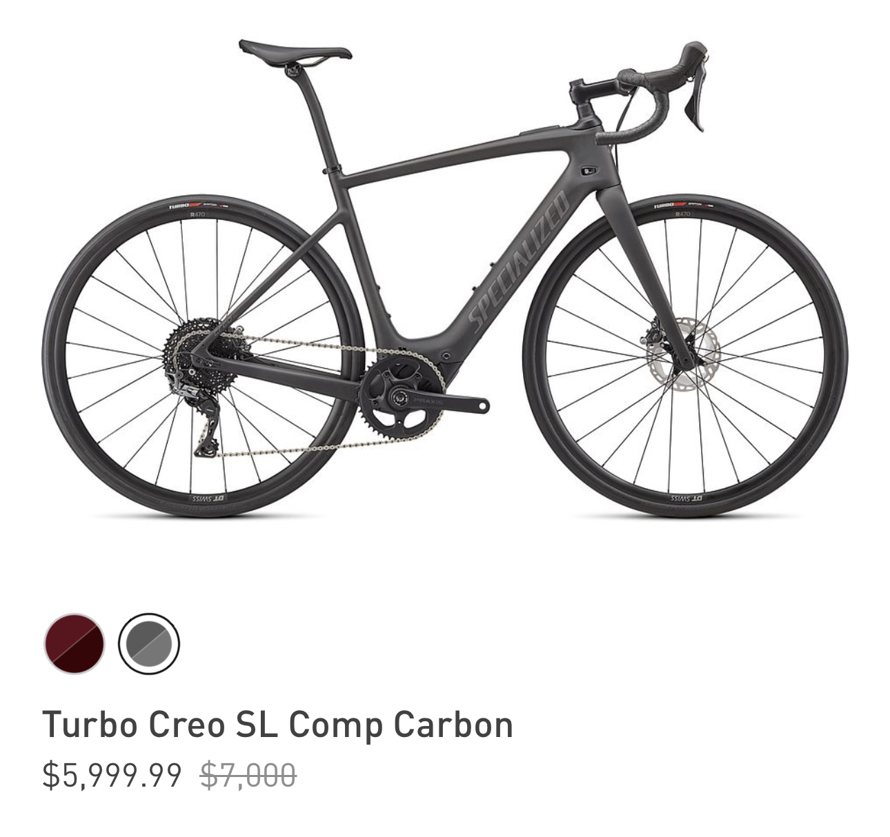

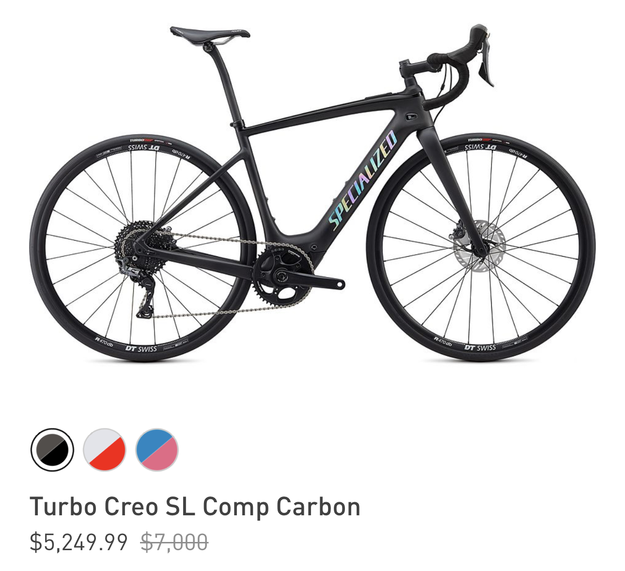

Hey folks. With the current sale I'm thinking about adding a Creo to the stable, purposed primarily for gravel (forest service & rural dirt roads) as well as "light utility" in that I may add a lightweight MIK compatible rack for a trunk bag when I may need such. I'll use my Vado 4.0 for any heavy shopping/stuff.
Now down to deciding between E5 and Comp Carbon.

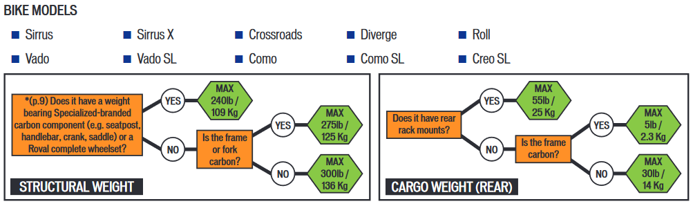

- Creo manual references "do not exceed the cargo weight limits stated in the Owner's Manual Appendix A" yet the Specialized Bicycle Owners Manual doesn't seem to have that part. Anyone find any numbers?
