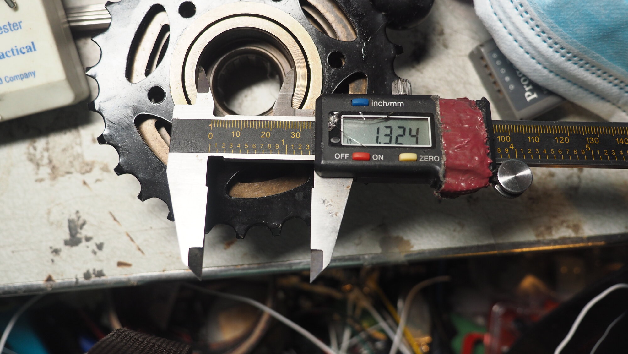

This sounds wrong. Whatever spacer you put over axle does not contact the inside of the freewheel. All of the freewheel must be able to rotate freely. There is a shelf on the axle a where the threads stop, upon which your spacer will rest. You're not looking for a washer with 3/4" inner hole. You're looking for one with a 12 mm inner hole to fit the axle, and it has to be narrow enough not to contact the any part of freewheel
Here's two different freewheels. One has a 1.25 inch cavity and the other has none.It's a common problem when they don't give you the right spacers. For the one on the left, I had to file down a 12 mm washer until it would fit on the axle without hitting the freewheel. That was last summer, and I had the same problem, Tighten down the hex axle nuts and the washer was spread out and hit. I got it right finally.
In conclusion, you may need a spacer under the freewheel so it can freewheel And you always need one on the top so the freewheel doesn't touch the frame..
