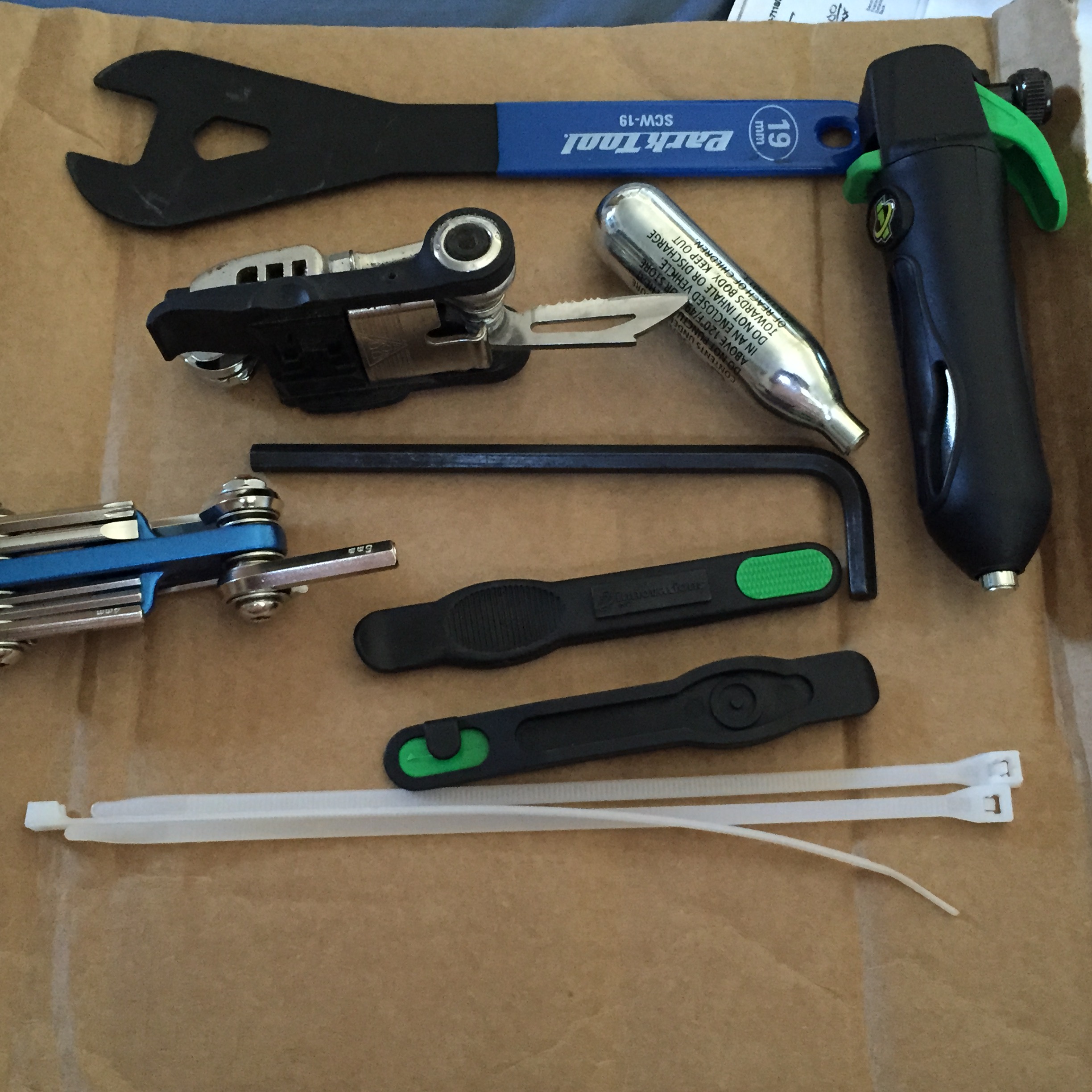

Went 1000 miles on a ST1 and no flats, then got 2 flats in less than 100 miles, both on the rear tire. Put together a kit and practiced removal of the rear tire so hopefully now I can address on the road.
  • 19mm wrench to remove rear tire
  • tire levers (optional)
  • 5mm hex for removal front tire (maybe 6mm)
  • Knife to remove 2 zip ties that secure rear wheel hub wires
  • spare tube and/or patch kit
  • air source
  • zip ties to secure rear wheel hub wires to frame (believe me, you don't want those ripping out while riding or changing wheel)
  • phillips head screwdriver. If you plan to turn the bike upside down to change the rear wheel, you may want to loosen ST1 display to swing it out of the way so it does not get all scratched up.
Along with the nuts and 2 locking washers on each side, on the brake side of the rear wheel there is a spacing washer that covers the rear hub wires. On the drive train side, there is a short sleeve that inserts over the bold and into cassette. Both the spacing washer and sleeve can easily fall off the wheel so be sure not to loose those.
