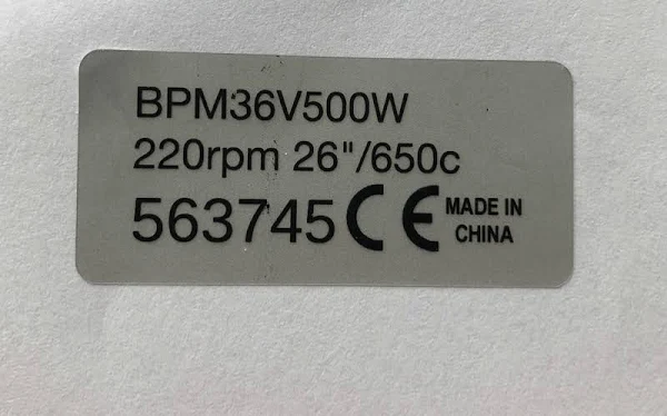

You can buy wattage stickers on eBay, just put one on your motor and the problem is solved.
The enforcement by "stickers" is one of the reason I am so negative towards the 3-class regulatory system pushed by People for Bikes. They were too focused on getting the auto industry lobby money that they failed to really comprehend how bad the regulatory draft they were likely provided was poorly conceived and written.
I know someone that bought a very expensive class 3 ebike and the sticker peeled off in less than a month. What a great system and yet plenty of members on EBR praise it but my guess is they have other motivations besides wanting good regulation of ebikes.
