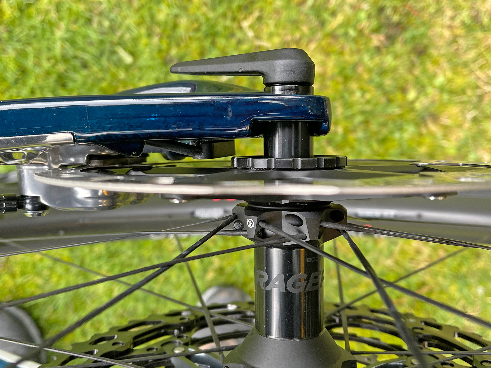

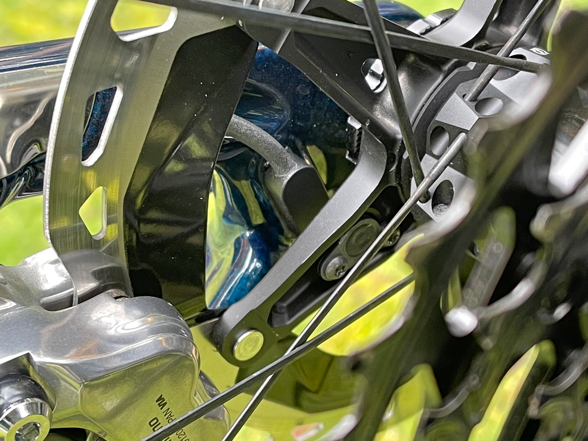

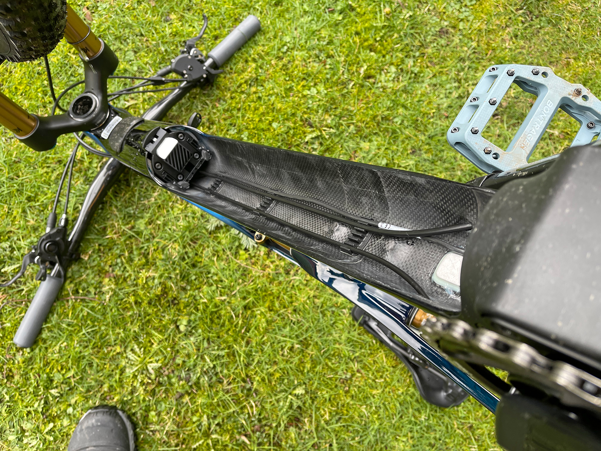

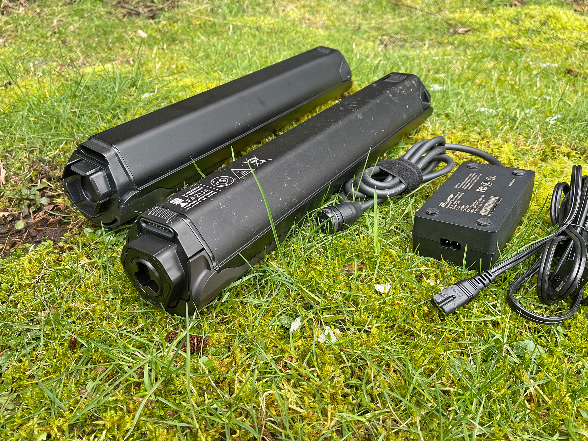

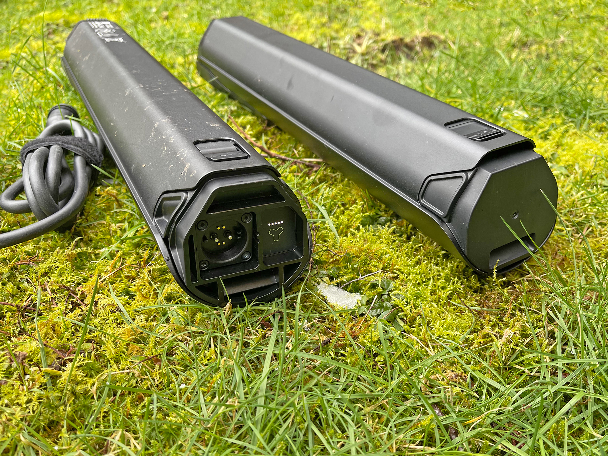

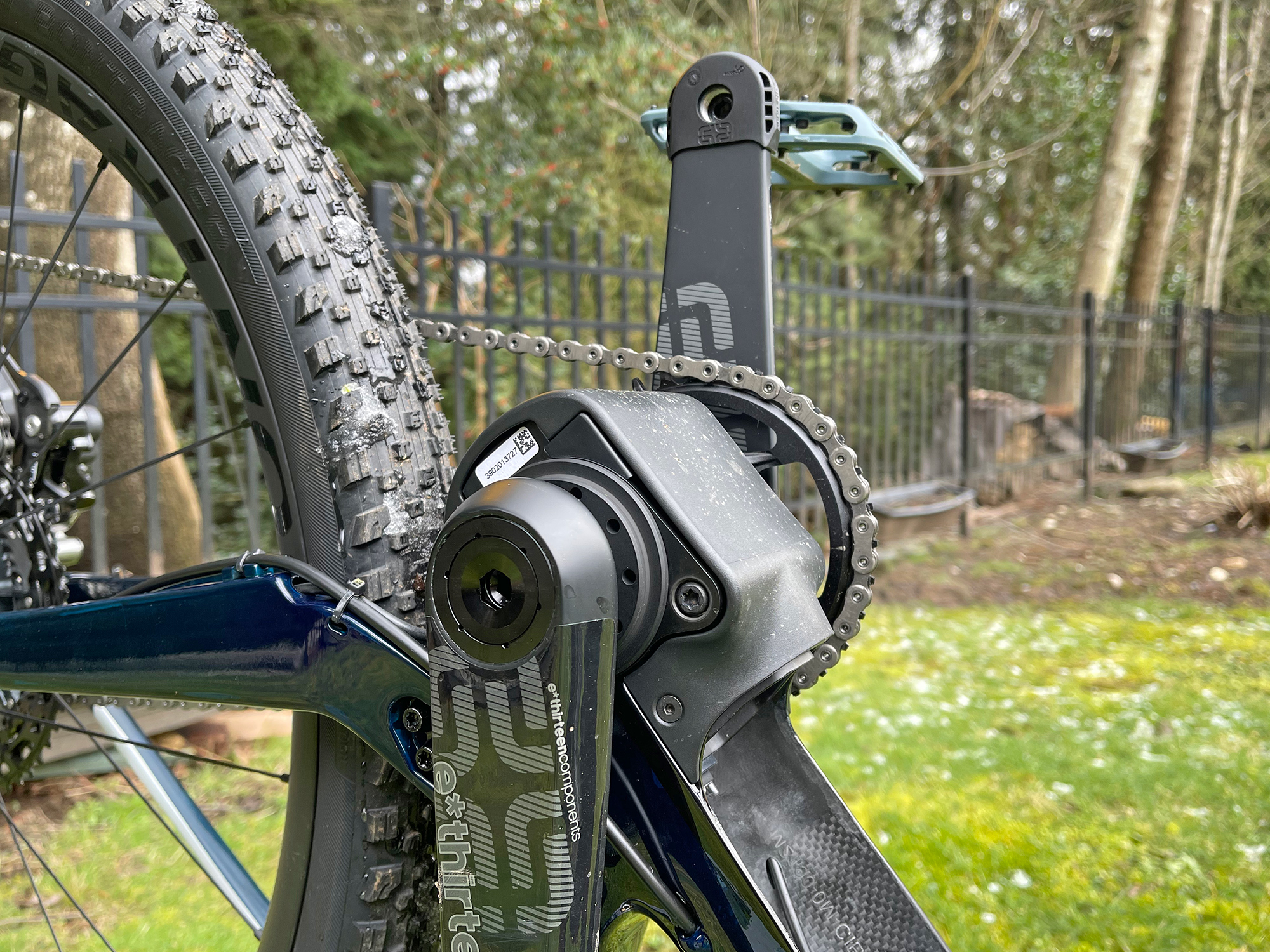

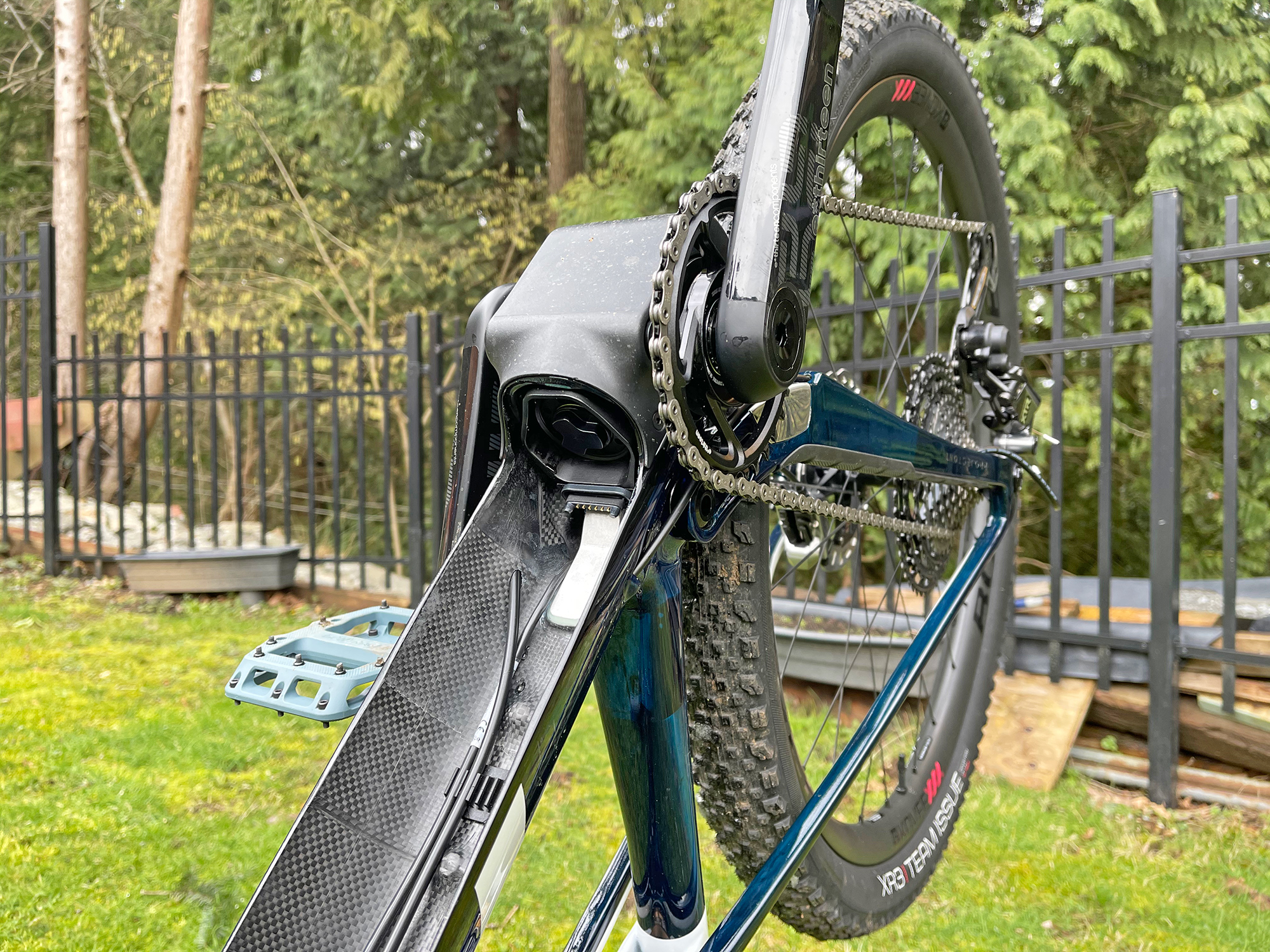

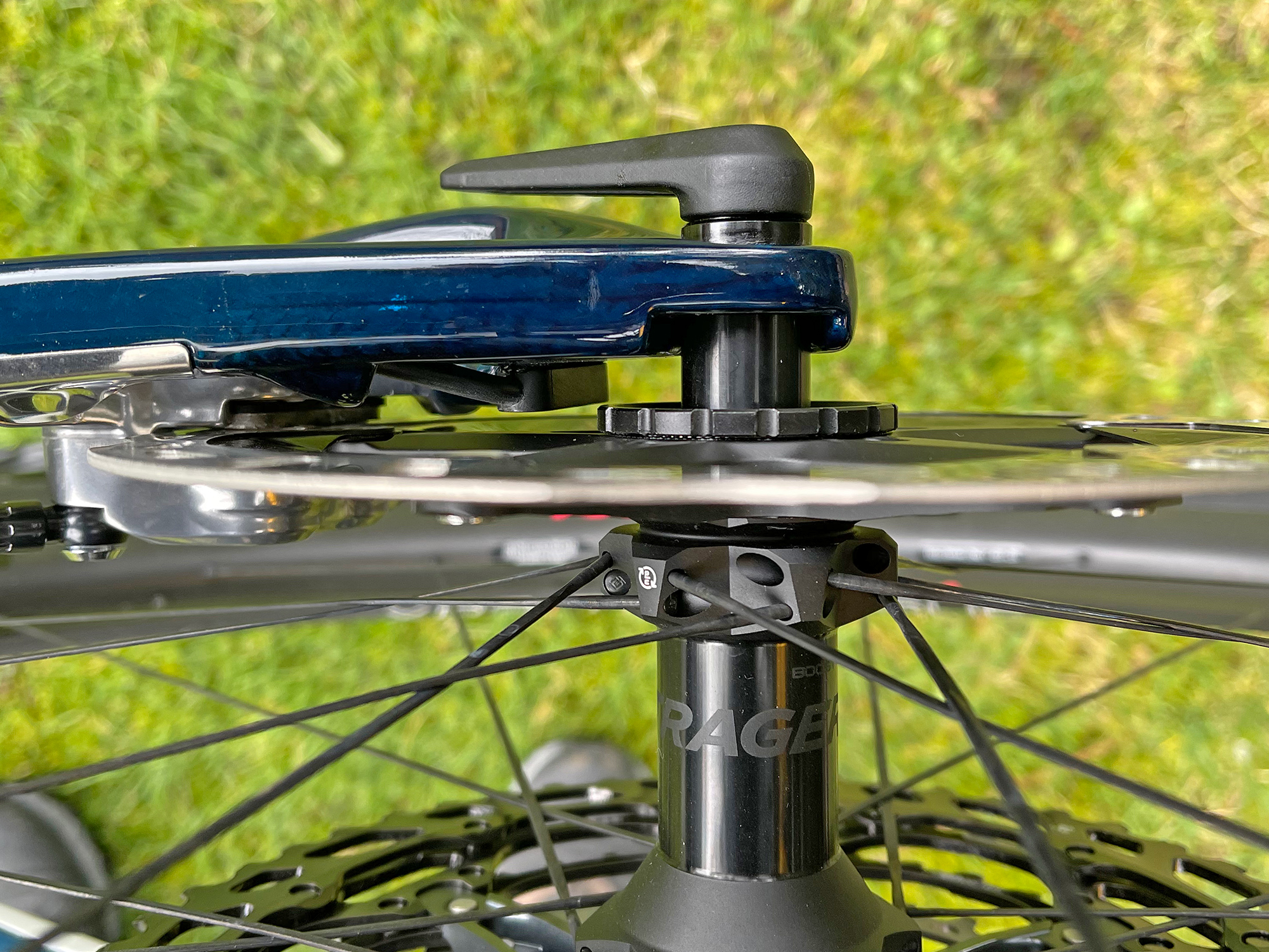

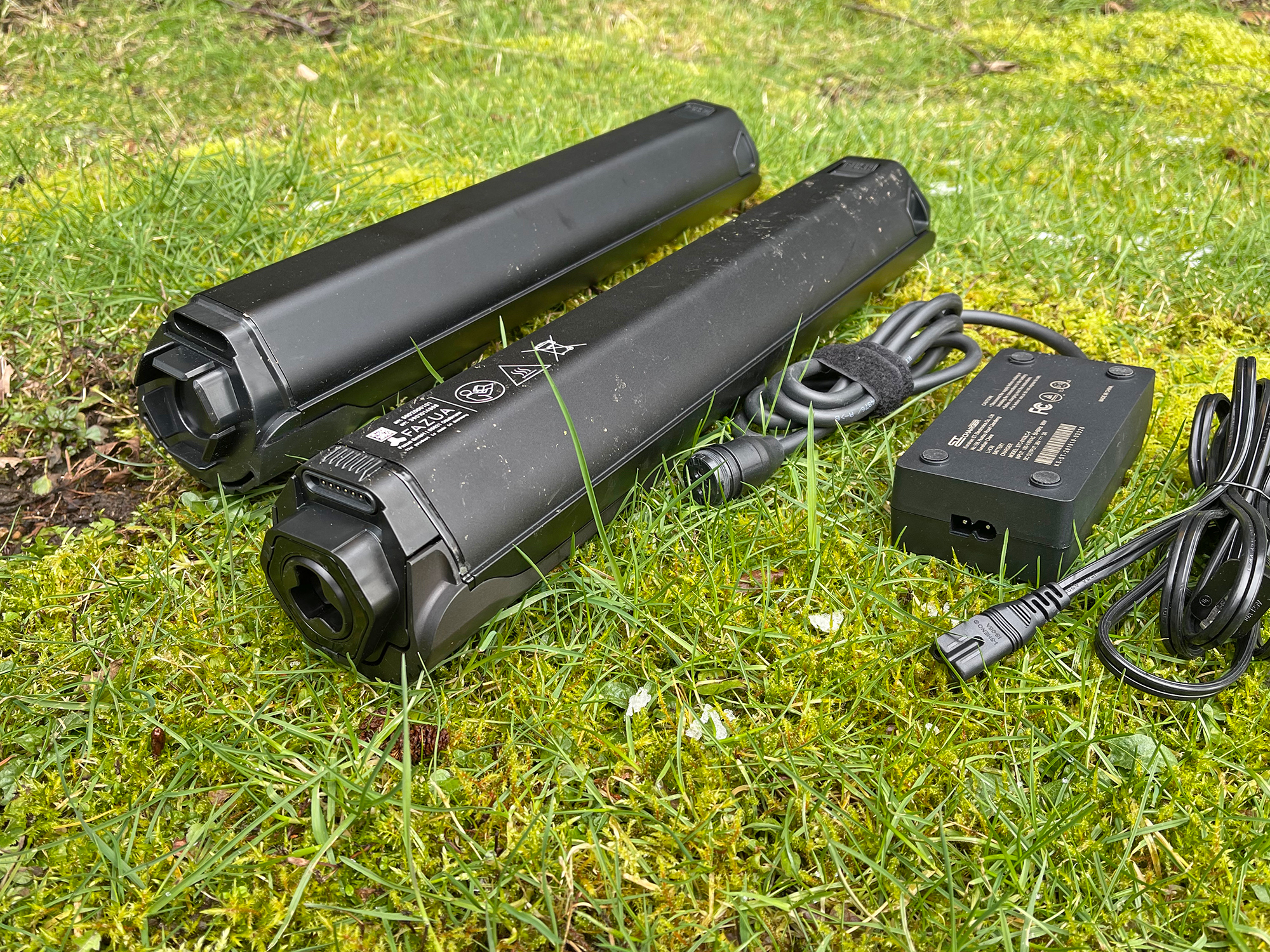

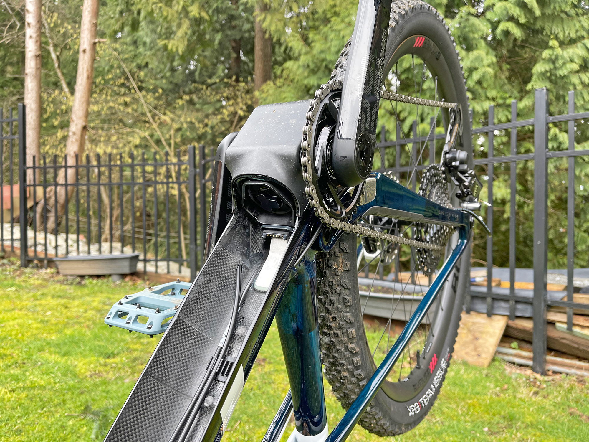

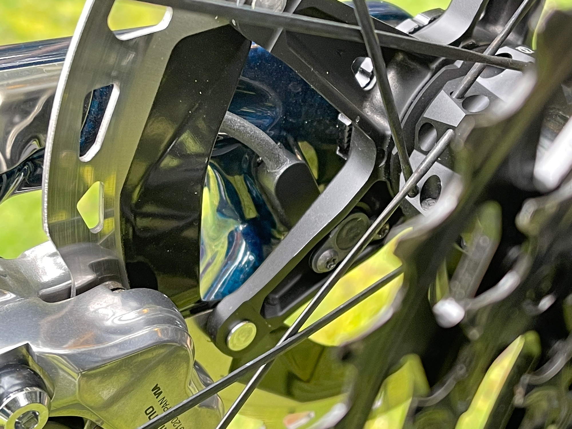

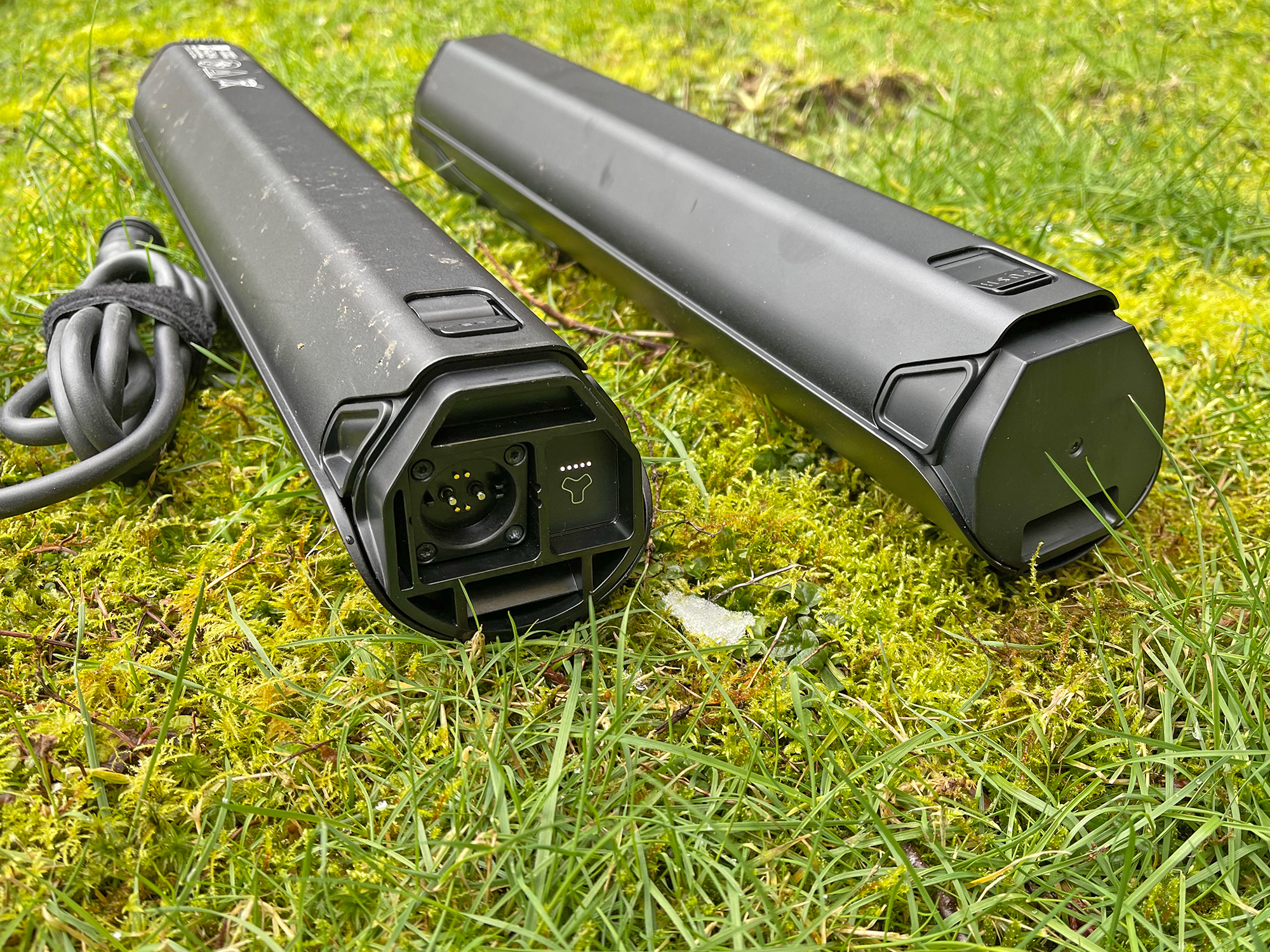

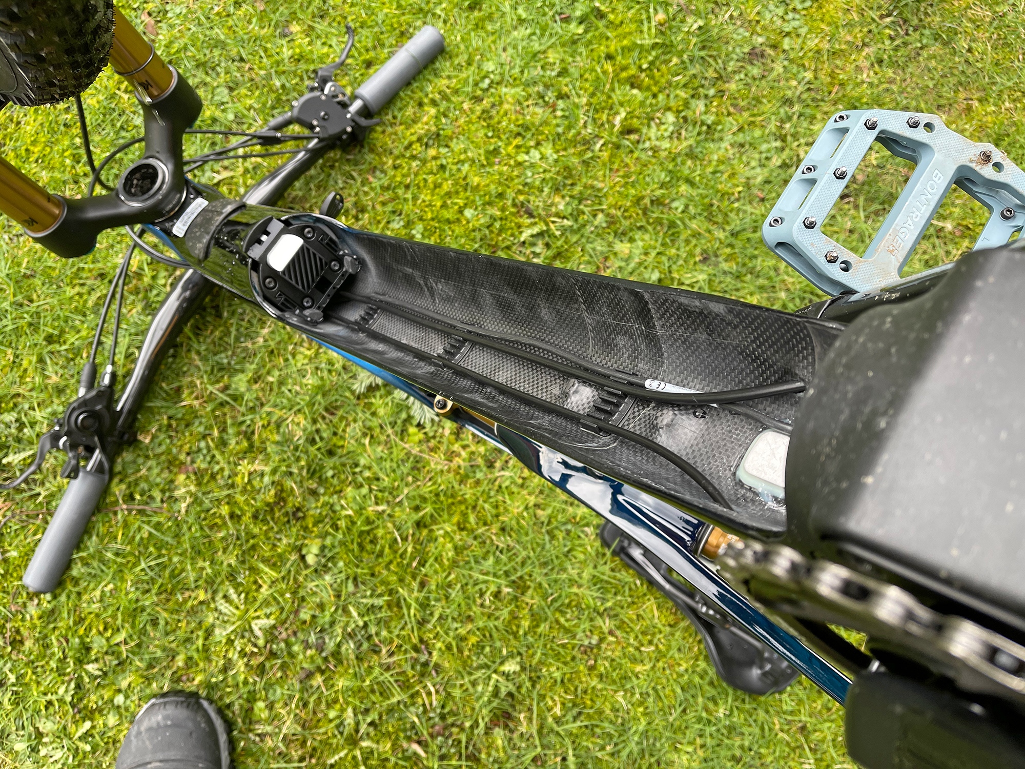

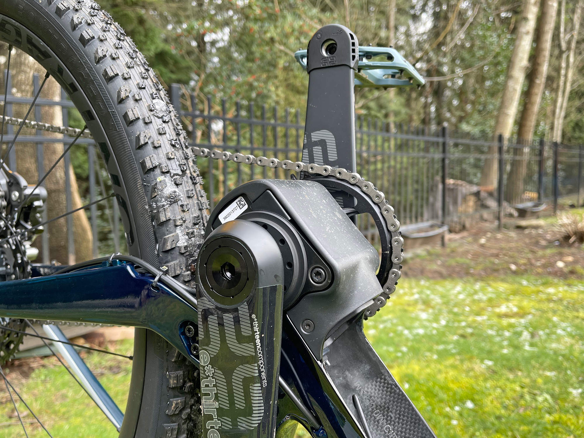

Hi guys! I wanted to create an updated review of the Fazua Evation mid-drive system since I got to spend some time with the new Trek E-Caliber recently. Fazua launched a software update for their ebike mid-drive system recently called Black Pepper which improves motor power output and maximum cadence support. I got to check it out on a Trek E-Caliber electric mountain bike and put this shorter focused video together to highlight some of the upgrades and show its performance.
fazua-evation-bottom-bracket-transmission-downtube.jpgfazua-evation-empty-downtube-bay-for-drivepack-insertion.jpgfazua-evation-non-drivetrain-side-of-bottom-bracket-cadence-sensor.jpgfazua-evation-drivepack-and-hollow-downtube-protector-storage-container.jpgfazua-evation-drivepack-rosenberger-charging-port-250x-battery.jpgfazua-evation-speed-sensor-and-magnet-mount.jpgfazua-evation-rear-wheel-speed-sensor.jpg
Motor: Fazua Evation
Software: Black Pepper
Power output: 300 to 450 watts
Torque output: 55 newton meters
Battery capacity: 252 watt hours (36 volt 7 amp hours)
Optional: Bluetooth Low Energy (BLE) for GPS and heart rate monitors
Optional: iOS and Android smartphone app (Fazua Rider)
Weight: 2.88lb bottom bracket transmission, 4.2lb empty drivepack motor, 3.2lb battery pack, 7.4lb combined drivepack (with battery inserted), 1.2lb optional empty downtube container
I'm not sure if the older versions of the drive system can be updated to the Black Pepper software, but I hope to get some answers from the Fazua team soon. If you have any questions, please let me know here! I'm also attaching some press materials they shared with me :)

A 252 wh pack it’s a ridiculously small capacity, no mater how light the ebike is . Maybe under 22lb it is worth it. There is also the battery cost $$$$$.
With 20% deterioration it will be a 200wh pack actually 160WH usable. Don’t use the last 20% b/c we’ve learned many lessons here on Ebr why....
So. 200WH USABLE Capacity for a NEW battery, 160WH after 4-500cycles maybe less. I know better not to fall for this gimmick😂
Q- How much is a brand new battery ? I bet it’s at least 400$. For 20cells in the pack...1 cell is roughly 3$. This is some serious bs.
Trek should have requested better engineering from Fazua. Specialized
can design their own motors like the 1.1 / 2.1 , why Trek doesn’t make their own motors and relies on others ? It will make them an even stronger brand.
Wow 500$ for a 252wh pack. 16-18cells , 2-3$/cell @retail . Professional bs pos GmbH indeed...
