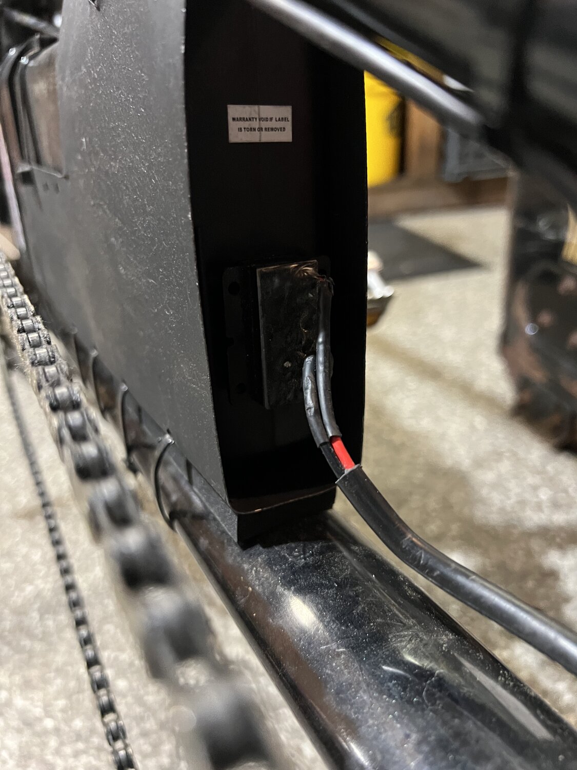

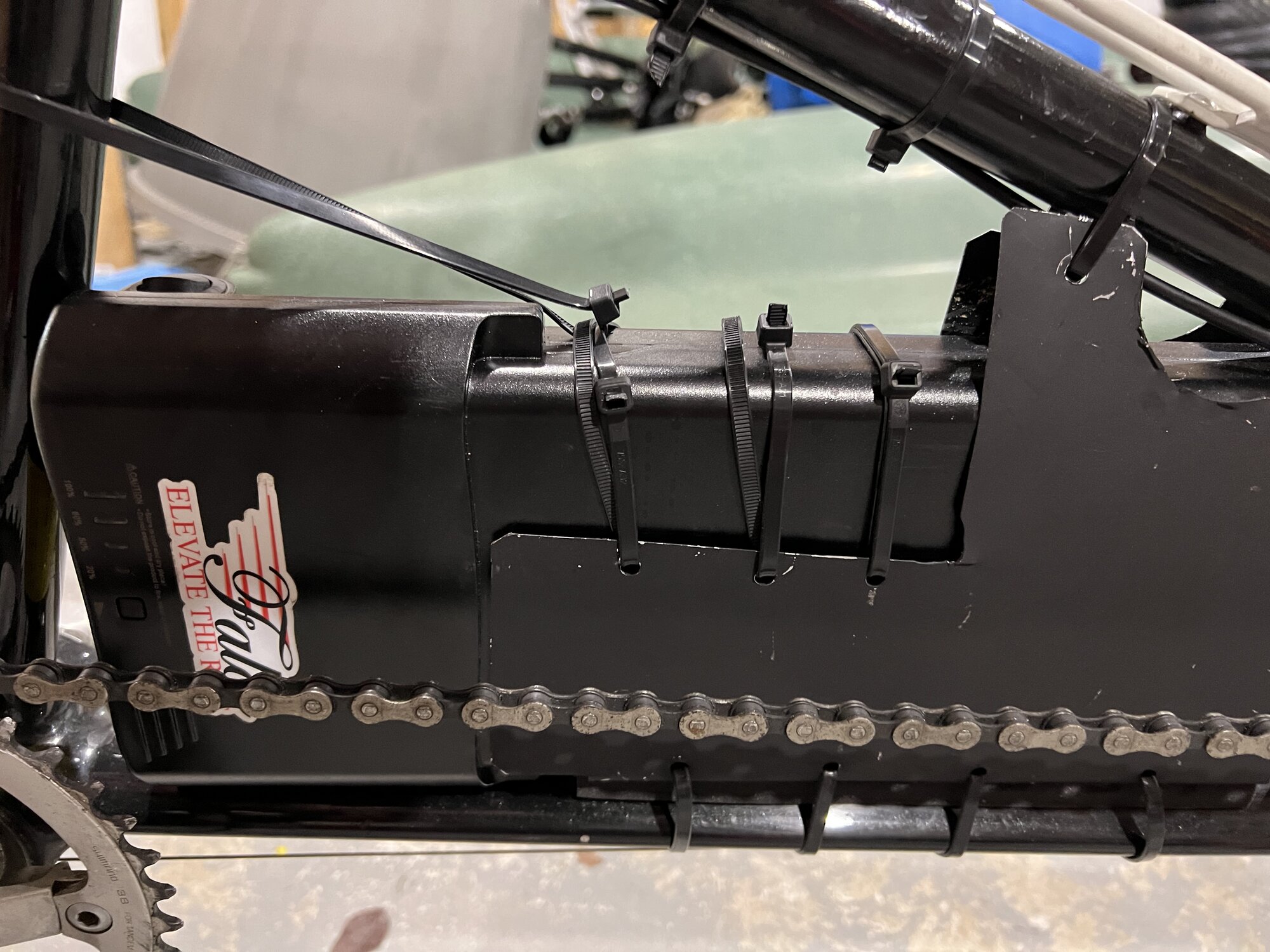

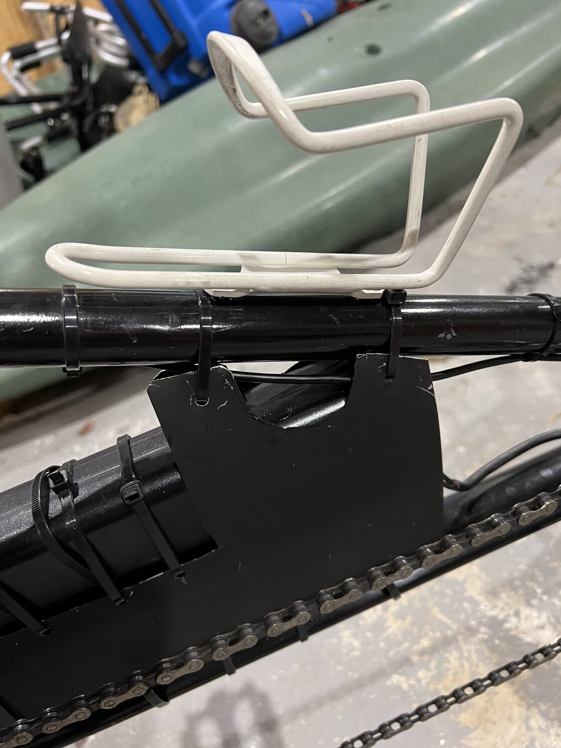

Hi folks my wife and I are Santana tandem riders. We Falco ed last year and have 470 miles. Trouble free till now. I am experiencing intermittent operation of the system. The motor and the display cut out randomly and either won’t restart or reluctantly restarts.
I have hard mounted the battery on the bottom tube of the bike. I have had some luck jiggling the two pin power connector which seems to be the issue. I replaced that and am worried I haven’t found the problem. Could it be the controller on the handlebar?
Any suggestions?

That doesn't look like any battery connector I am familiar with.
