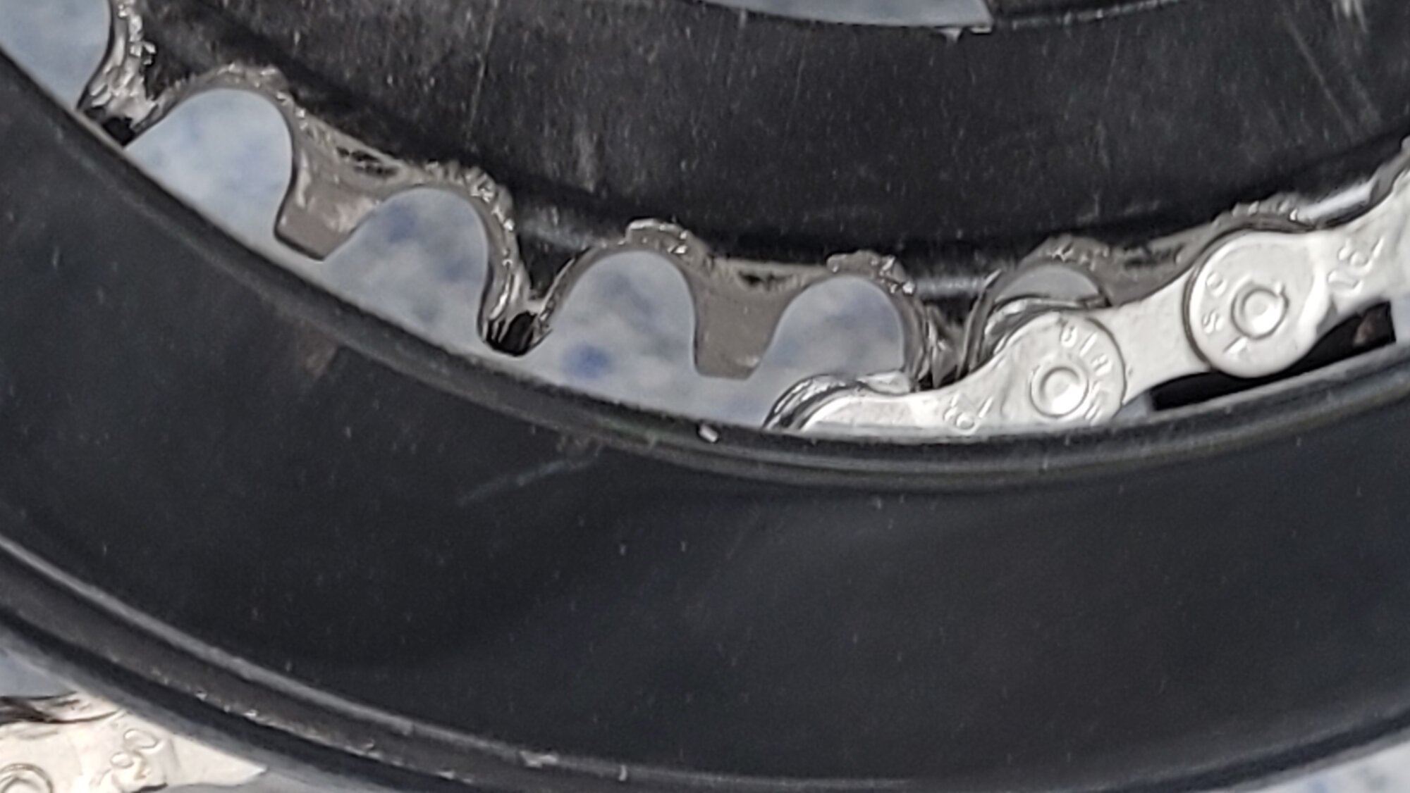

Thanks for your help, as always. Going with the SRAM EX1 chain and Shimano XT 10-speed derailleur and casette — the latter mainly because I could really use the lower 1st gear it provides. Since the aluminum Deckas 38t chainring below is already showing wear, replacing that with a Raceface while we're at it.That really does sum up the situation rather well. @Jeremy McCreary your parts suck so your results will too. There's just no fixing that other than replacing it....

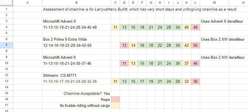

If I were redoing your drivetrain, I would first try Microshift.... Shimano would be my last choice. Not because its bad but because others are better. No matter what you pick, use the SRAM EX1 chain which is an ebike strong chain and costs only $25.
Asked the main LBS mechanic how a 190 lb, 74 year-old rider in so-so shape could have trashed the chain and derailleur on a rear hub drive bike so thoroughly in just 900 miles. Bad chainline? Failure to remove a link after going from 42t to 38t chainring? Occasional beach riding? Inadequate maintenance?
Nope, he said, just my habit of riding our short, steep (often 6-10%) hills at PAS 1/9 (exactly why I want that lower 1st gear). The Alivio components were targeted at riders who rely a lot more on the hub motor.
Fits what you and @fooferdoggie said about Alivio quality. Hopefully the upgraded drivetrain will be able to handle a monster like me! ;^}
