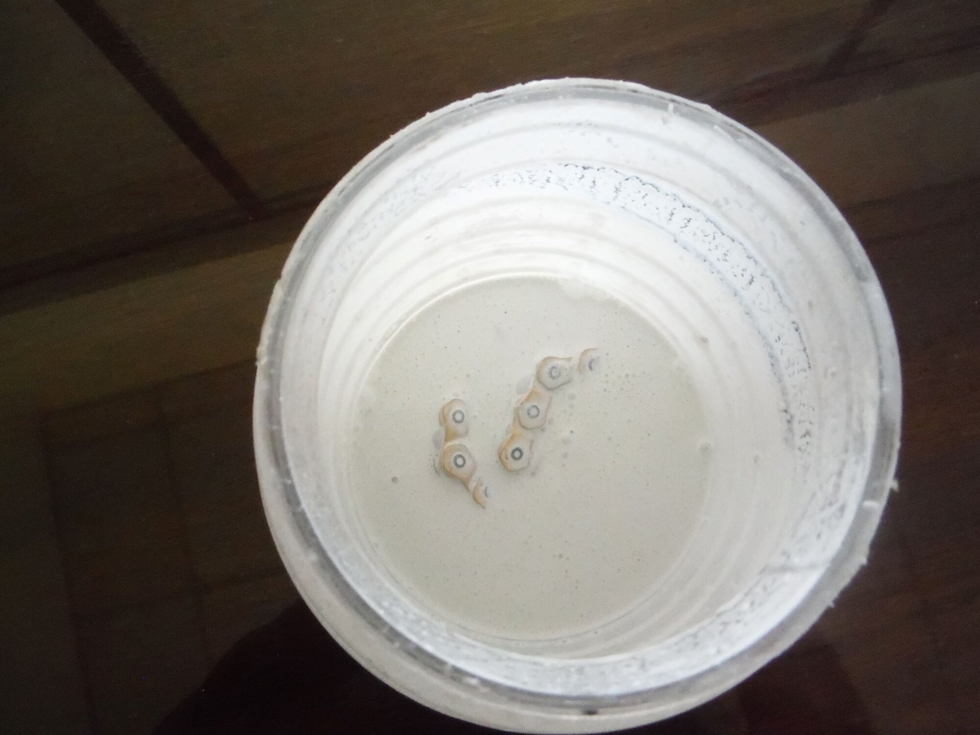

Here is a gold half-link BMX style chain that has been stripped of all shipping oils and in a plastic peanut butter jar filled with dry lube an aqueous nano-wax emulsion that does not attract any grit when air dried. It was shaken many times and soaked for five-hours. Any off-the-shelf chain, no matter the price, will attract sand and grit, killing the drivetrain prematurely. Oil is the chain smoker who died.
Thanks! Guessing this is what happens next...
Spoke with Taylor. She was unaware that you can also shake things ON. Look for the follow-up video.
