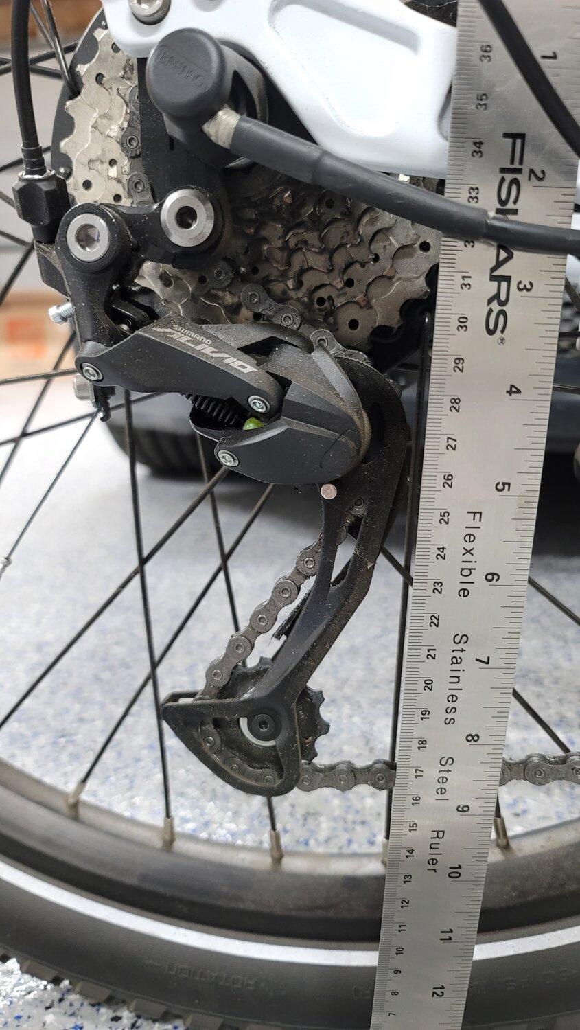

My derailleur cage is 100 mm on center from pulley to pulley (or whatever those 2 little idlers are called). Would you call that short, medium, or long?
May not make a difference, but I counted cassette teeth myself to clear up some online discrepancies, and it's 12-36, not 11-36 as previously stated.
Thats pretty clearly a long cage. So you are good to go on that front.
