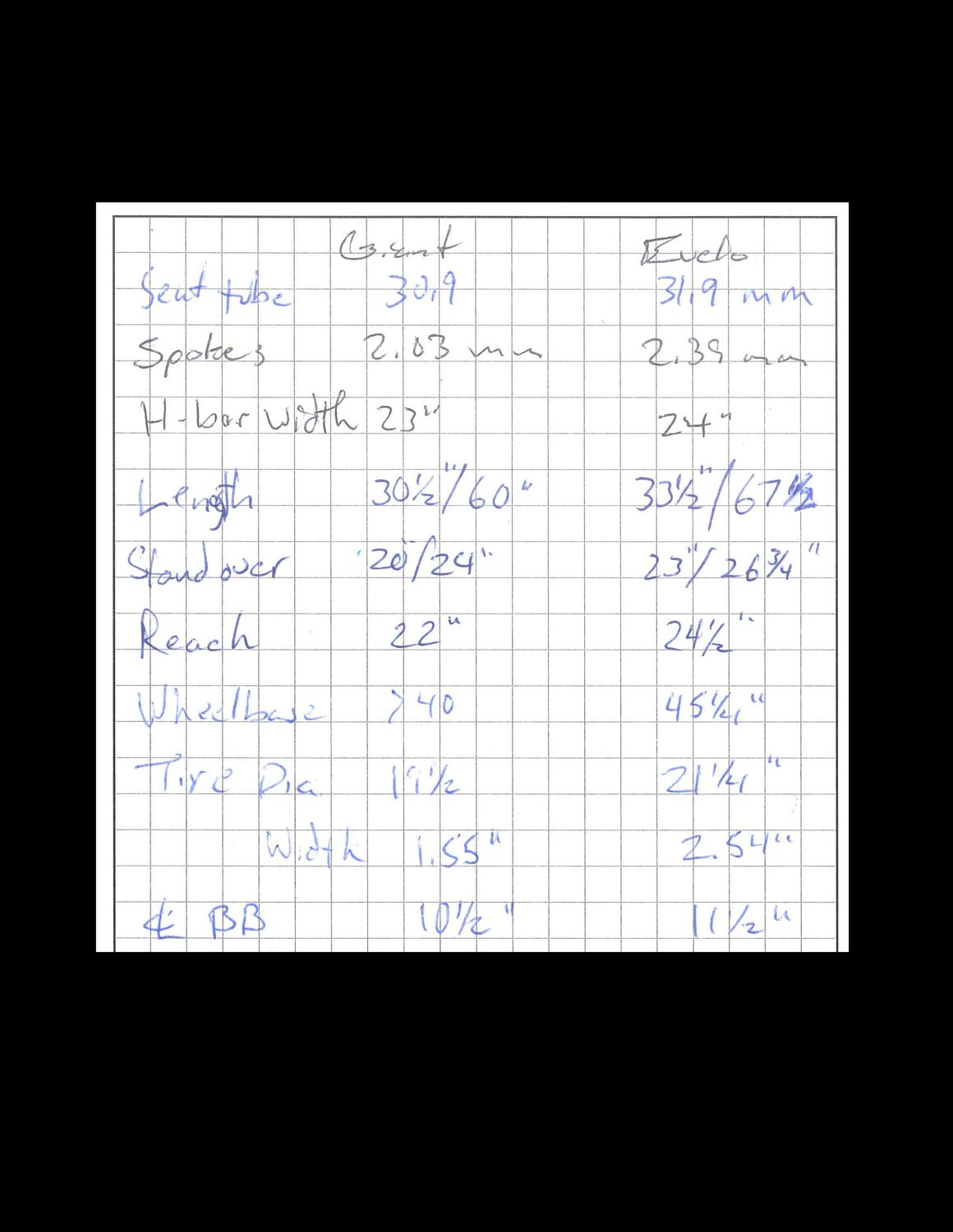

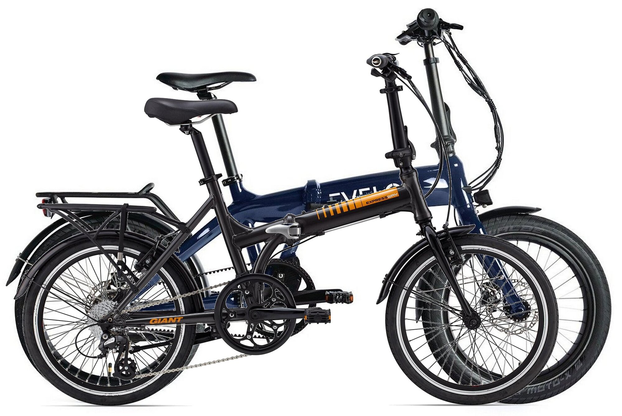

Either the 40-inch wheel base Evelo has published is incorrect, or they have radically changed the bike. Not to speak badly of them, they did have incorrect tooth counts on their cogs/sprockets published for quite a while, so the 40-inches might just be an error in the published wheelbase. Otherwise, look out world, it's a much different bike.
I measured our Expressway and the Dash this summer and the Dash's wheel base is more like 45-1/4". The published wheelbase for the Expressway is 39.9", while I measured it as being about 40". Incidentally, the two lengths I wrote down on the attached measurements are based on the folded/unfolded lengths respectively. And, as noted in post #3 of this thread, I included the rear fender in the Dash's overall length of 67-1/2".
I also took some time to create a picture merging profile photos of the two bikes. I think it's generally a pretty accurate comparison. The headset angle on the Expressway is 71-degrees. Evelo doesn't publish an angle for the Dash but it looks like it might be the same or perhaps even a degree or two steeper - ?
It also appears the Dash has more trail which, along with a significantly longer wheelbase, would provide less twitchy steering. However, I'm not really that informed about geometry and the photo is subject to interpretation, so others may have different conclusions. For whatever reason, it does offer a much more stable riding experience.

Either the 40-inch wheel base Evelo has published is incorrect, or they have radically changed the bike. Not to speak badly of them, they did have incorrect tooth counts on their sprockets published for quite a while, so the 40-inches might just be an error in the published wheelbase. Otherwise, look out world, it's a much different bike.
Interesting and great job on those profile pics. Dash definitely appears longer and bigger overall. Your conclusion might be right about Evelo making an error on the wheelbase measurement. I’m really surprised that Court has not reviewed the Dash yet. You can’t find any reviews anywhere.

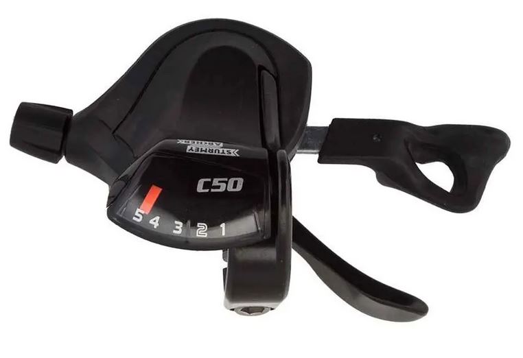

What is the shifter on it now?
Sturmey Archer Handlebar Mounted C50 Dual Lever Trigger Shifter
I have no experience with this shifter to comment vs a twist grip style.
Change could be due to availability or seen as a technical improvement (as eMail implies)
For me since this will be my first non-NuVinic Hub bike in many many years learning a new shifter will be a needed anyway.
We have a couple of derailleur bikes with Shimano trigger shifters and we really like them. Click up, click down; they provide easy, no fuss, indexed shifting.
I'm not fond of twist shifters, which is what our 3-speed Dashes have. The twist shifters require that one consciously grip the shifter strongly while stopping at a slight detent. I find them to be a lot fussier to operate.
So, I suspect I'd prefer the Sturmey Archer trigger shifters too.

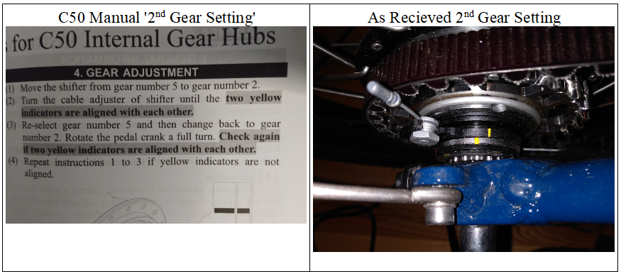

There is a problem down shifting from 3rd to 2nd.
On returning from the Test Ride and reading the C50 Transmission (limited info) guide I suspect my unit was not correctly Adjusted at the Factory.
I'm not 100% sure how to re-adjust (manual limitations) the transmission and will contact Evelo for some guidance.

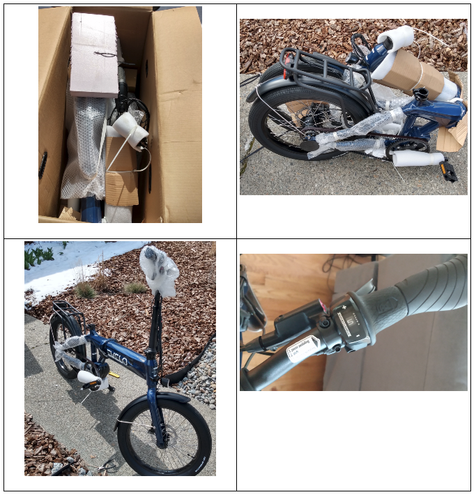

1. I do not like the Seat Post, Seat Attachment design. I had to remove parts from my Cloud-9 Seat to get clearance to mount the Cloud-9 seat.
2. Standard Seat is really, really, really bad.
3. Shipping box arrived with plastic straps in place however None of the Staples nor the glue were functional.
Just cut the straps and open the box. Appears there is no damage . . . but Gosh, factory can't even staple a box correctly . . .
4. Display screens are different than official "Dash Display" user manual information. Not a show stopper but Marketing Documents are not current.
Big Surprise:
The '22 Dash arrived with a Twist Shifter not the trigger-shifter we were told was a design change and part of the reason shipments were delayed.
I contacted Evelo, and might have been a bit grumpy about it, Support responded with:
" We had intended to change to the trigger shifter for the Dash model, however once the trigger shifter was sourced and installed it did not perform
like it was supposed to. In the end we went back to the grip shifter with a higher quality cable which achieved the shifting that we were after."
I've found the Up Shifting to be easy & smooth. Downshifting takes a big addition twisting effort.
Will have to see if the 'gear adjustment' issue noted above is a factor in the downshifting.
