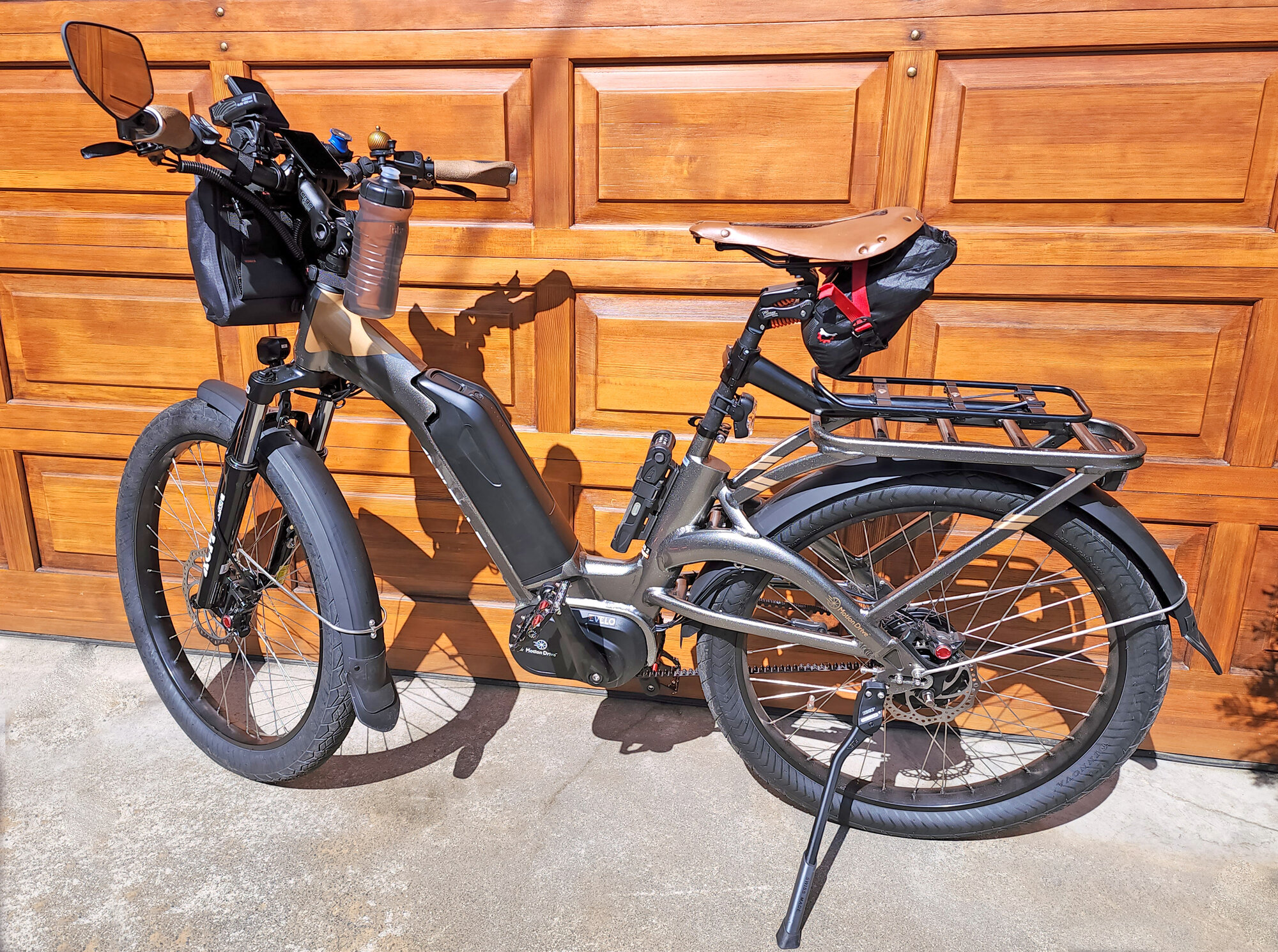

I bought an open box Aurora Limited a week ago. The bike had one mile on it and a faint scuff on the rack that polished out in 5 minutes. It is a fantasic bike, looks brand new, came with the full 4 year/20,000 warranty and I could not be more pleased with the quality of support I am getting from Evelo. I would not hesitate to buy an open box bike from Evelo, especially as they will get to you in a matter of two weeks or less in the USA>
Here she is all customized
