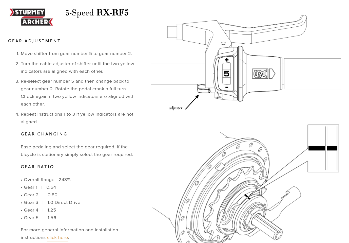

Hub Shifting Update: - - - See, Quick Review Comments on yr-2022 5-Spd Hub that arrived Today. {April 15, 2022}
With some eMail assist from Evelo Support have completed the C50 Gear Adjustment.
Shifting is greatly improved but this is not a NuVinic CVT ;)
On my bike something was off/wrong with the shifter Cable Adjuster.
It appeared to not have been locking so as the bike was ridden the C50 Gear Alignment slipped out of alignment.
I've now ridden for ~ 27-miles and the C50 has remained in the correct alignment. So hopefully I have it adjusted & locked.
Up shifts are 100% perfect, Downshifts are (presently) 90% perfect.
Some Observations:

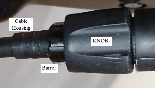

[ 1 ] How to correctly {?} use the Cable Adjuster.
The KNOB must be pulled-back against the spring pressure.
Doing so allows the Knob outer end to engage the Adjuster Barrel flanges so the barrel actually rotates/threads in-out.
After releasing the Knob spring tension, the Knob must be slightly rotated so its inside end engages {possible} locking teeth on the housing.
[ 2 ] Up Shifting is easier than Down Shifting due to the {clutch ?} spring tension.
Up Shifts release tension, Down Shifts wind up the spring with each downshift taking more twist strength.
[ 3 ] When downshifting, overshooting the target gear position by .5 gear position on the twist grip allows the
target gear to be selected with a slight up shift rotation letting the spring assist in engaging the gear position.
If in 3rd and need to be in 2nd: Rotate Shifter to about 1.5 on the display, then release/return to 2 which clicks.
While I don't expect this is the official process, it seems to help getting a solid downshift.
On my bike the Yellow Lines on the hub align better on the up shift rotation (indicating good gear alignment)
I suspect my 90% downshifting success is that I have not mastered this approach or shift timing.
Very fast downshifts don't seem to allow the hub to 'set itself' - - - again not a CVP, and I'm spoiled by the CVP lack of effort and responsiveness.
[ 4 ] I found this youtube video on the RX4 Hub and Twist Shifter. RX4 is like the RX5 less one gear position.
Video very clearly explains how to complete the Gear Alignment.
X-RF4 4 Speed Internal Hub
[ 5 ] Here is a more detailed written instruction (than shipped with bike) provided by Evelo Support for the Gear Alignment

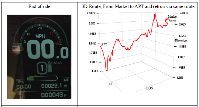

[ a ] I've been surprised how well the 350W motor handles hills. True I've not ridden up any monster hills but I've been able to find a comfortable combination of gear and power assist level. While general riding (not doing a test) my recent 22-mile ride was mostly in power assist 1 outbound . . more down hills . . and 2 on return. On worst up hill 2nd gear an power level 4 were the lowest gear / most assist used. But at a huge battery reserve cost of course.
[ b ] On a few down hills I allowed the bike to reach 22 MPH on a smooth surface. It felt stable and comfortable.
[ c ] I am unsure of the bike's overall battery range. That 22-mile ride used 4 of the 5 bars with the last 5'ish miles being on 1 bar.
[ d ] Motor Controller Display Data . . . gets confused at times.
On two different down shift sequences on a longer hill the MPH reported 27.5 when bike was doing ~7.5 MPH
Display did not correct until a shift was completed.
[ e ] Think I will be keeping this bike but will also keep my Aurora Limited (copy cat) a Dost Drop CVT on order.

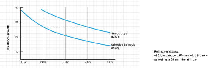

Schwalbe has some interesting information on rolling resistance here: https://www.schwalbetires.com/tech_info/rolling_resistance
Tire pressure, tire diameter, tire width, tire construction, tire tread and other factors all have an effect on rolling resistance.
On a completely smooth surface the following applies: The higher the inflation pressure, the inferior the tire deformation and thus rolling resistance.
Off road it is exactly the reverse: The lower the inflation pressure, the lower the rolling resistance. This applies equally on hard gravel roads and soft forest tracks. Explanation: A tire with low inflation pressure can adapt better to a rugged surface. It sinks into the ground less and the whole rotational mass is held back much less by the uneven surface.
Tires with a smaller diameter have a higher rolling resistance with the same inflation pressure, because tire deformation is proportionally greater. The tire is flattened more and is “less round”.
Wider tires roll better than narrower tires. This statement generally invokes skepticism, nevertheless, with tires at the same pressure a narrower tire deflects more and so deforms more.
Schwalbe's diagram, below, shows how a 2.4" wide tire (60 mm) at 29 psi has the same rolling resistance as a 1.5" tire (37 mm) at 58 psi, (1 bar = 14.5 psi).
The tires they illustrate are a different brand from those on the Dash, but the principal applies.

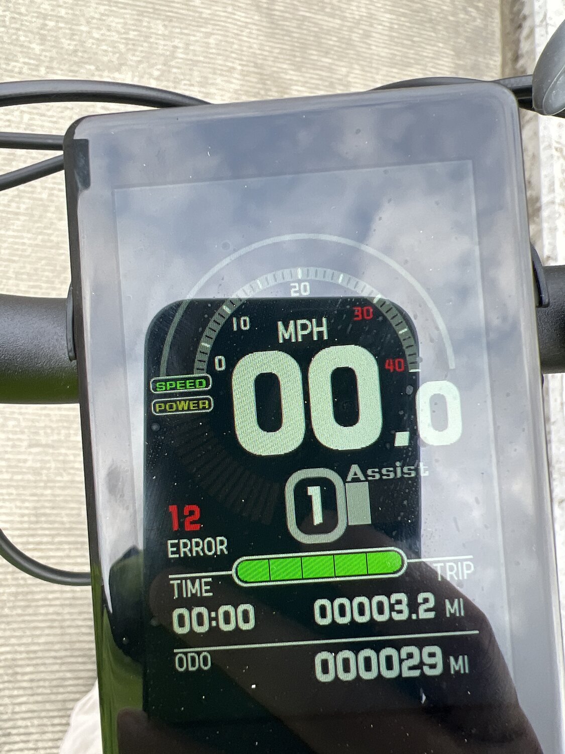

Ouch Error Code 12
Well I was just starting to get adjusted to the 5-Speed Twist Shifter down-shift 'issues' when the eBike gave me an Error 12 at 125-total-miles and all power-assist (or throttle) operation ended.
Evelo has offered to swap my bike for another new-box unit.
Which I will be doing once I return from my shortened 'bicycle day adventures' road trip.
While riding up a short but very steep hill I increased the power-assist to "5" and attempted several downshifts to 1st.
I suspect the issues I've experienced downshifting from 3rd-2nd, 2nd-1st was a factor . . . slow response and unreliable engagement.
{ of course this could be an operator issue . . . I'm waiting for other 5-Speed owners to comment on their experience. }
I had to stop. Then attempted to restart on the hill in Gear 1 Power-assist 5.
The eBike would not go . . . so I walked up the hill. At the top the Error 12 was noticed.
Evelo Support has never seen an Error 12 and it is not on their error code list.
They are contacting Dapu for additional information.
A few non-Evelo web-sites list error 12 as a 'general usage' current sensor or current overload error. , ,

I also got my Dash last week, and this morning also encountered an Error Code 12 while trying to ride uphill on the 520 trail bridge. Contacted Evelo and they're preparing to ship me a replacement Dash, but I'm telling them to possibly exchange it for a Galaxy 500 (or Aurora... anything that's a little more powerful, has automatic shifting and is in stock) instead since I'm having the same troubles shifting the Dash. I'll have to pay the difference but hopefully the Enviolo automatic shifters work better.
Thanks @accoleon for your posting on Error 12 news and your shifting discomfort.
You got me thinking about doing an exchange instead of a Dash replacement.
However, Evelo is out-of-stock on the Aurora Limited model so I've decided to request a full refund and go eBike'less for awhile.
Maybe I'll do a wider brand search for something I like that is actually in-stock.
