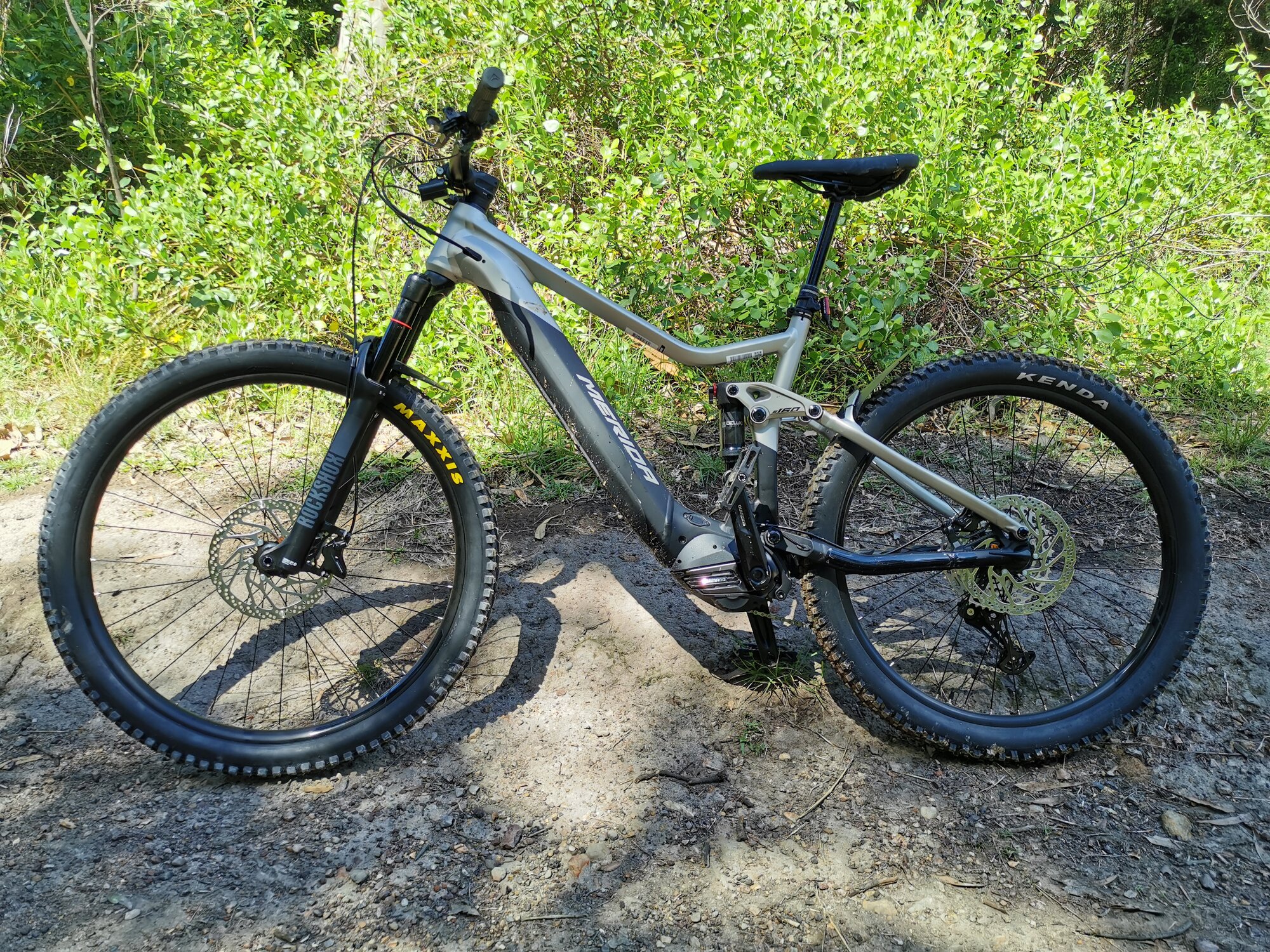

Well this happened. A ridiculous amount of fun! Thanks to @PDoz for being my enabler and the forum here for all the advice.

Congratulations, Paul! So N+1 has happened!
It has Stefan. And I'm glad I took the advice here - it felt like an indulgent purchase (huge shout out to my understanding partner for the nod) but it really is night and day on the trail.
Whereas I was carefully threading my way down technical sections of single track on my Giant Explore avoiding all the rocks, roots, diverting around drops, etc now I just pick my line and let rip! It just ploughs over anything (so far). I'm particularly enjoying how approachable the full sus bike has made rock gardens.
The combination of tyre traction, energy-absorbing suspension and the slack geometry totally open up new possibilities on the trails.
The EP8 is an interesting creature too - definitely not overwhelming in the power department (the 85nm output feels weaker than my 70nm Syncdrive Sport motor) but is always there in a very natural fashion, intuitive when I need it.
I'm really enjoying the early steps of learning my way through the MTBing space. The brilliant 'How to bike' resources featuring Ben Cathro have been a huge help.

It does I'm afraid. The integrated light (weird addition but actually halfway okay) and Shimano display controller are both routed through the stem. They could be diverted to the downtube ports but the stem spacers are oval on my model too (Merida e160 500).

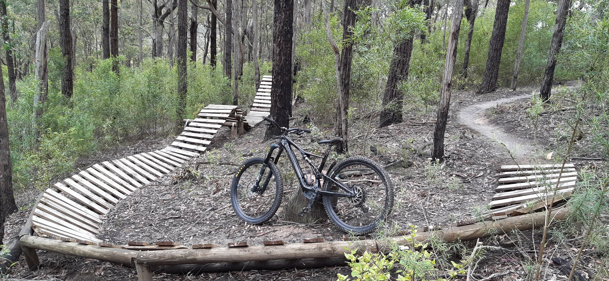

Stunning... and yeah, PDoz is the best!
I'm a rookie myself, and learned a lot just on this page. Went tubeless about six months ago, and don't think I'll ever go back-- loving my Ikons, though at 2.2, they are definitely a bit more skittish than the original Riddlers on the loose, sandy stuff Griffith Park and in the Hollywood Hills. (I'm going to start calling that "Sierra Sand," PMC, I like the sound of that!)
The conditions I ride in are so weird, it's a series of compromises, and that's one I was willing to make-- the lower rolling resistance and lighter weight is really noticeable, and very important because I'm so underpowered (E5000, 40nm). I'm going from pavement to dirt to gravel to broken pavement and dirt, etc... and they are surprisingly stable on the road, I do take a deviant perverse pleasure in doing non-MTB stuff like passing Porsches on Vermont Canyon. Oh, well... nothing against Porsches, but they can't take those speed bumps much faster than 25 MPH, can they? I usually slow down a little so I'm only passing at 30, and I'm sure that they can see me and don't drift into the bike lane...
But what I need is an intense workout in 30-50 minutes; particularly during the school year, that's just all the time I have, though I might get in some 30-40 mile rides over Christmas break. And it's all gotta be out the door because I drive sports cars and can't mount a rack on either of them. A high-end bike like a Trance would be wasted on me at this point (though I guess I could just set the assistance lower). I rode a Rossignol hardtail with an e7000 in Vermont over the summer, and it was a blast, but a completely different experience.
Very interesting about assist / gearing for steep sandy stuff. There is ONE HILL that still defeats me every time-- it's a shortcut into the park from residential streets, and thanks to everyone's advice here, I once got 85% of the way to the top! I'm no longer popping wheelies, but either I get psyched out by narrow passes between rocks that at an angle to the trail and only four inches wide-- there are two of them, the first I usually can handle, the second I'm now about 1 for three tries instead of 1 for 5-- (for months, I couldn't get past them at all) but I sometimes can't correct properly to get aligned with the trail after I get through, or I lose traction, or I just... find the bike drifting into the grass for some inexplicable reason. Or I bonk physically-- only for a second, but long enough to lose momentum-- or the wheels spin JUST enough to slow me down. I have only three assistance settings, so I think I have to stay in granny and High for the whole thing, but the line between too much and too little power (human or motor) is really, really difficult in this one spot.

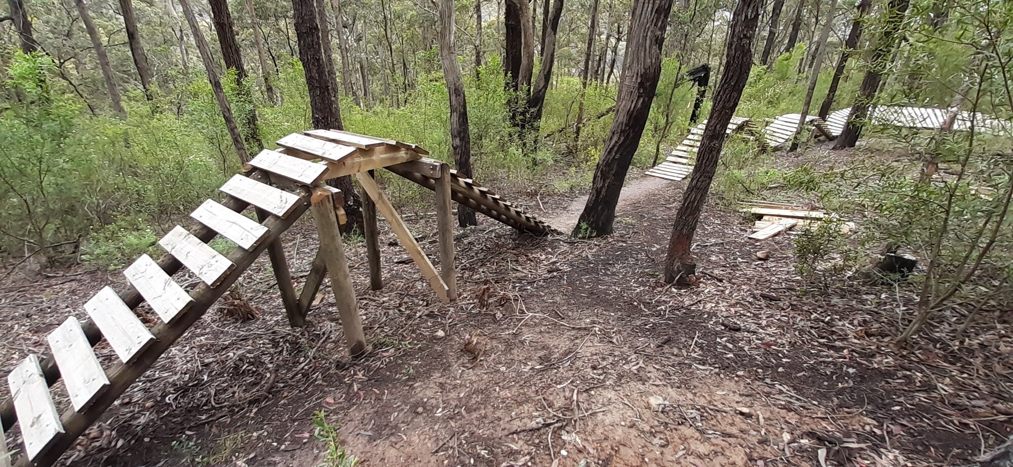

I'm still astounded that on weekday evenings, I can ride for a couple of miles on the back side of Griffith Park without seeing a soul.
Those ramps are SICK! I confess that I've found myself looking at some of the many staircases around here, some of which have pretty wide steps, but...
No. I'm 64 and on blood thinners, not going to be doing that!
