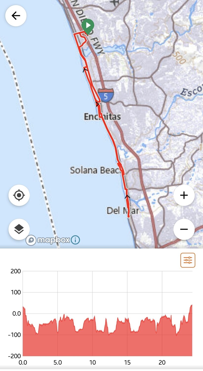

Took the hub-drive on an undulating 24-mile, 2-stop coast ride this morning to simulate certain aspects of the SL. Nearly all with motor off, most of the rest at lowest assist, starts and intersections without throttle, etc.
Pretty slow without the motor, but I burned well under 150 Wh — less than half the SL's capacity.
Conclusions:
1. I foresee getting a lot of use out of Microtune in this kind of terrain.
2. Knees will definitely miss the hub-drive's throttle. They really don't like strenuous accelerations of any kind. Thankfully, the SL will have less linear and rotational inertia to accelerate.
3. Given the SL's lower weight and rolling resistance, certain now that it'll be great on typical coast rides without the RE.
4. Performance on inland hills is the only remaining concern.
We shall soon see...
