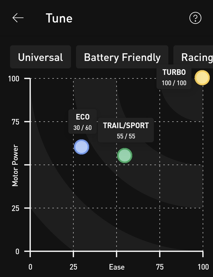

Not necessarily. I don't think your rides are overly long. As long as you would not ride in Turbo mode all the time, the main battery could suffice. These configurations give a long range and a decently strong assistance:
- 40/100%, where hard or high cadence pedalling gives a lot of assistance but regular pedalling saves the battery a lot
- 60/60%, which is the max assistance for the long range
Of course you would use 100/100% Turbo for any steep climb but then no pedalling on descents.
Bear in mind the Mastermind display can show you the remaining Range, and the Microtune mode allows you regulating the assistance as you are riding (my version of Vado SL has none of it!)
