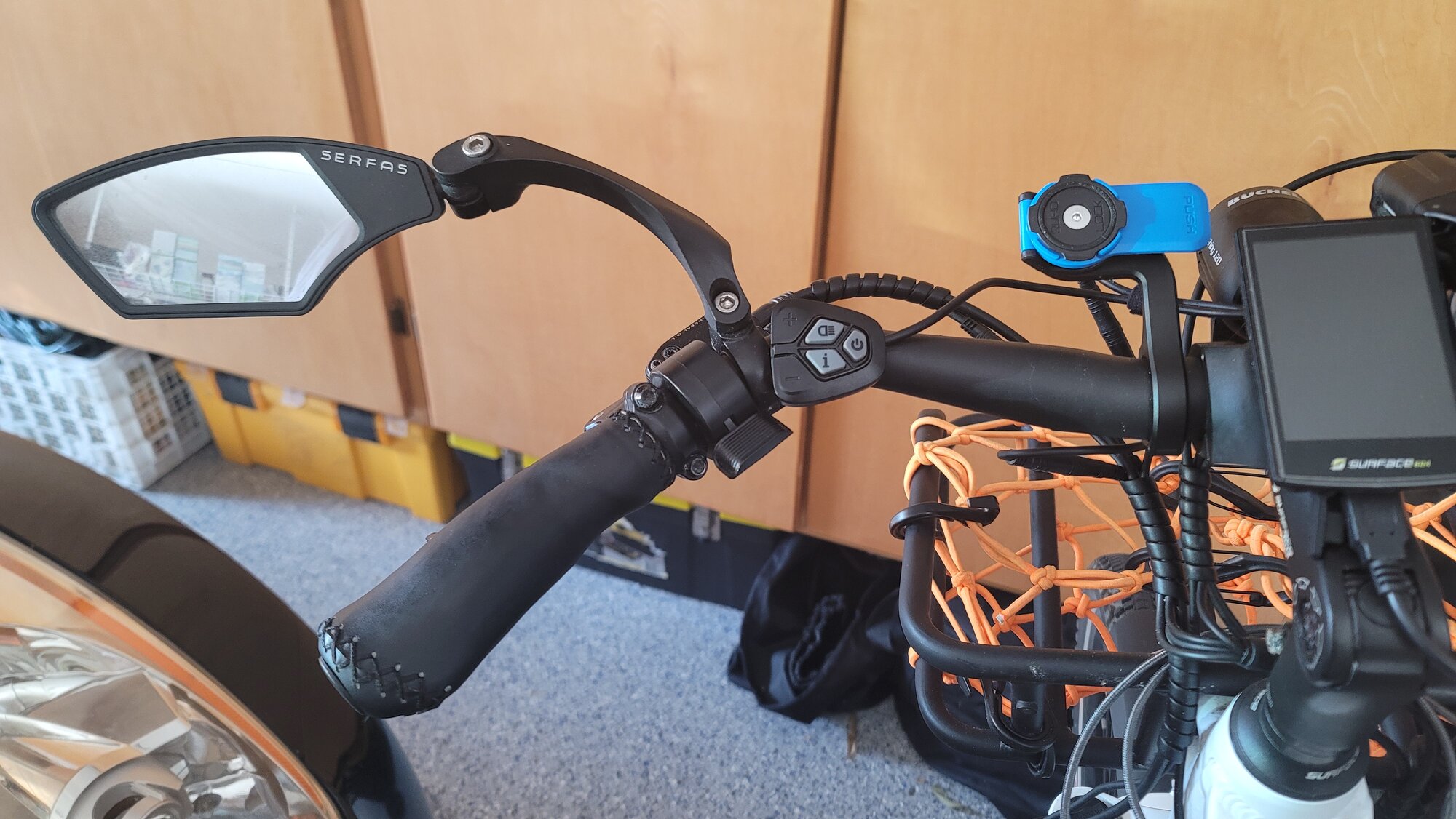

Meanwhile, I've been gathering up some of the kit you guys recommended. The QuadLock case works well with my phone, and so far, so good on the Out Front Pro mount needed to use it on my existing ebike below.
Like the SL itself, the regular Out Front for the SL has yet to arrive, but I'm hopeful that it will work out.
The jury's still out on the EVT Safe Zone helmet mirror needed at least for the SL trial period. Much smaller field of view than my existing Serfas mirror above, and adjustment seems to be something of a black art. Also need to close my right eye to get a clear image. This will take some getting used to.
