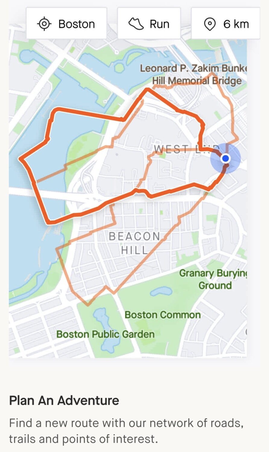

Found this route planning example on Strava's home page as I looked into it for another take on local grades:

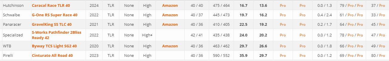

for more rabbit holes to go down before you receive your bike, compare potential tires on bicyclerollingresistance.com
the range of resistance in similarly sized (36-40mm measured width below) tires with the "smooth center knobby edge" design is HUGE, from 13.6w (27.2 for a pair) to almost 60w for a pair. at slower speeds, that kind of difference will affect your range very noticeably. the last column shows the tradeoff of puncture resistance. you can see why the pathfinders are fairly popular, a good balance of low-ish weight and rolling resistance with the best grip and decent puncture resistance.
it's also worth noting that if you're not riding off road or in the wet, the knobby sides really don't help you at all. they're just loud, heavy, and have lots of drag. but extremely useful on dirt :)
