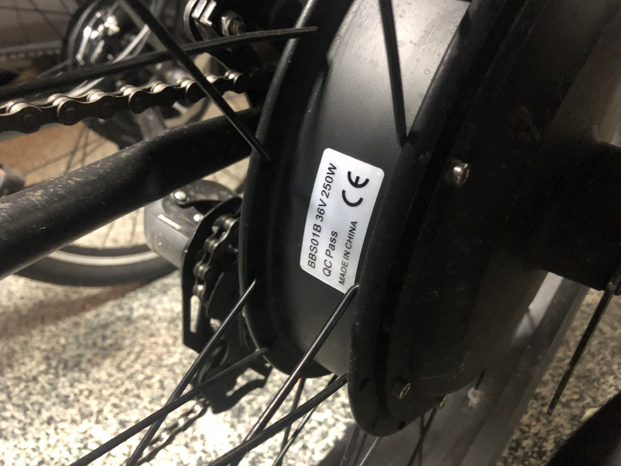

Ebikeling 1200w rear wheel kit from Amazon
Best grin of the day....
Better? This has “Made in China” on it too. That means it’s much more likely to be authentic!
42825
Every bit as laughable. Given the litigious nature of our culture fraud puts me in the increased risk category with a fake label. IMNSHO Id rather run without a fake sticker. My lawyer pals would love to have this as evidence in a suit for damages where I was shown to be at fault. Sure just like the claim that it’s unlikely any LEO will check. s*it happens. I’m old school. Black and white. If I had kids I’d say I was being a bad role model. YMMV
I would think that it’s my bike and I can put whatever stickers I want in it. I could put a WORP drive sticker on it or a Millennium Falcon sticker on it and that would not make anything fraud. (There is no requirement to label any motor in my state as far as I know.)

i love how the 250w sticker is the polar opposite of those car guys putting on fake air scoops and "turbo stickers"!
but the conversation really got me thinking (apologies for momentary thread hijack:) if we set aside the sticker and think through thomas' argument about lawsuits; i wonder if the mere fact of owning a bike with more than the allowed wattage (say for example, > the federal 750 watts); or violation of a state reg (e.g., ability to go throttle-only; speed setting higher than 20) is going to cause insurance attorneys to try to weasel out of coverage. shudder... like in the car accident world, the auto insurer loves to try and argue no coverage over drunk drivers... (sort of an exaggerated example but still...).
Though I think the throttle rule is stupid, it would be hard to argue whether you have one or not in court. About the best you could do would be to say it was disabled. Your word against a cops regarding your speed would be another tough one.
The one I believe they would REALLY struggle proving would be the 750 watt rule. They're going to play hell proving that one unless the motor happens to have markings on it. Not all of them do, nor are there clearly marked model numbers.....
more to ahicks' point about the wattage being hard to prove - who's to say that the manufacturer's original watt ratings are any more accurate than the sticker? like maybe if your application is punishing the DD motor with a heavy load slowly up long uphills, an ostensibly legal looking 750 watt sticker might actually be the more proper dissipation rating than 1200 for this motor...?
