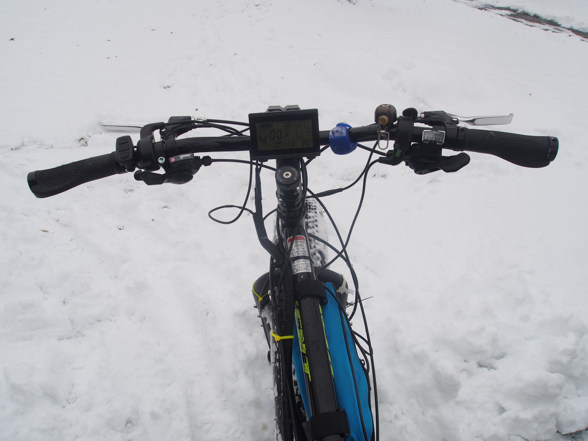

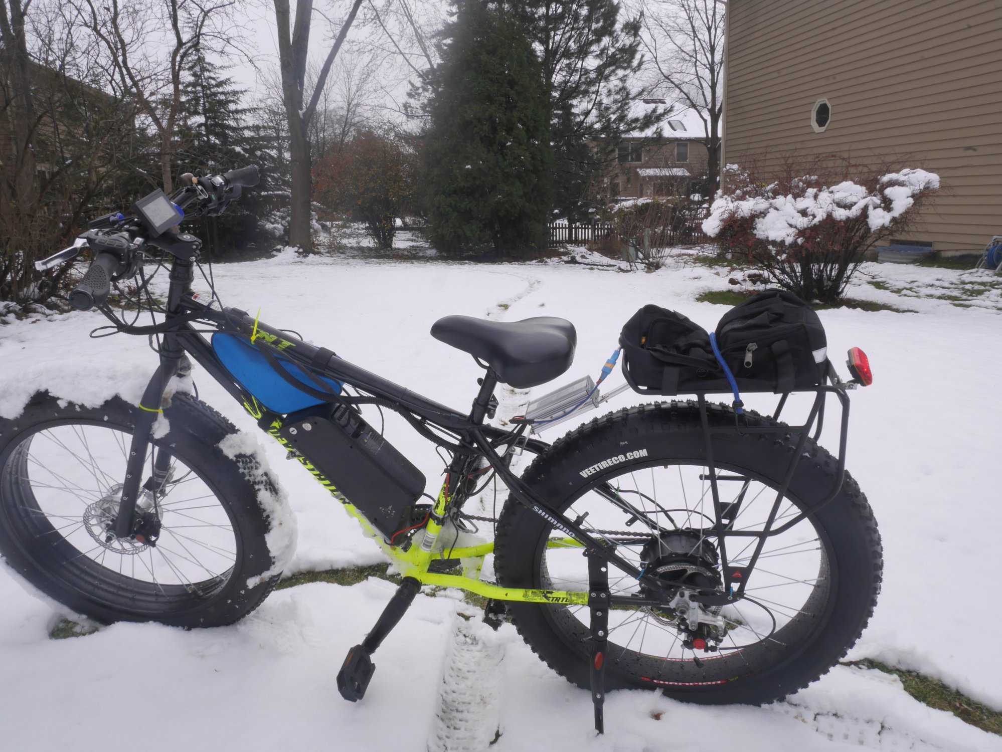

Did exactly what you propose, Big Matt. However, my setup was for snow, not for riding to work. I'm glad I don't have to do either.
Front motor was an ebikeling geared motor that I laced into a rim. Rear motor is a bafang geared motor I bought with the wheel already on it. Used only throttle for the front, and put it om the right side. I later turned it around to have it next to the grips. In the pic, it's in quite a ways.
In snow, I'd throttle up the front to get rolling, and PAS would kick in on the rear when I started pedalling.
I took it apart after one season. I caught bronchitis in Februrary and had it thru April.

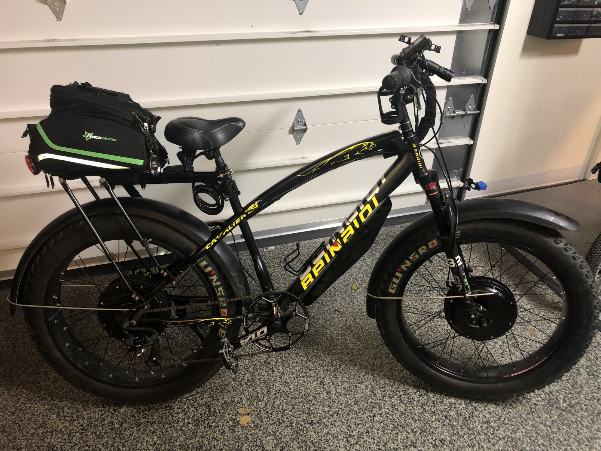

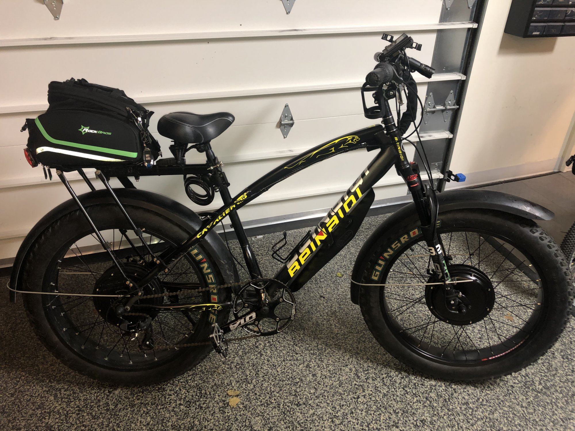

Here’s what she looks like done. I hooked the single throttle and single PAS to both controllers with separate displays. I think I’ll likely end up keeping the front set to a slightly lower throttle and PAS setting than the back.
I haven’t opened her up yet, but I took her around the block and performance (get up) was unbelievable...
- 48v 20 AH on the rear hub
- 48v 20 AH on the back (2 identical 10 AH parallel).
- I was going considering running them all parallel then split to both controllers, but the fully charged voltage (between the front and back) is ~0.7 volts apart (54.8 vs 54.1), far enough apart. That’s too far for comfort. The 2 (10 AH) batteries that are run parallel are identical voltage, make and age/wear with identical BMS.
PS. You’ll notice my urban camouflage on one hub. Hint: They’re not 250/500 watt hubs, but 250 + 500 = 750... ;-)

So all the batteries are in the bag? Looks good. Ride safe! Let's hope this is one of dem years with more rain than snow,
Yeah, the batteries all fit in there (along with 2 controllers). I had to play a game of Tetris to get things to fit efficiently. When I increased from 20 to 40 AH, I lost most my storage space although the rear rack bag has relatively sturdy side (unzipping) panniers.
I’ve also got the batteries zip tied down (thick massive zip ties) to the rack cutting slits in the bottom of the bag. I also have a lock on the zipper and a (Insanely loud) motion alarm to eliminate a casual theft. Has to be a highly determined thief with tools on hand.

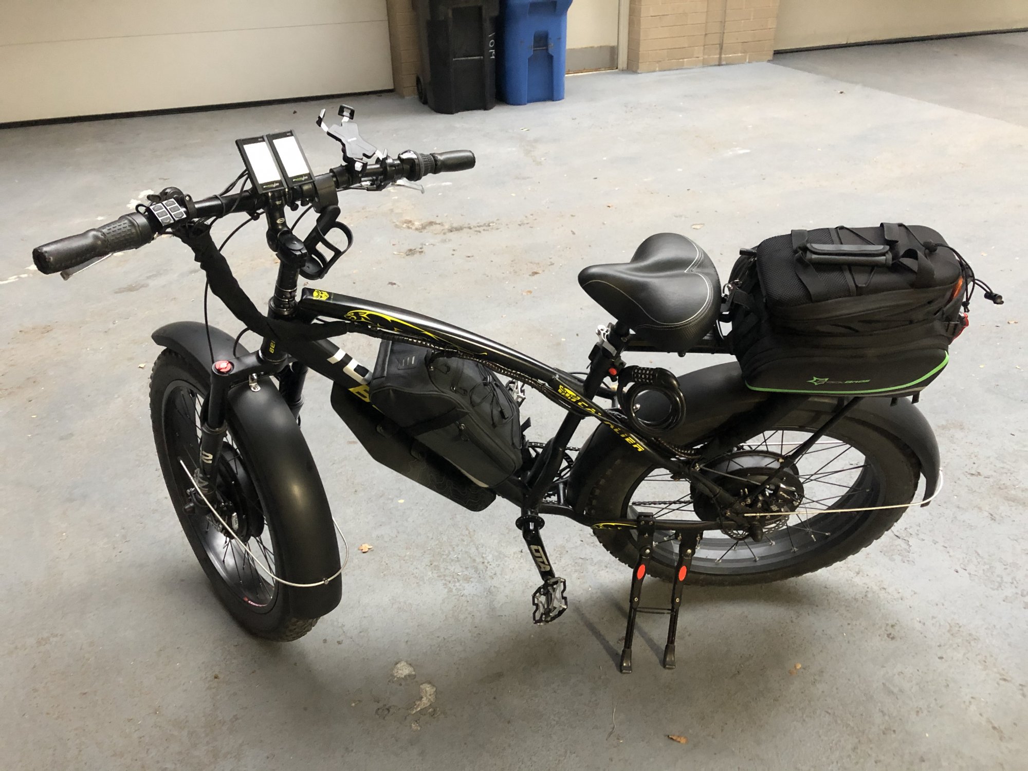

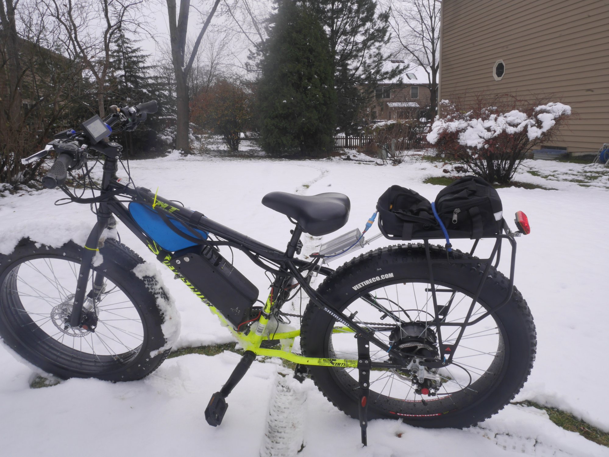

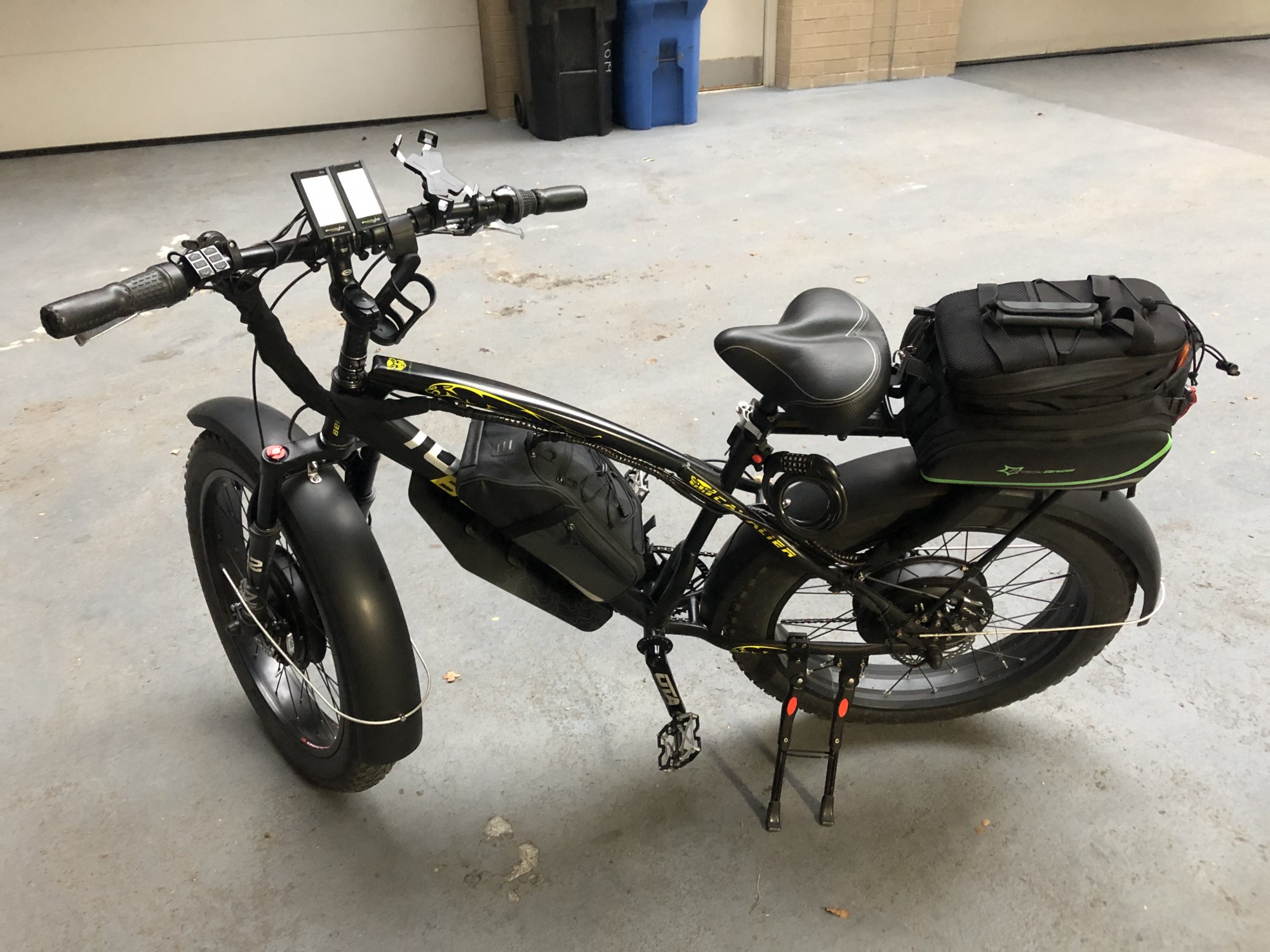

Alright, Harry, I officially lost my mind...
- I added a third 20 AMP hour battery to the frame (three 20 AMP Hour batteries in parallel now) and now might be able to make it to Madison, Wisconsin from Chicago, Illinois (~144 miles ~ 2,880 Watt Hours assuming 20 WH per mile). The battery was orphaned from a different build and I felt guilty not finding a use for it.
- I wired both displays together to the same centered handlebar mount for a cleaner look.
- Both motors/controllers are on the same PAS system. Front right thumb and rear left twist, but really the the only thing needed is rear throttle to get the rear going and then pedaling toget both motors going.
- Notice the 2 kick stands zip tied together so they go up and down together. Damn thing is so heavy now it will bend a single kick stand like it’s a drinking straw.
- I was concerned that the ~6 inch wide frame battery (between the knees) would get in the way when pedaling, but I have plenty of clearance. Despite the overall weight increase, I think it rides better with a little more weight centered balancing out the heavy weight (two 20 Ah batteries) in the rear trunk bag. I used the bottle mounting holes, a sturdy piece of mounting plastic (Lighter/stronger than plywood), some super thick zip ties and a waterproof trunk back to get that center battery mounted securely and rather cleanly.
I ordered a front fork rack I intend to mount to install another bag. My original Idea was to put the battery there (rather than the frame), but adding that weight to front fork might really make steering weird. I may just make that front a cargo bag for things (keys, wallet, iPad, groceries, etc.) that are likely to be much lighter than a 20 AH battery with Aluminum protective casing.

Wow, what a monster bike.
I've had problems with the same kickstand. Tightened it too much and bend the chainstay. Thought about it a bit. Made an upper strap to the top chainstay so it wouldn't slip. Turns out they sell them like that. It worked, but the lower arm snapped off. I'm on my second one. Maybe you need a center mount stand, but they look flimsy too.
