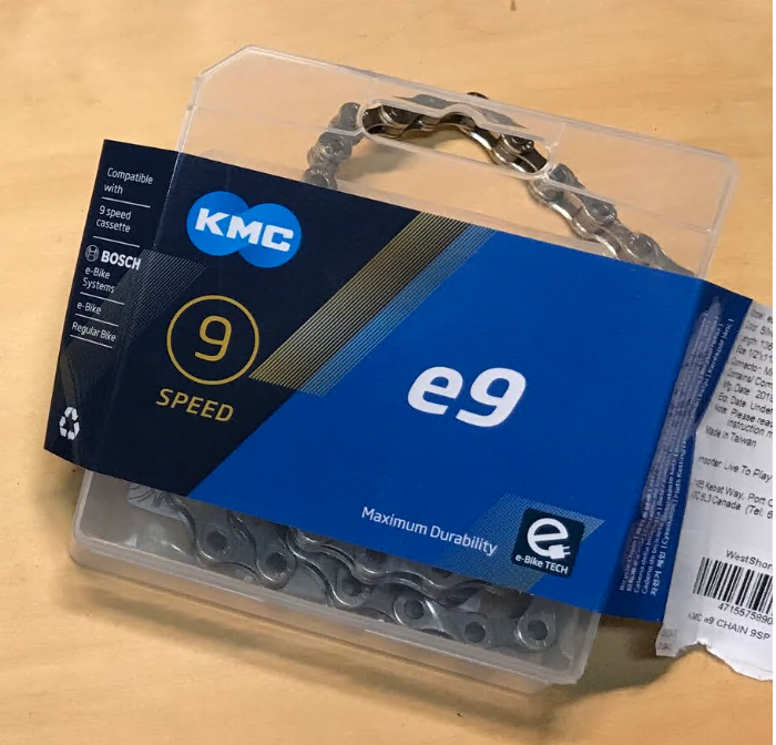

Hi friends,
I'm wondering if anyone uses an ebike-specific chain for their mid-drive ebikes?
I just noticed that KMC sells apparently an ebike specific chain, called the 'KMC e9 Sport 9-Speed E-Bike Chain'.
Any thoughts on this, or should I continue to use a standard bicycle KMC chain, which has a 'strength' rating of 3/5, per the manufacturer listing on the box?
I feel like this may handle tension better, perhaps? Any input would be highly appreciated :)

As the original poster, quick update from the last post:
I have switched to an ebike-rated chain (the one shown in image from post in 2022).
While I cannot say with certainty whether there is an actual difference, I feel like it's an inexpensive insurance policy against the (likely weaker?) non-ebike chain... either that or just good marketing on the part of KMC... LOL either way happy with the ebike chain connected to the Bafang Mid Drive.
