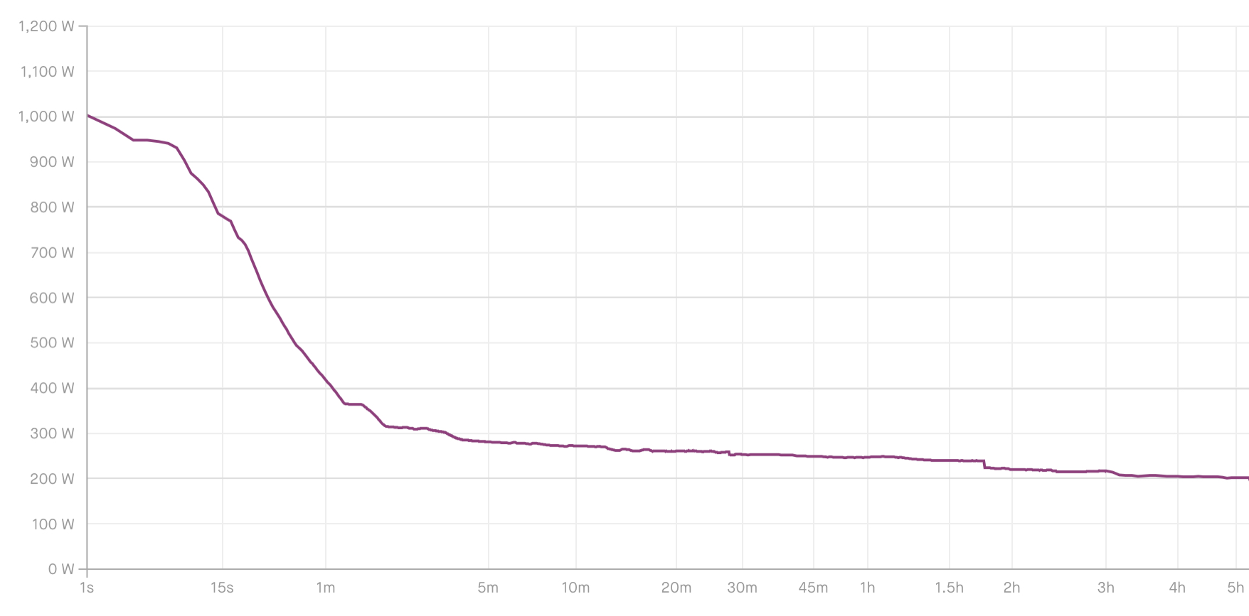

right, lots of variation. my point is simply that while a motor and battery put out sustained power at medium/high levels for much longer than any human can, many or even most humans can put out enough power to destroy a bicycle drivetrain through improper shifting and maintenance.
here’s my power curve, based on the power meter in my non-e-bike…. and i’m nowhere near a pro, or even a competitive amateur, with a max heart rate of 130BPM 😂😂
