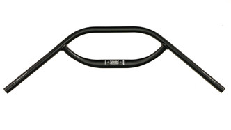

You have a quill stem. You will need to measure the diameter of the handlebars at the clamp to know the clamp size. The best way to measure that is with calipers. Look for riser quill stems. 5" is a lot. you may need to do a combination of replacing the stem and the handlebars. The Jones SG 2.5 Loop Bar has a 2.5" rise. It is also likely you will have to replace the brake and shifter cables with longer cables.

Yes, I have the Jones SG 2.5 on my bike and like it a lot. You can get it in silver or black. The loop may interfere with your front bag though. The Nitto Albatross bars have a rise and sweep also.
Pay attention to the clamp diameter. The Jones bars have a 31.8mm clamp diameter. Most quill stems have a 25.4mm clamp diameter, but you can buy quill stems with a 31.8mm clamp.

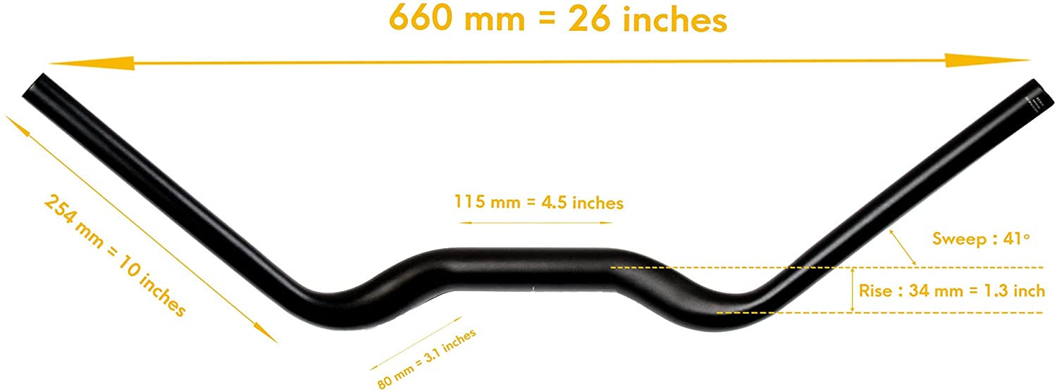

I am going to go with these following bars for the Rideal. Does anyone know how i would go about rising the bars? I can't figure out how to get the bars higher with this type of stem, seems like when i loosen the 4 bolts and take off the handlebar, i can't lift up the stem to make it higher, it just moves left and right. How would i go about raising it up a few inches?
An adjustable/riser stem should do it.
Something like this https://www.wiggle.co.uk/deda-adjustable-road-stem
Thanks i will probably try one of those out. Will probably get a 110mmm and just seeing if 90 degree would be better over just a 60 degree.
You need a stem riser available most anywhere. I bought my three on Amazon. You need the exact stem dia. to order them. As to bars I went with one that rises and angles back the hand grips. Amazon as well.
