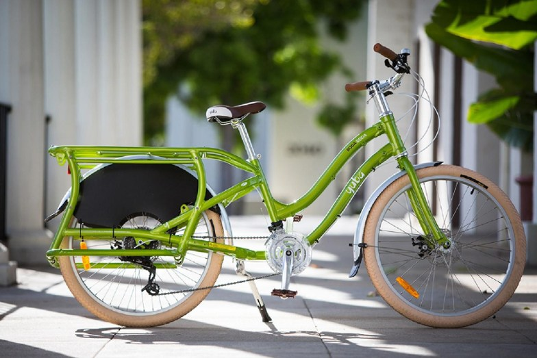

A used Boda Boda has a similar riding position geometry to a Dutch Bike. You would have plenty of room for gear and they are not all that heavy given their carrying capacity. A used non-electric one can be had for about $600. A new electric one is worth $3300 plus tax. That is the first class order of bike you will be riding.
