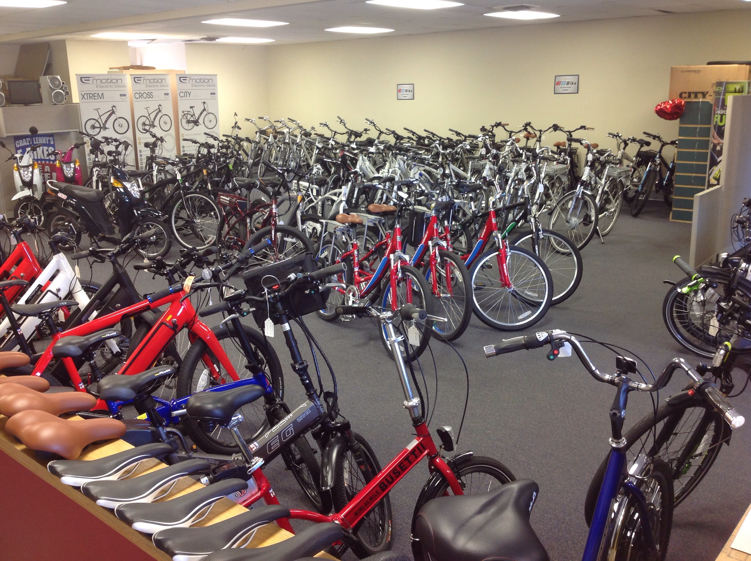

Yes. It has been discontinued and they're not bringing any more in. I would recommend either a 650b from this model year or next year if you need a bit more standover height (sub 5'7" can get a bit tight). We have a couple of 2014 650b's and they're on sale if you need. PM me if you're interested.
Surprisingly, Ebikes make excellent holiday gifts. We usually have closer to 50 different models but we've sold out of a few different models.
